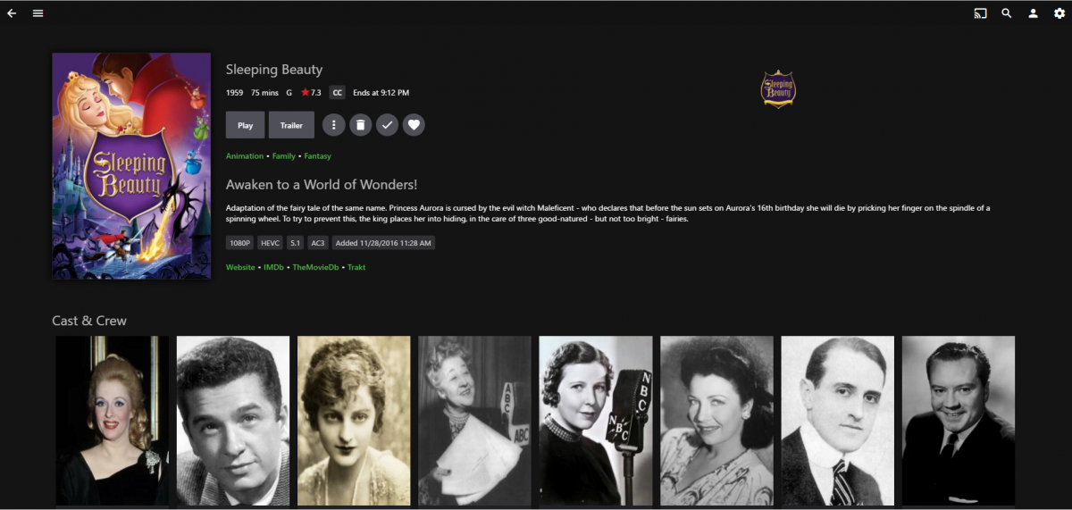

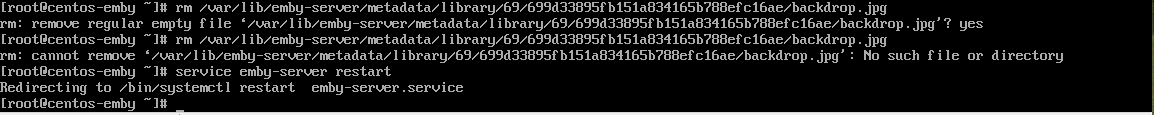

strugglez 8 Posted March 29, 2017 Author Posted March 29, 2017 (edited) Here is a screen shot of when the server crashes, and here is another of one after the server reboot. Cheers Edited March 29, 2017 by strugglez
Luke 40077 Posted March 29, 2017 Posted March 29, 2017 Try deleting this file /var/lib/emby-server/metadata/library/69/699d33895fb151a834165b788efc16ae/backdrop.jpg
strugglez 8 Posted March 29, 2017 Author Posted March 29, 2017 Okay, deleted that file, and now I tried searching another movie and it still happened, Here is the new log and associated screenshots. Cheers Log5.txt

Luke 40077 Posted March 29, 2017 Posted March 29, 2017 No, it looks like it's crashing trying to read 0-byte image files. Those files might have been saved that way due to a download failure and a previous version of the server incorrectly leaving them there. For the next release I will update the server to ignore these bad files altogether. Thanks !
