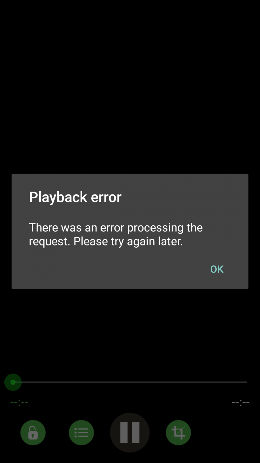

Playback error - apk:2.8.54 / server:3.2.1.0
Go to solution Solved by Luke,
Hi,
I will test, with apk version 2.8.64.
I have not exactly the same but very similar.
When I launch play, I have the black screen player (Screenshot_20170212-234224.png) and after some second the black screen only during the transcription of the video.
When the encoding finish i go to the select episode screen (Screenshot_20170212-234804.png) without action or error message.
Thanks for quick reply !

Just that video or with other videos too? Can you supply a sample avi for testing? thanks !
Hello,
I will make more test and this problem is only when the transcode is use .... (really sorry, not see before)

  • Solution
@@oohkarma. this file is playing just fine for me. after reviewing your logs again, the issue is the lack of media information in the emby database. Try opening up the video in the emby web app, then on the detail screen click the 3-dot menu, then click the Refresh button. Give it a few seconds then refresh the page. Notice this will populate media information at the bottom of the page.
Then try again from android.
  • Like 1
Hello,
You've got right !
After refresh, I don't have any problem !
Thank a lot :)
