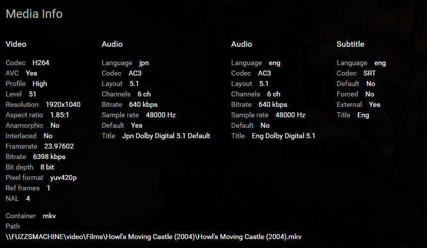

fuzzthekingoftrees 10 Posted February 3, 2017 Author Posted February 3, 2017 It seems that this happens when the chromecast tries to direct stream certain videos. Once this error has occured the chromecast needs to be rebooted before it will start playing successfully again. Here is the media info from a video that "broke" the chromecast
Luke 40154 Posted February 3, 2017 Posted February 3, 2017 Yea it's trying to direct play that title when it probably should be transcoding. To confirm I am correct, try dropping to your in-app chromecast bitrate setting to 5mbps. thanks.
fuzzthekingoftrees 10 Posted February 3, 2017 Author Posted February 3, 2017 Yeah, it plays fine then but only after I've rebooted the chromecast.
fuzzthekingoftrees 10 Posted April 17, 2017 Author Posted April 17, 2017 Is this on the list to be fixed? When I try to play videos that are level 5.1 the chromecast still tries to direct stream them when they need to be transcoded.
