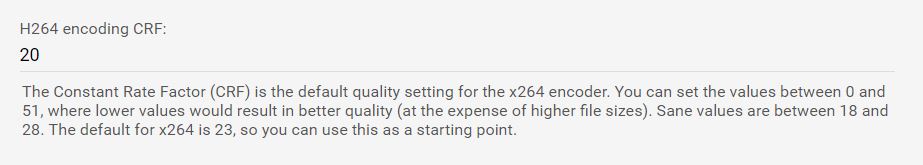

Luke 40105 Posted September 4, 2016 Posted September 4, 2016 Ok, for the next release, we will make crf and preset configurable on the transcoding settings page. 6
x-cimo 23 Posted September 9, 2016 Author Posted September 9, 2016 I can see you're on the ball; the fields are already in the beta; Thank you. Going back to the "Original quality" or, remux vs transcode. I am a C dev myself and decided to dig into it. I clearly was seeing transcoding, but like you said emby support remux only (copy video stream). In fact, I have cloned master, pointed it to the same media and stepped through the code, it ended up in the remux mode. I really don't why the release instance is doing transcode instead of remux knowing that: I am using the same browser I am using the same media I am using all the default setting in 60Mbps mode Remuxing: D:\ffmpeg\bin\ffmpeg.exe -fflags +genpts -i file:"\\FS\Movie.M2TS" -map 0:0 -map 0:1 -map -0:s -codec:v:0 copy -copyts -avoid_negative_ts disabled -start_at_zero -map_metadata -1 -threads 0 -codec:a:0 libmp3lame -ac 2 -ab 640000 -af "aresample=async=1,volume=2" -y "C:\Users\aa\Desktop\Emby-master\MediaBrowser.Server.Mono\bin\Debug\ProgramData-Server\transcoding-temp\0bb17e00e7a33e4aa973c8482e95f78b.mkv" Transcoding: D:\ffmpeg\20160410\ffmpeg.exe -fflags +genpts -i file:"\\FS\Movie.M2TS" -map 0:0 -map 0:1 -map -0:s -codec:v:0 libx264 -force_key_frames "expr:gte(t,n_forced*5)" -copyts -avoid_negative_ts disabled -start_at_zero -pix_fmt yuv420p -preset superfast -crf 23 -b:v 29701869 -maxrate 29701869 -bufsize 59403738 -vsync -1 -profile:v high -level 41 -map_metadata -1 -threads 0 -codec:a:0 libmp3lame -ac 2 -ab 640000 -af "aresample=async=1,volume=2" -y "C:\Users\Administrator\AppData\Roaming\Emby-Server\transcoding-temp\d3338298789bc1e038c020c35ad394b3.mkv" Let me know if you have some ideas Here is a diff of the json from both log: http://tlrobinson.net/projects/javascript-fun/jsondiff/#%7B%22d%22%3A%7B%22a%22%3A%22%7B%5C%22Protocol%5C%22%3A%5C%22File%5C%22%2C%5C%22Id%5C%22%3A%5C%22%5C%22%2C%5C%22Path%5C%22%3A%5C%22%5C%5C%5C%5C%5C%5C%5C%5CFS%5C%5C%5C%5CMovie.M2TS%5C%22%2C%5C%22Type%5C%22%3A%5C%22Default%5C%22%2C%5C%22Container%5C%22%3A%5C%22M2TS%5C%22%2C%5C%22Name%5C%22%3A%5C%221080P%2FH264%2FAC3%5C%22%2C%5C%22ETag%5C%22%3A%5C%223ee94bfc5890f076919b753165551a21%5C%22%2C%5C%22RunTimeTicks%5C%22%3A58338660000%2C%5C%22ReadAtNativeFramerate%5C%22%3Afalse%2C%5C%22SupportsTranscoding%5C%22%3Atrue%2C%5C%22SupportsDirectStream%5C%22%3Atrue%2C%5C%22SupportsDirectPlay%5C%22%3Atrue%2C%5C%22RequiresOpening%5C%22%3Afalse%2C%5C%22RequiresClosing%5C%22%3Afalse%2C%5C%22VideoType%5C%22%3A%5C%22VideoFile%5C%22%2C%5C%22MediaStreams%5C%22%3A%5B%7B%5C%22Codec%5C%22%3A%5C%22h264%5C%22%2C%5C%22CodecTag%5C%22%3A%5C%22HDMV%5C%22%2C%5C%22TimeBase%5C%22%3A%5C%221%2F90000%5C%22%2C%5C%22CodecTimeBase%5C%22%3A%5C%221001%2F48000%5C%22%2C%5C%22IsInterlaced%5C%22%3Afalse%2C%5C%22BitRate%5C%22%3A29701820%2C%5C%22IsDefault%5C%22%3Afalse%2C%5C%22IsForced%5C%22%3Afalse%2C%5C%22Height%5C%22%3A1080%2C%5C%22Width%5C%22%3A1920%2C%5C%22AverageFrameRate%5C%22%3A23.97602%2C%5C%22RealFrameRate%5C%22%3A23.97602%2C%5C%22Profile%5C%22%3A%5C%22High%5C%22%2C%5C%22Type%5C%22%3A%5C%22Video%5C%22%2C%5C%22AspectRatio%5C%22%3A%5C%2216%3A9%5C%22%2C%5C%22Index%5C%22%3A0%2C%5C%22IsExternal%5C%22%3Afalse%2C%5C%22IsTextSubtitleStream%5C%22%3Afalse%2C%5C%22SupportsExternalStream%5C%22%3Afalse%2C%5C%22PixelFormat%5C%22%3A%5C%22yuv420p%5C%22%2C%5C%22Level%5C%22%3A41%2C%5C%22IsAnamorphic%5C%22%3Afalse%7D%2C%7B%5C%22Codec%5C%22%3A%5C%22ac3%5C%22%2C%5C%22CodecTag%5C%22%3A%5C%22AC-3%5C%22%2C%5C%22Language%5C%22%3A%5C%22fra%5C%22%2C%5C%22TimeBase%5C%22%3A%5C%221%2F90000%5C%22%2C%5C%22CodecTimeBase%5C%22%3A%5C%221%2F48000%5C%22%2C%5C%22DisplayTitle%5C%22%3A%5C%22Fra%20Dolby%20Digital%206%20ch%5C%22%2C%5C%22IsInterlaced%5C%22%3Afalse%2C%5C%22BitRate%5C%22%3A640000%2C%5C%22Channels%5C%22%3A6%2C%5C%22SampleRate%5C%22%3A48000%2C%5C%22IsDefault%5C%22%3Afalse%2C%5C%22IsForced%5C%22%3Afalse%2C%5C%22Type%5C%22%3A%5C%22Audio%5C%22%2C%5C%22Index%5C%22%3A1%2C%5C%22IsExternal%5C%22%3Afalse%2C%5C%22IsTextSubtitleStream%5C%22%3Afalse%2C%5C%22SupportsExternalStream%5C%22%3Afalse%2C%5C%22Level%5C%22%3A0%7D%2C%7B%5C%22Codec%5C%22%3A%5C%22dca%5C%22%2C%5C%22Language%5C%22%3A%5C%22eng%5C%22%2C%5C%22TimeBase%5C%22%3A%5C%221%2F90000%5C%22%2C%5C%22CodecTimeBase%5C%22%3A%5C%221%2F48000%5C%22%2C%5C%22DisplayTitle%5C%22%3A%5C%22Eng%20DTS-HD%20MA%206%20ch%5C%22%2C%5C%22IsInterlaced%5C%22%3Afalse%2C%5C%22BitRate%5C%22%3A1536000%2C%5C%22Channels%5C%22%3A6%2C%5C%22SampleRate%5C%22%3A48000%2C%5C%22IsDefault%5C%22%3Afalse%2C%5C%22IsForced%5C%22%3Afalse%2C%5C%22Profile%5C%22%3A%5C%22DTS-HD%20MA%5C%22%2C%5C%22Type%5C%22%3A%5C%22Audio%5C%22%2C%5C%22Index%5C%22%3A2%2C%5C%22IsExternal%5C%22%3Afalse%2C%5C%22IsTextSubtitleStream%5C%22%3Afalse%2C%5C%22SupportsExternalStream%5C%22%3Afalse%2C%5C%22Level%5C%22%3A0%7D%2C%7B%5C%22Codec%5C%22%3A%5C%22pgssub%5C%22%2C%5C%22Language%5C%22%3A%5C%22fra%5C%22%2C%5C%22TimeBase%5C%22%3A%5C%221%2F90000%5C%22%2C%5C%22CodecTimeBase%5C%22%3A%5C%221%2F90000%5C%22%2C%5C%22DisplayTitle%5C%22%3A%5C%22Fra%5C%22%2C%5C%22IsInterlaced%5C%22%3Afalse%2C%5C%22IsDefault%5C%22%3Afalse%2C%5C%22IsForced%5C%22%3Afalse%2C%5C%22Type%5C%22%3A%5C%22Subtitle%5C%22%2C%5C%22Index%5C%22%3A3%2C%5C%22IsExternal%5C%22%3Afalse%2C%5C%22IsTextSubtitleStream%5C%22%3Afalse%2C%5C%22SupportsExternalStream%5C%22%3Afalse%2C%5C%22Level%5C%22%3A0%7D%2C%7B%5C%22Codec%5C%22%3A%5C%22pgssub%5C%22%2C%5C%22Language%5C%22%3A%5C%22fra%5C%22%2C%5C%22TimeBase%5C%22%3A%5C%221%2F90000%5C%22%2C%5C%22CodecTimeBase%5C%22%3A%5C%221%2F90000%5C%22%2C%5C%22DisplayTitle%5C%22%3A%5C%22Fra%5C%22%2C%5C%22IsInterlaced%5C%22%3Afalse%2C%5C%22IsDefault%5C%22%3Afalse%2C%5C%22IsForced%5C%22%3Afalse%2C%5C%22Type%5C%22%3A%5C%22Subtitle%5C%22%2C%5C%22Index%5C%22%3A4%2C%5C%22IsExternal%5C%22%3Afalse%2C%5C%22IsTextSubtitleStream%5C%22%3Afalse%2C%5C%22SupportsExternalStream%5C%22%3Afalse%2C%5C%22Level%5C%22%3A0%7D%2C%7B%5C%22Codec%5C%22%3A%5C%22pgssub%5C%22%2C%5C%22Language%5C%22%3A%5C%22eng%5C%22%2C%5C%22TimeBase%5C%22%3A%5C%221%2F90000%5C%22%2C%5C%22CodecTimeBase%5C%22%3A%5C%221%2F90000%5C%22%2C%5C%22DisplayTitle%5C%22%3A%5C%22Eng%5C%22%2C%5C%22IsInterlaced%5C%22%3Afalse%2C%5C%22IsDefault%5C%22%3Afalse%2C%5C%22IsForced%5C%22%3Afalse%2C%5C%22Type%5C%22%3A%5C%22Subtitle%5C%22%2C%5C%22Index%5C%22%3A5%2C%5C%22IsExternal%5C%22%3Afalse%2C%5C%22IsTextSubtitleStream%5C%22%3Afalse%2C%5C%22SupportsExternalStream%5C%22%3Afalse%2C%5C%22Level%5C%22%3A0%7D%2C%7B%5C%22Codec%5C%22%3A%5C%22pgssub%5C%22%2C%5C%22Language%5C%22%3A%5C%22eng%5C%22%2C%5C%22TimeBase%5C%22%3A%5C%221%2F90000%5C%22%2C%5C%22CodecTimeBase%5C%22%3A%5C%221%2F90000%5C%22%2C%5C%22DisplayTitle%5C%22%3A%5C%22Eng%5C%22%2C%5C%22IsInterlaced%5C%22%3Afalse%2C%5C%22IsDefault%5C%22%3Afalse%2C%5C%22IsForced%5C%22%3Afalse%2C%5C%22Type%5C%22%3A%5C%22Subtitle%5C%22%2C%5C%22Index%5C%22%3A6%2C%5C%22IsExternal%5C%22%3Afalse%2C%5C%22IsTextSubtitleStream%5C%22%3Afalse%2C%5C%22SupportsExternalStream%5C%22%3Afalse%2C%5C%22Level%5C%22%3A0%7D%5D%2C%5C%22PlayableStreamFileNames%5C%22%3A%5B%5D%2C%5C%22Formats%5C%22%3A%5B%5D%2C%5C%22Bitrate%5C%22%3A29701820%2C%5C%22RequiredHttpHeaders%5C%22%3A%7B%7D%7D%5Cn%22%2C%22b%22%3A%22%7B%5C%22Protocol%5C%22%3A%5C%22File%5C%22%2C%5C%22Id%5C%22%3A%5C%22e9b77c80dd0704837503231b083bea19%5C%22%2C%5C%22Path%5C%22%3A%5C%22%5C%5C%5C%5C%5C%5C%5C%5CFS%5C%5C%5C%5CMovie.M2TS%5C%22%2C%5C%22Type%5C%22%3A%5C%22Default%5C%22%2C%5C%22Container%5C%22%3A%5C%22M2TS%5C%22%2C%5C%22Name%5C%22%3A%5C%221080P%2FH264%2FAC3%5C%22%2C%5C%22ETag%5C%22%3A%5C%223ee94bfc5890f076919b753165551a21%5C%22%2C%5C%22RunTimeTicks%5C%22%3A58338560000%2C%5C%22ReadAtNativeFramerate%5C%22%3Afalse%2C%5C%22SupportsTranscoding%5C%22%3Atrue%2C%5C%22SupportsDirectStream%5C%22%3Atrue%2C%5C%22SupportsDirectPlay%5C%22%3Atrue%2C%5C%22RequiresOpening%5C%22%3Afalse%2C%5C%22RequiresClosing%5C%22%3Afalse%2C%5C%22VideoType%5C%22%3A%5C%22VideoFile%5C%22%2C%5C%22MediaStreams%5C%22%3A%5B%7B%5C%22Codec%5C%22%3A%5C%22h264%5C%22%2C%5C%22CodecTag%5C%22%3A%5C%22HDMV%5C%22%2C%5C%22TimeBase%5C%22%3A%5C%221%2F90000%5C%22%2C%5C%22CodecTimeBase%5C%22%3A%5C%221001%2F48000%5C%22%2C%5C%22NalLengthSize%5C%22%3A%5C%220%5C%22%2C%5C%22IsInterlaced%5C%22%3Afalse%2C%5C%22IsAVC%5C%22%3Afalse%2C%5C%22BitRate%5C%22%3A29701869%2C%5C%22BitDepth%5C%22%3A8%2C%5C%22RefFrames%5C%22%3A2%2C%5C%22IsDefault%5C%22%3Afalse%2C%5C%22IsForced%5C%22%3Afalse%2C%5C%22Height%5C%22%3A1080%2C%5C%22Width%5C%22%3A1920%2C%5C%22AverageFrameRate%5C%22%3A23.97602%2C%5C%22RealFrameRate%5C%22%3A23.97602%2C%5C%22Profile%5C%22%3A%5C%22High%5C%22%2C%5C%22Type%5C%22%3A%5C%22Video%5C%22%2C%5C%22AspectRatio%5C%22%3A%5C%2216%3A9%5C%22%2C%5C%22Index%5C%22%3A0%2C%5C%22IsExternal%5C%22%3Afalse%2C%5C%22IsTextSubtitleStream%5C%22%3Afalse%2C%5C%22SupportsExternalStream%5C%22%3Afalse%2C%5C%22PixelFormat%5C%22%3A%5C%22yuv420p%5C%22%2C%5C%22Level%5C%22%3A41%2C%5C%22IsAnamorphic%5C%22%3Afalse%7D%2C%7B%5C%22Codec%5C%22%3A%5C%22ac3%5C%22%2C%5C%22CodecTag%5C%22%3A%5C%22AC-3%5C%22%2C%5C%22Language%5C%22%3A%5C%22fra%5C%22%2C%5C%22TimeBase%5C%22%3A%5C%221%2F90000%5C%22%2C%5C%22CodecTimeBase%5C%22%3A%5C%221%2F48000%5C%22%2C%5C%22DisplayTitle%5C%22%3A%5C%22Fra%20Dolby%20Digital%205.1%5C%22%2C%5C%22IsInterlaced%5C%22%3Afalse%2C%5C%22ChannelLayout%5C%22%3A%5C%225.1%5C%22%2C%5C%22BitRate%5C%22%3A640000%2C%5C%22Channels%5C%22%3A6%2C%5C%22SampleRate%5C%22%3A48000%2C%5C%22IsDefault%5C%22%3Afalse%2C%5C%22IsForced%5C%22%3Afalse%2C%5C%22Type%5C%22%3A%5C%22Audio%5C%22%2C%5C%22Index%5C%22%3A1%2C%5C%22IsExternal%5C%22%3Afalse%2C%5C%22IsTextSubtitleStream%5C%22%3Afalse%2C%5C%22SupportsExternalStream%5C%22%3Afalse%2C%5C%22Level%5C%22%3A0%7D%2C%7B%5C%22Codec%5C%22%3A%5C%22dca%5C%22%2C%5C%22Language%5C%22%3A%5C%22eng%5C%22%2C%5C%22TimeBase%5C%22%3A%5C%221%2F90000%5C%22%2C%5C%22CodecTimeBase%5C%22%3A%5C%221%2F48000%5C%22%2C%5C%22DisplayTitle%5C%22%3A%5C%22Eng%20DTS-HD%20MA%207.1%5C%22%2C%5C%22IsInterlaced%5C%22%3Afalse%2C%5C%22ChannelLayout%5C%22%3A%5C%227.1%5C%22%2C%5C%22BitDepth%5C%22%3A24%2C%5C%22Channels%5C%22%3A8%2C%5C%22SampleRate%5C%22%3A48000%2C%5C%22IsDefault%5C%22%3Afalse%2C%5C%22IsForced%5C%22%3Afalse%2C%5C%22Profile%5C%22%3A%5C%22DTS-HD%20MA%5C%22%2C%5C%22Type%5C%22%3A%5C%22Audio%5C%22%2C%5C%22Index%5C%22%3A2%2C%5C%22IsExternal%5C%22%3Afalse%2C%5C%22IsTextSubtitleStream%5C%22%3Afalse%2C%5C%22SupportsExternalStream%5C%22%3Afalse%2C%5C%22Level%5C%22%3A0%7D%2C%7B%5C%22Codec%5C%22%3A%5C%22pgssub%5C%22%2C%5C%22Language%5C%22%3A%5C%22fra%5C%22%2C%5C%22TimeBase%5C%22%3A%5C%221%2F90000%5C%22%2C%5C%22CodecTimeBase%5C%22%3A%5C%221%2F90000%5C%22%2C%5C%22DisplayTitle%5C%22%3A%5C%22Fra%5C%22%2C%5C%22IsInterlaced%5C%22%3Afalse%2C%5C%22IsDefault%5C%22%3Afalse%2C%5C%22IsForced%5C%22%3Afalse%2C%5C%22Type%5C%22%3A%5C%22Subtitle%5C%22%2C%5C%22Index%5C%22%3A3%2C%5C%22IsExternal%5C%22%3Afalse%2C%5C%22IsTextSubtitleStream%5C%22%3Afalse%2C%5C%22SupportsExternalStream%5C%22%3Afalse%2C%5C%22Level%5C%22%3A0%7D%2C%7B%5C%22Codec%5C%22%3A%5C%22pgssub%5C%22%2C%5C%22Language%5C%22%3A%5C%22fra%5C%22%2C%5C%22TimeBase%5C%22%3A%5C%221%2F90000%5C%22%2C%5C%22CodecTimeBase%5C%22%3A%5C%221%2F90000%5C%22%2C%5C%22DisplayTitle%5C%22%3A%5C%22Fra%5C%22%2C%5C%22IsInterlaced%5C%22%3Afalse%2C%5C%22IsDefault%5C%22%3Afalse%2C%5C%22IsForced%5C%22%3Afalse%2C%5C%22Type%5C%22%3A%5C%22Subtitle%5C%22%2C%5C%22Index%5C%22%3A4%2C%5C%22IsExternal%5C%22%3Afalse%2C%5C%22IsTextSubtitleStream%5C%22%3Afalse%2C%5C%22SupportsExternalStream%5C%22%3Afalse%2C%5C%22Level%5C%22%3A0%7D%2C%7B%5C%22Codec%5C%22%3A%5C%22pgssub%5C%22%2C%5C%22Language%5C%22%3A%5C%22eng%5C%22%2C%5C%22TimeBase%5C%22%3A%5C%221%2F90000%5C%22%2C%5C%22CodecTimeBase%5C%22%3A%5C%221%2F90000%5C%22%2C%5C%22DisplayTitle%5C%22%3A%5C%22Eng%5C%22%2C%5C%22IsInterlaced%5C%22%3Afalse%2C%5C%22IsDefault%5C%22%3Afalse%2C%5C%22IsForced%5C%22%3Afalse%2C%5C%22Type%5C%22%3A%5C%22Subtitle%5C%22%2C%5C%22Index%5C%22%3A5%2C%5C%22IsExternal%5C%22%3Afalse%2C%5C%22IsTextSubtitleStream%5C%22%3Afalse%2C%5C%22SupportsExternalStream%5C%22%3Afalse%2C%5C%22Level%5C%22%3A0%7D%2C%7B%5C%22Codec%5C%22%3A%5C%22pgssub%5C%22%2C%5C%22Language%5C%22%3A%5C%22eng%5C%22%2C%5C%22TimeBase%5C%22%3A%5C%221%2F90000%5C%22%2C%5C%22CodecTimeBase%5C%22%3A%5C%221%2F90000%5C%22%2C%5C%22DisplayTitle%5C%22%3A%5C%22Eng%5C%22%2C%5C%22IsInterlaced%5C%22%3Afalse%2C%5C%22IsDefault%5C%22%3Afalse%2C%5C%22IsForced%5C%22%3Afalse%2C%5C%22Type%5C%22%3A%5C%22Subtitle%5C%22%2C%5C%22Index%5C%22%3A6%2C%5C%22IsExternal%5C%22%3Afalse%2C%5C%22IsTextSubtitleStream%5C%22%3Afalse%2C%5C%22SupportsExternalStream%5C%22%3Afalse%2C%5C%22Level%5C%22%3A0%7D%5D%2C%5C%22PlayableStreamFileNames%5C%22%3A%5B%5D%2C%5C%22Formats%5C%22%3A%5B%5D%2C%5C%22Bitrate%5C%22%3A29701869%2C%5C%22RequiredHttpHeaders%5C%22%3A%7B%7D%7D%22%7D%7D

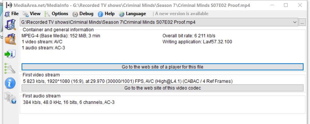

Guest asrequested Posted September 10, 2016 Posted September 10, 2016 (edited) Are these settings supposed to apply to records, too? Because I've just tested two recordings, one with CRF at 40 and one with CRF 18, encoding set to fast and QS enabled. There was no difference in the recordings. File size remained the same, pretty much uncompressed. I'll test with QS disabled, and see if that makes a difference. Update: Here's the info for a show I recorded with the CRF 18, encoding fast and hardware acceleration set to none. I believe the bitrate should be much lower, right? Changing the CRF to 51 raised the bitrate Update 2: Set CRF to 1.... No change. Changing from fast to superfast also yields nothing. So either it isn't working or it only works for streaming. Edited September 10, 2016 by Doofus
x-cimo 23 Posted September 11, 2016 Author Posted September 11, 2016 I could be wrong about that but I would not expect the bitrate or size to change much. What change is the quality of the encoding. However by looking at the transcode log at the ffmpeg command you should see the preset change accoeding to what you choose. If they are not changing something is not working for post transcoding.
Guest asrequested Posted September 11, 2016 Posted September 11, 2016 (edited) I could be wrong about that but I would not expect the bitrate or size to change much. What change is the quality of the encoding. However by looking at the transcode log at the ffmpeg command you should see the preset change accoeding to what you choose. If they are not changing something is not working for post transcoding. No matter what I did, the quality and size didn't change at all. With the original settings the file size was half of the original. Now it's back at that same level. That is to say it's not compressed at all, and there should be compression. That is the purpose of using the h264 codec. The compression is the only reason I have it set to convert to MP4. Edited September 11, 2016 by Doofus
puithove 209 Posted September 11, 2016 Posted September 11, 2016 (edited) It doesn't seem to be using these configurable params for the recording conversion. I think @@Luke would need to add that. You can see the ffmpeg commandline used in the logs. Here is the commandline from a test recording after I changed the params. No difference: /usr/bin/ffmpeg -fflags +genpts -async 1 -vsync -1 -re -i "/tmp-disk/emby/transcoding-temp/8c09d62a499e44b89b509bae38454c18.ts" -t 01:25:11.732 -sn -codec:v:0 libx264 -force_key_frames "expr:gte(t,n_forced*5)" -vf "yadif=0:-1:0" -pix_fmt yuv420p -preset superfast -crf 23 -b:v 25000000 -maxrate 25000000 -bufsize (25000000*2) -vsync -1 -profile:v high -level 41 -map_metadata -1 -threads 0 -codec:a:0 aac -strict experimental -ab 320000 -y "/share/media-pub/recordings/emby/Weather Center Live/Weather Center Live 2001-10-14.mkv" Edited September 11, 2016 by puithove
