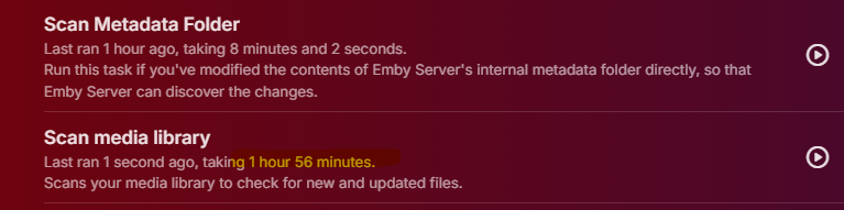

Recently Library scan is taking 40 mins before it was faster,
is there anything i can do to speedup the library faster.

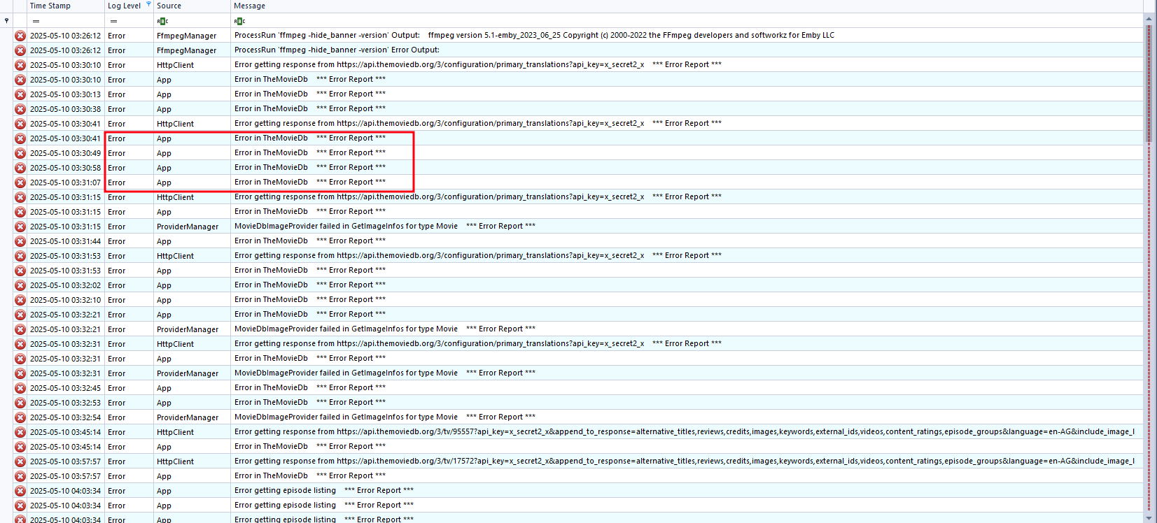

It looks like TheMovieDB is timing out.
It might be a TheMovieDB issue that needs to be fixed by TheMovieDB.
Timeouts like these will give you longer scan times.

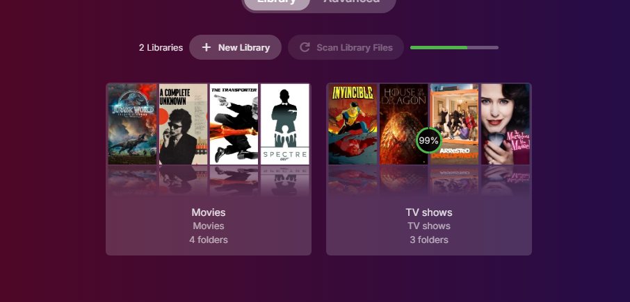

its happening to mostly for the TV shows part instead of Movies and im stuck here for 2hrs

It also looks like you have issues with your google drive, that will also add to prolonged scan times.
ProcessRun 'quick-extract-image' Error Output:    ffmpeg version 5.1-emby_2023_06_25 Copyright (c) 2000-2022 the FFmpeg developers and softworkz for Emby LLC

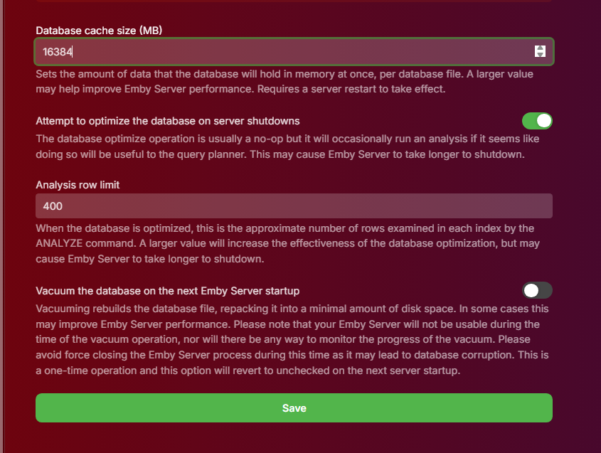

Can it be cause my database cache size is limited to 16Gigs.
also can anyone clear me if database cache is gonna be in terms of storage or RAM
Neminem
I do not thing those settings will help you with all the errors in your logs.
Look through you logs in a text editor, and solve 1 at a time.

Thanks most part it s showing movie db socket error somekind
Neminem
Yes and I think Emby is waiting to get the timeout before trying again.
That will lead to a lot of timeouts and longer scan times.
So you will need to fix the socket errors and SSL errors you have in your logs.
I don't see these errors in my logs, so that rules out metadata end points.
So I guess its local to your system.
Be it Router / Firewall / DNS / ISP or something is blocking it.

Repeatedly im seeing only TheMovieDB socket Error is there any fix for that
