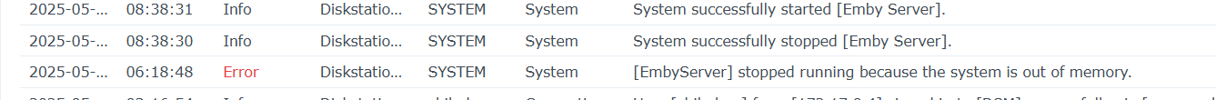

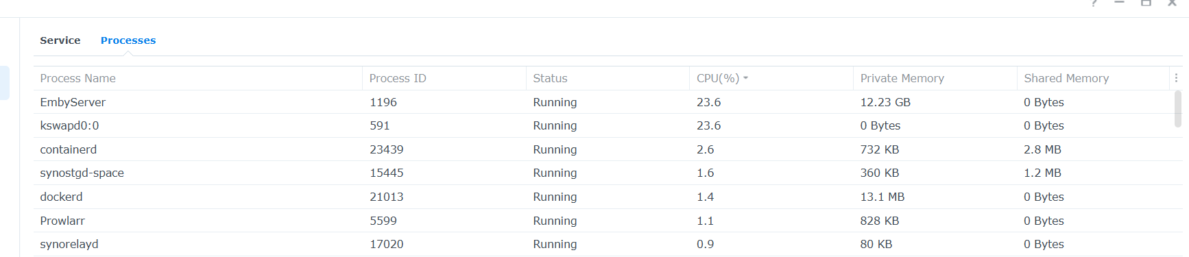

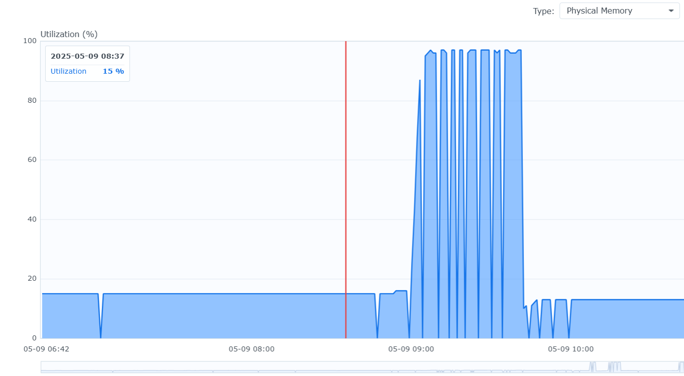

Recently have had EmbyServer on Synology NAS crashing, and on checking, it's using all Private memory - started a couple of days ago.  It's not immediate, but jumps after a period (say overnight).  Only way to recover is to kill the task when I notice.
Not sure if it's connected, but recently installed Prowlarr (first ever install), and updated versions of Sonarr and Radarr to the Synology packages (previously were installed from ghrc.io). I assume I need to share logs, but not sure where to get them

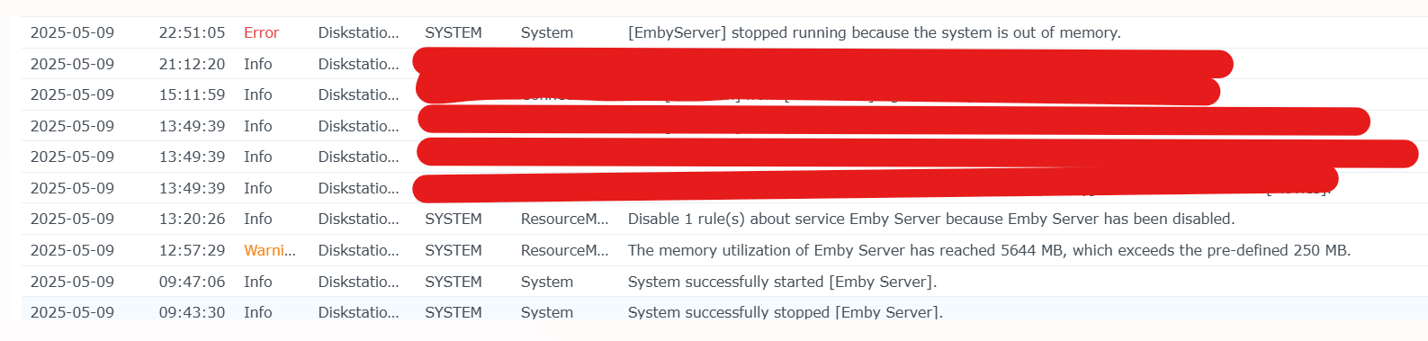

image.thumb.png.3f7c6b705b392fd304ecab721cab5aad.pngIt crashed again - will try to grab the logs
Chiholam

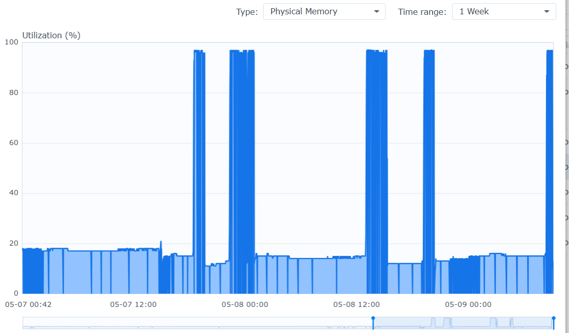

Logs fo the session 9:47 befembyserver-63882433952.txtore it crashed at 22:51. Also attached the memory chart , looks like it started spiking in memory utilisation aroudn 21:43image.thumb.png.e39d3a927bb4e059a3c3d1c04cf6ece7.png

Also, earlier in the morning, I spotted it spiking in memory (the initial post) and here's the log from that session prior to stopping it.image.thumb.png.375fc8baec25f5a99822847f9465c7a6.pngembyserver-63882380605.txt

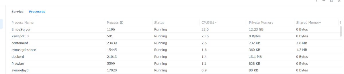

Went into emby to see if there was a transcoding log, and spotted massive spike in mem use again - snapshot of Task Manager enclosed in case it helps.  Note, this was before I went into Emby, just opened up Synology and saw ResMonitor RAM at 97%.  There's no ffmpeglog.  This was p robably the shortest time after starting when it did this.  Attached logs for this one in case it's easier to find something.embyserver-63882435213.txtimage.thumb.png.f8e772dba46dfc2cf979c803e8c112ee.png
