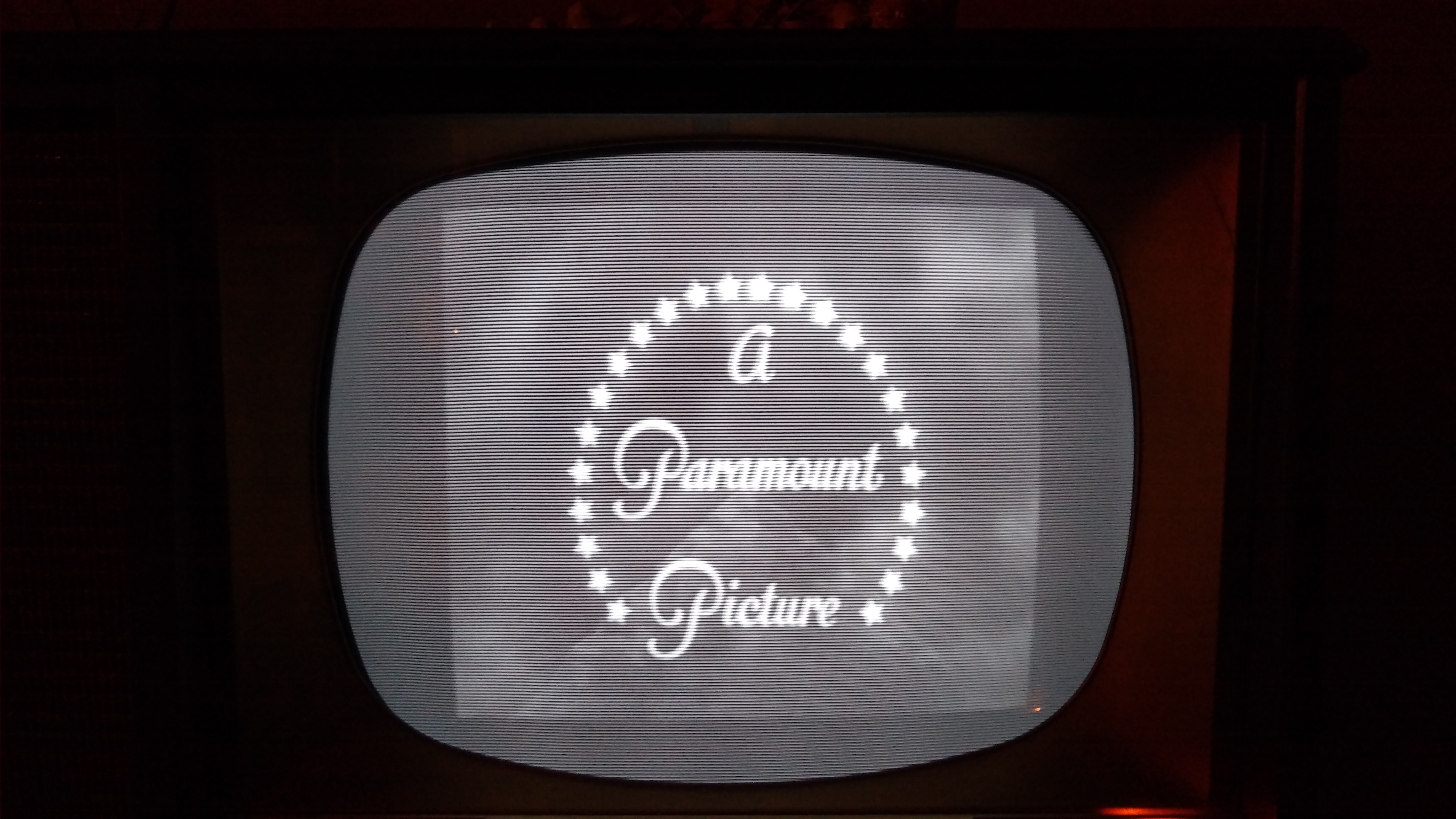

TheShanMan 38 Posted May 8 Posted May 8 In the attached image you can see that Emby is adding black bars on all sides of my 4x3 content on my 4x3 TV. The content itself has no black bars on any side. This displays fine on Theater. Therefore it doesn't seem to be a server issue. Is there an app setting that would fix this or is this a bug?

softworkz 4574 Posted May 9 Posted May 9 This image is confusing me. How does it look like when the app is maximized (not full-screen)?
TheShanMan 38 Posted May 9 Author Posted May 9 I don't know. When in browsing mode (not playing a vid), it appears to be full screen, but keep in mind this is an analog CRT so the edges are cut off, which means I can't see title bars or whatever. Finally grabbed the log files. The server log was quite large so I trimmed the irrelevant stuff. In case you want a little context with my setup... I have this set up as a 2nd monitor on my htpc for when I want to watch black and white tv shows and black and white 4x3 movies on it. So Emby normally runs on my big flat screen, and then my remote can disable one monitor, enable the other, and restart emby there. EmbyClient-20250507T215819378.txt embyserverx.txt mpv-20250507T211125589.txt
softworkz 4574 Posted May 9 Posted May 9 When you put the app in windowed mode on the big flat screen, resize it to an approximate 4:3 size and play that video, what happens - how does it look like?
TheShanMan 38 Posted May 9 Author Posted May 9 It fills the window correctly. Forgot to mention that some of my 4:3 videos have this problem and some don't. And to reiterate from my original post, this doesn't happen with Theater.
softworkz 4574 Posted May 9 Posted May 9 When you make the window small and move it to the 4:3 TV, then hit the "Maximize" button at the right top (NOT Fullscreen) - what happens then? And then what happens when you go into full-screen (by F11 key or OSD)?
TheShanMan 38 Posted May 10 Author Posted May 10 When I move it and then maximize, the bars appear. And switching to full screen also has the bars.
softworkz 4574 Posted May 11 Posted May 11 I think the issue is that hw acceleration doesn't work for this video output. Can you please try to set the video quality preference back to the default (Balanced)?
