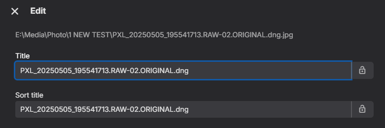

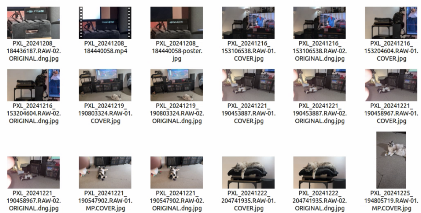

See photo.  Google is exporting as jpg,  but appending original photo format and camera mode  as name.format.Original format.filetype  Emby seems to be having an issue with it and will not display files with additional appended information withe the . separator.
To be clear, these show up in the library display, but will not display full size.
image.thumb.png.73008472750bfc61c315370860fb65d4.png,  Google is appending

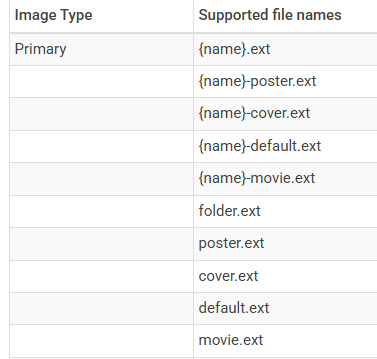

I can potentially see an issue with any image the has Poster or Cover in its name as having issues and those could be media primary images.

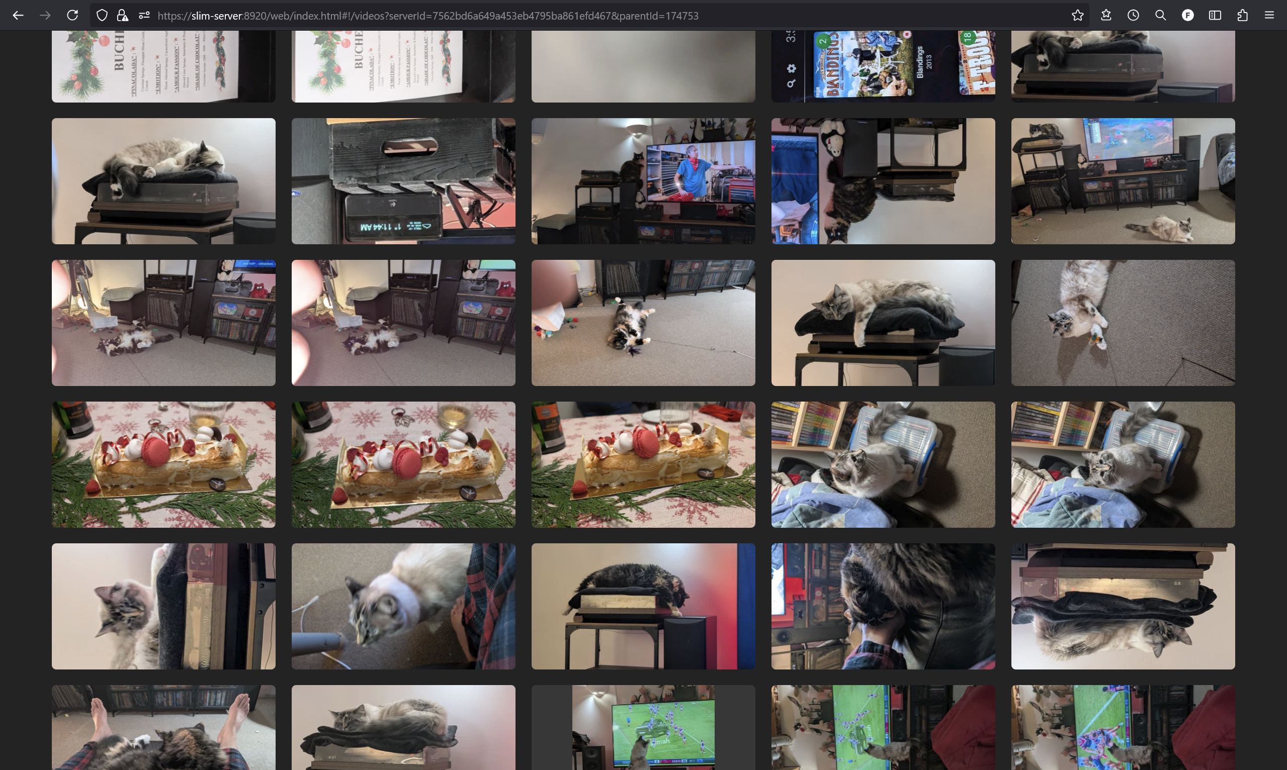

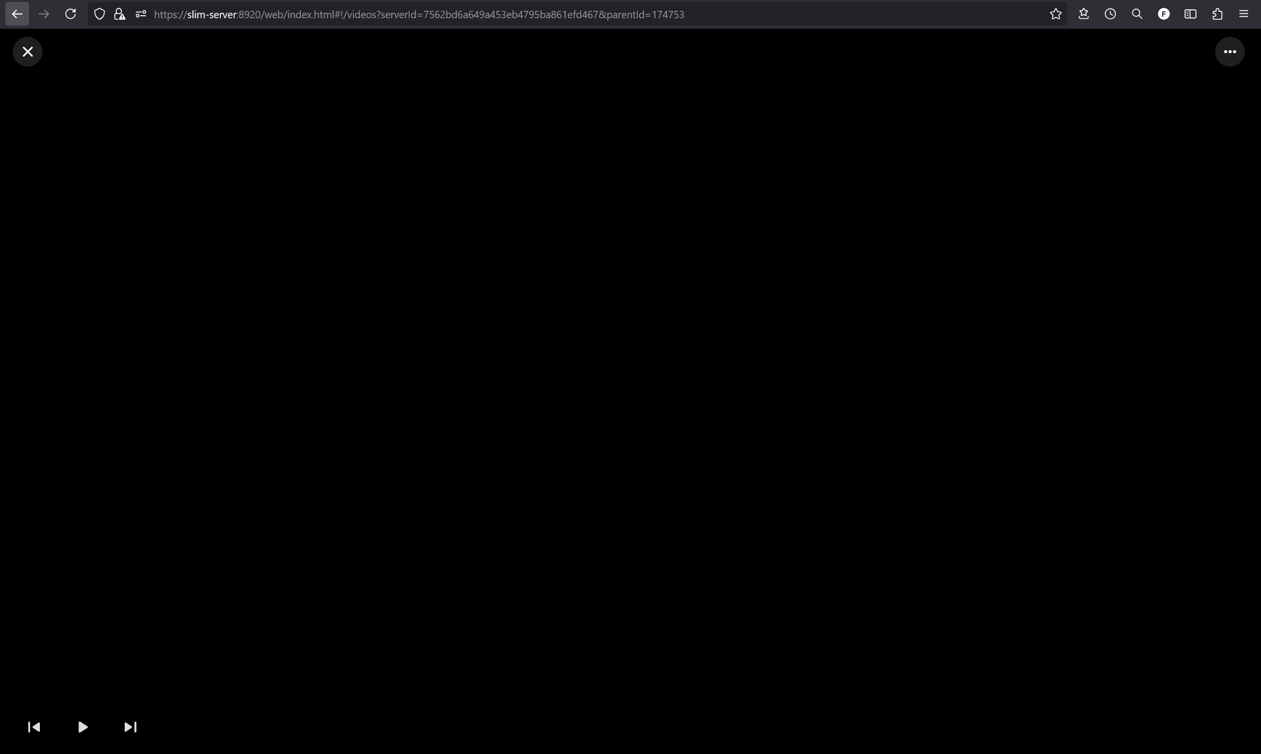

The thumbnail page is populated.  But when I go to view them, there is just a blank page instead of a full size image.
I exported a photo from google as a jpg the other day and emby exported that as a jpg only a day later.  That file shows as a thumb and full image.

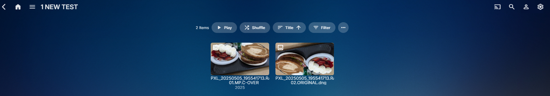

Roughly the same photo set as first post
PXL_20241216_153204604.RAW-02.ORIGINAL.dng

BTW, the file is being named as filename.camera mode.dng.jpg.  Why the DNG is there I don't know apart from the fact they are being stored in both formats and yet just the jpg is downloaded.

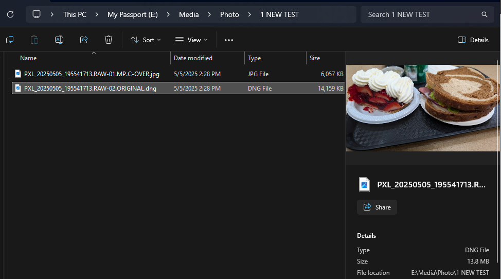

They are EXCEPT,  there are seperate JPG and DNG files on the device.

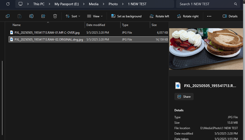

....and it appears download is attempting to download both files but somewhere along the way the dng is getting turned into a jpg - which appends the type to the file.
From Today....  (had to zip the files because forum refused to upload the .dng file.)
Photo shop seems to see the files as jpg as well.   Is it possible to discard the .dnf.jpg files?  or redirect them?
PXL_20250505_195541713.RAW-02.ORIGINAL.dng.zip

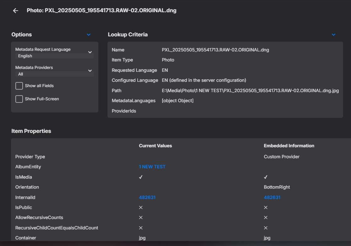

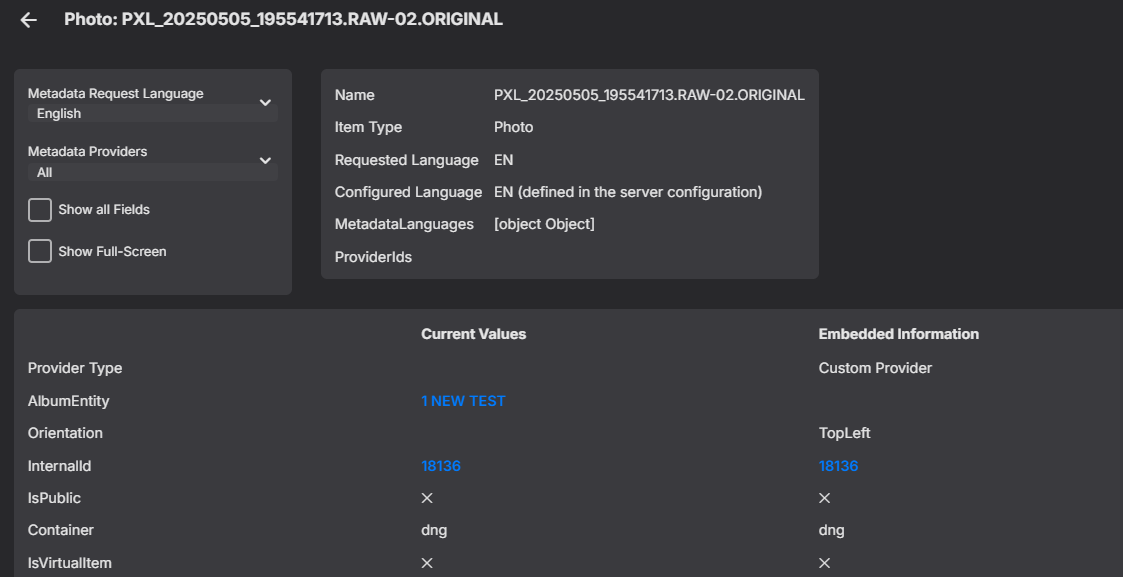

In my test of that zip original displayed upside down in 4.8.0.11 and cover did not display until I renamed as cover is part of Emby Primary image detections as listed above.
both are jpgs as extentions are removed so naming scheme is decieving as it is not a dng.
Note rotation issue is resolved in 4.9.0.x beta
removing the false jpg extention shows dng file

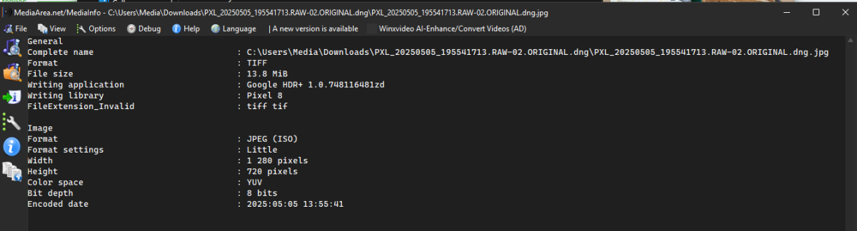

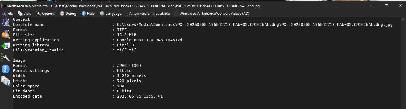

Have you looked at each file with Mediainfo?  There is a difference.
Happy2Play
What do you mean?
Here is the fake jpg.
  • Thanks 1

Which is interesting as Photoshop says the .dng.jpg file is an HDR JPG file.  So if you have an hdr display and interpreter it displays as HDR, which it does.
Named with just the .jpg extension the file, Windows and Linux default photo viewers open both files no problem, which should also be normal because it should open as a JPG if HDR is not available.
New to me,  and to Mediainfo that says its a Tiff and then says it's an HDR JPG.
