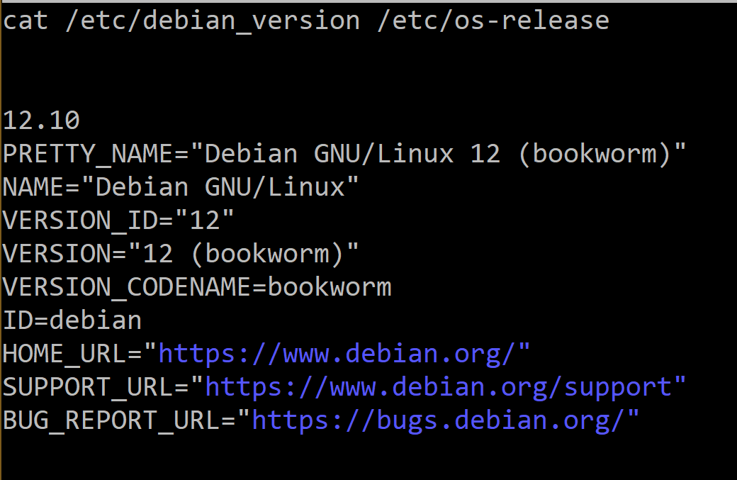

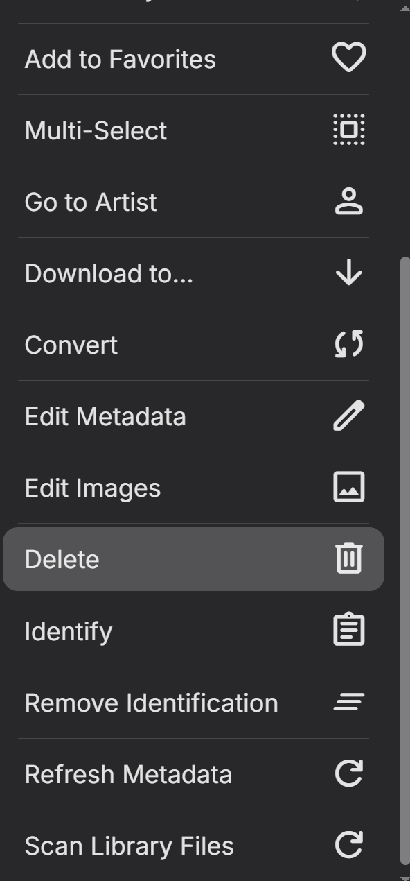

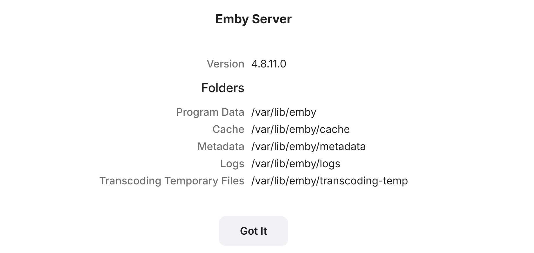

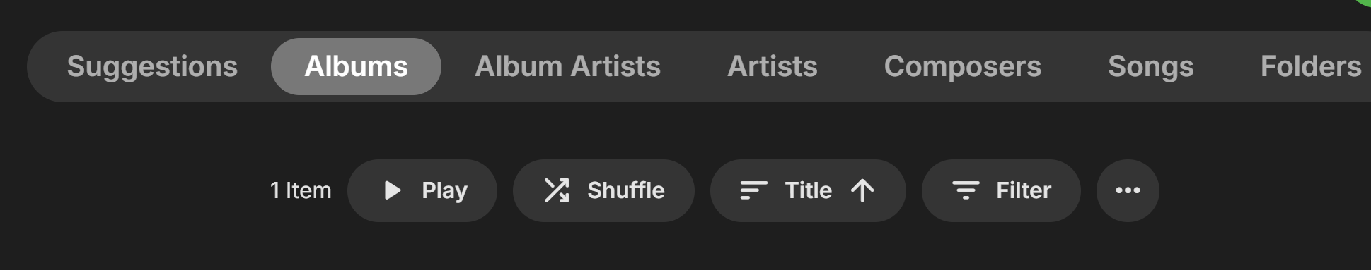

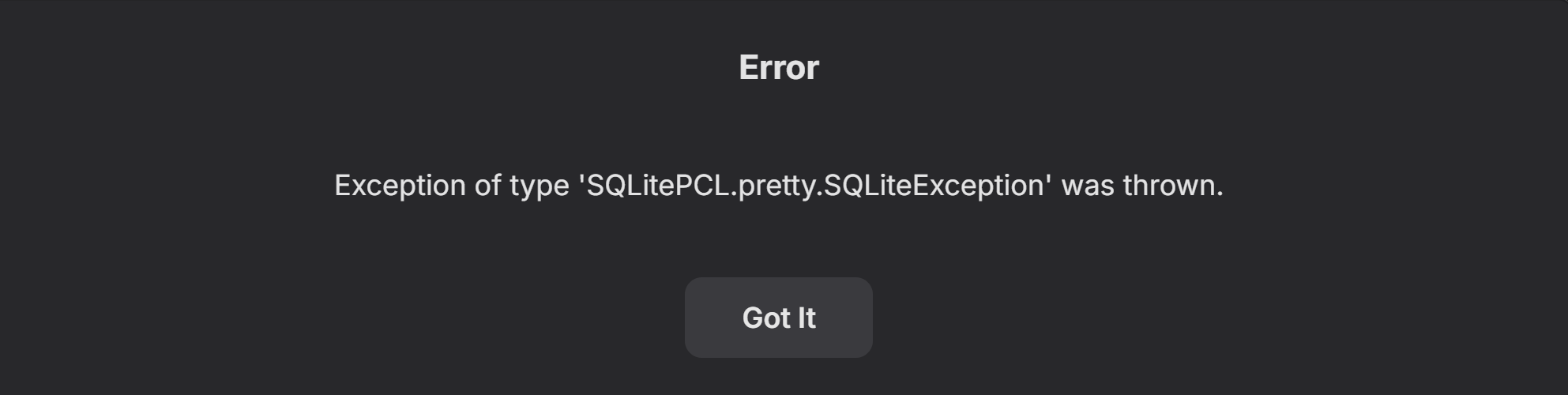

DBee25 1 Posted April 28 Posted April 28 I am running into an issue deleting albums from Emby. Each time SQLite throws an ''SQLitePCL.pretty.SQLiteException: Constraint: FOREIGN KEY constraint failed' error. The problem is reproduceable. I installed Emby on a (fresh installation of) Debian 12. Steps to reproduce: - Create a new library of content type 'Music' Use a local folder (i.e. /emby/music) chown emby:emby /emby/music. All other options default - Upload an album (and fix permissions), wait for it to be added to the library - In a browser, select the library and select 'Albums' - Select the album, select 'Delete' in the popup menu - A popup window containing the SQLite error appears, resulting in the album not being deleted. The problem only occurs when you try to delete an album. Dleting items from other menu items works as expected. The album is removed automatically though when you remove the entire folder. From the looks of it seems to be a database problem and I hope this can be looked into. embyserver.txt
