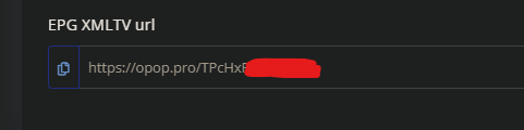

Valdorama 1 Posted April 21 Author Posted April 21 It's the URL provided by IPTVEditor: It works in other applications (e.g. Channels DVR), and when I enter that URL in my browser, it downloads the gzip file (attached in the original post). The gzip does contain valid XML.
