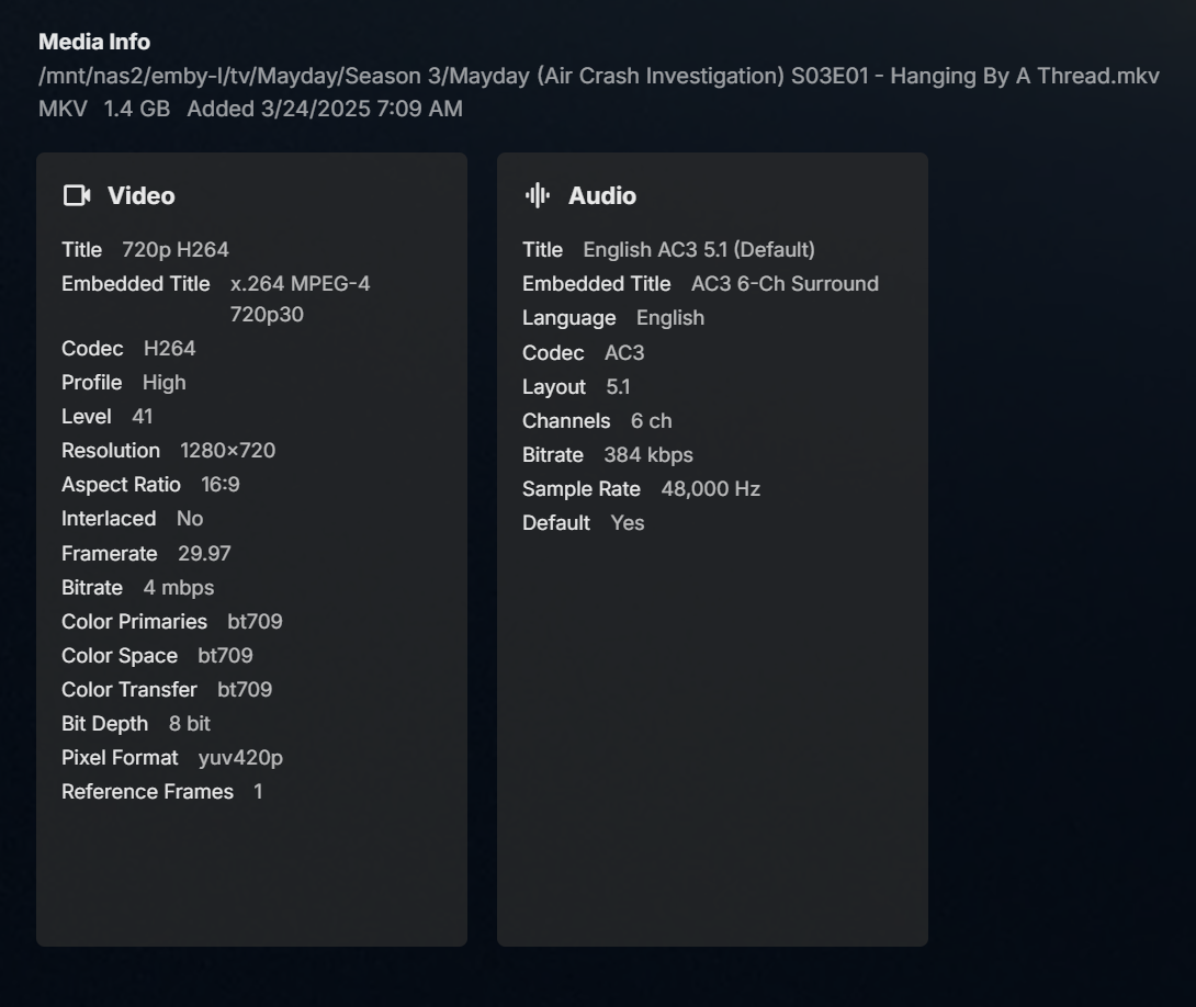

Pitchblack 36 Posted April 22 Author Posted April 22 Hi, This has always been an issue ever since I started using Emby with that specific TV. The behaviour was the same with any version of emby server I tried and samsung client version. I just tested a new video (H264 video codec and AC3 audio codec and no subtitles), I got the same issue. Here's the media info: I'm also attaching the logs to the post. I have tested from 20:29 eastern time (01:29 UTC) to 20:32 eastern time (01:32 UTC). And for the last question, for this TV, the server is Remote, but there's no remote issues for my Phone or from the Web Client, only this TV. Regards, Pitchblack embyserver.txt

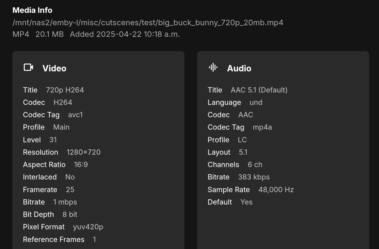

visproduction 286 Posted April 22 Posted April 22 (edited) Suspect your media has issues and / or the video bitrate combined with the AC3 audio and possible VBR video encoding (not advised) causing buffering on fast forward. Try a demo video 20 MB 720P from this page and see if it works. https://sample-videos.com/ Direct link: https://sample-videos.com/video321/mp4/720/big_buck_bunny_720p_20mb.mp4 Edited April 22 by visproduction 1

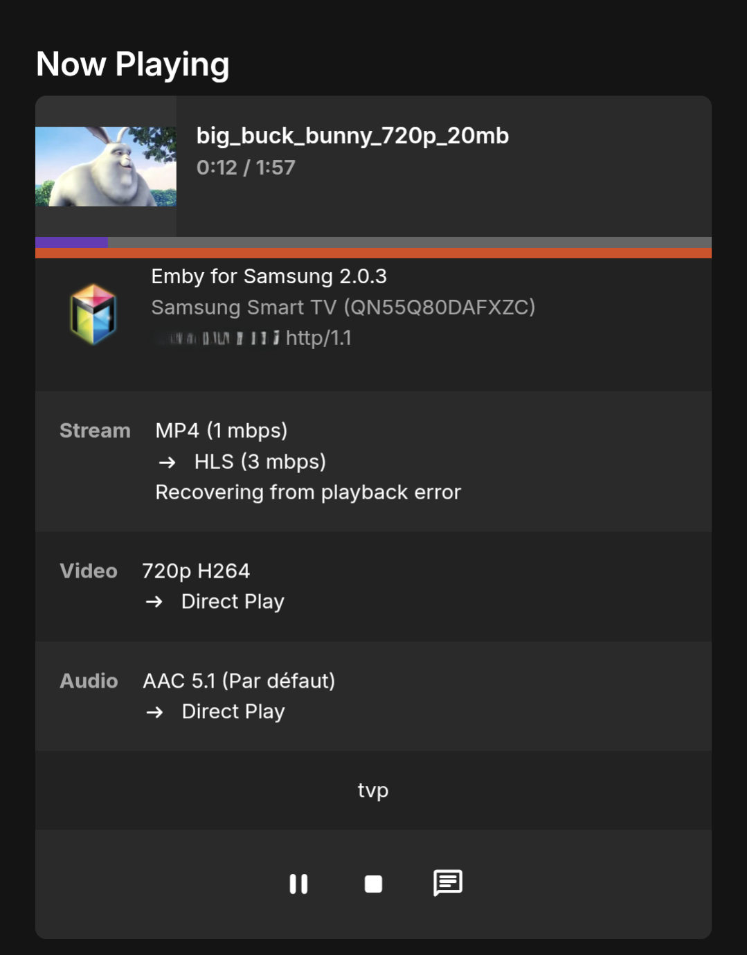

Pitchblack 36 Posted April 22 Author Posted April 22 Hi, So I added the file visproduction linked and played it on the TV and the TV returned a playback error but according to "Now Playing" in the admin dashboard, the TV recovered from the error and was playing the file. It was as follows: Seems to recover but not sure how you can both direct play and transcode (Orange bar) at the same time? Strangely enough (or not), after recovering from that playback error and in that state, seeking forward and backward works... I assume that the client requested the server to transcode the file into a native video for the TV and that's why it works well like that.. but still not clear to me why it wouldn't work on previous tests if file were Direct Playing... doesn't "Direct Play" mean that the client's hardware has native support for what the server is sending? Media Info of the example file I'm also adding the emby server logs again and the ffmpeg logs (transcode logs I guess). The test was done at 10:34 eastern time or 15:34 UTC. Regards, Pitchblack embyserver.txt ffmpeg-directstream-7b7f93b6-f301-4c7b-859c-c49e60696d5f_1.txt 1
visproduction 286 Posted April 22 Posted April 22 PB, Not sure what happened. Perhaps someone can read the embyserver.txt log better. Since you said Forward works on the demo, I think the combo of the TV playback plus the encoded Video and audio bitrates and whatever issues the earlier larger media had, was perhaps the problem. With a high bitrate on the video and possibly VBR (Variable bit rate) encoding, the TV just doesn't want to handle this higher res and heavily encoded video to let you use fast forward. I really don't think this is very surprising. Media that is encoded by someone using some automated software / hardware that tries to compress and may have some other issues, is just not a proper media version that can be used on all gear. Encoding for streaming playback on TV apps or browsers is very tricky to get everything correct. If you start with a media file that has issues, it might play back fine on a 3rd party player which allows timeline problems or VBR issues, but TV Apps and browsers are much more limiting. Then you have a situation when the playback has a problem and emby senses it and triggers a transcoding to make a copy that the TV app can like. That might work, but as soon as you run into a timeline metadata glitch or a very high bitrate and AC3 audio encoding for surround, which has many versions of EC3 and Dolby that don't always appear labled correctly and need to be encoded or cause a direct playback issue, or has to be cached and handled by the TV App. It can easily be a mess and the media file looks OK and plays back elsewhere, so everyone thinks it's fine, when it isn't. If your large media files are properly encoded without errors and kept below whatever bitrate your system can handle, they will probably play back fine and everything will work. I pre encode everything to h.264 MPEG-4 AVC (part 10) avc1 and Audio AAC mp4a run it through mp4box to clean up any issues and everything I have in 1080P or 4K plays on several TV types with fast forward options, play pause and everything in sync. I think your original source media is probably the issue. That is my guess. Let's see if anyone else can break down something that will work based on the test.

SamES 1004 Posted April 23 Posted April 23 11 hours ago, Pitchblack said: Hi, I completely uninstalled Emby from the TV, then unplugged the TV for a few minutes, then reinstalled Emby using the USB key (v2.0.3) and then tested again with the same issue. Most of my files are actually MKV files with either H264, HEVC or AV1 video codecs and most have AAC, AC3 or OPUS audio... which are pretty ?much all don't require transcoding since they direct play... but what's the difference from MP4 there? I've seen that issue on a MKV file as well when watching anime. Not sure how you want me to DM you the files as they're pretty big... I guess I could 7zip them in multiple parts and send links to you. Definitely no issues playing the one mkv file on my older Samsung TV, I will try and test on my other TV tomorrow, but I expect it will be fine. Are you using the original Samsung remote control or are you using a generic or programable remote? 1
Pitchblack 36 Posted April 23 Author Posted April 23 Hi, I did some more tests and these are the behaviours I noticed: Any MKV file starts immediately when pressing the "play" button and they play natively "Direct Play"... but I'm unable to seek anywhere in the video... loading wheel of death. If I go to the video menu and press the "attempt playback correction", the video starts being transcoded (although the transcoding orange bar is immediately entirely filled up like it's already fully transcoded) and the file plays nicely and even the seeking works correctly... weird.. Even weirder, when I actually play a MP4 file... the most basic H264 video and AAC or AC3 audio... it takes an eternity for the file to load and when it starts playing it either gives a playback error message or not and in either case it starts transcoding... and since it's transcoding, the playback and seeking works... it is so weird... I'm going to send a MP4 file Ii tested to SamES... I've tested the shortened and full length version. I've shortened it using this basic ffmpeg command: ffmpeg -hide_banner -y -i "Y:\path\filename.mp4" -to 00:13:00.000 -c:v copy -c:a copy "new_filename.mp4"; Something totally bizarre is going on with this TV... Pitchblack
