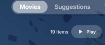

The total that you see next to the play button is just for one library. What homepage is getting is for all libraries.
JohnMason1
Yes you are right, I have more movie libraries. However, the count is still wrong, as it does count multiple versions as separate movies.

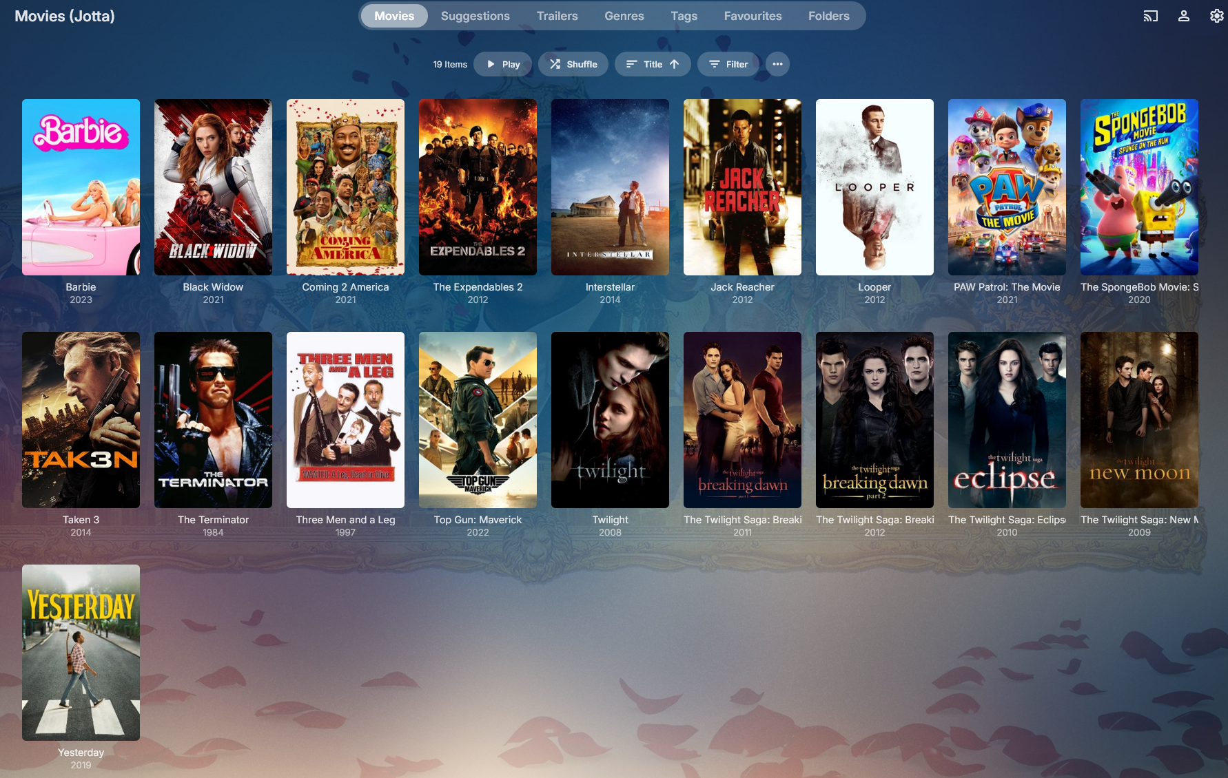

This is a test library I have created with some movies in it:
I ran this query:
curl -X GET "https://emby-domain.com/emby/Items?IncludeItemTypes=Movie&Recursive=true" -H "X-Emby-Token: api-token"
I got this result:
Homepage reports the same:

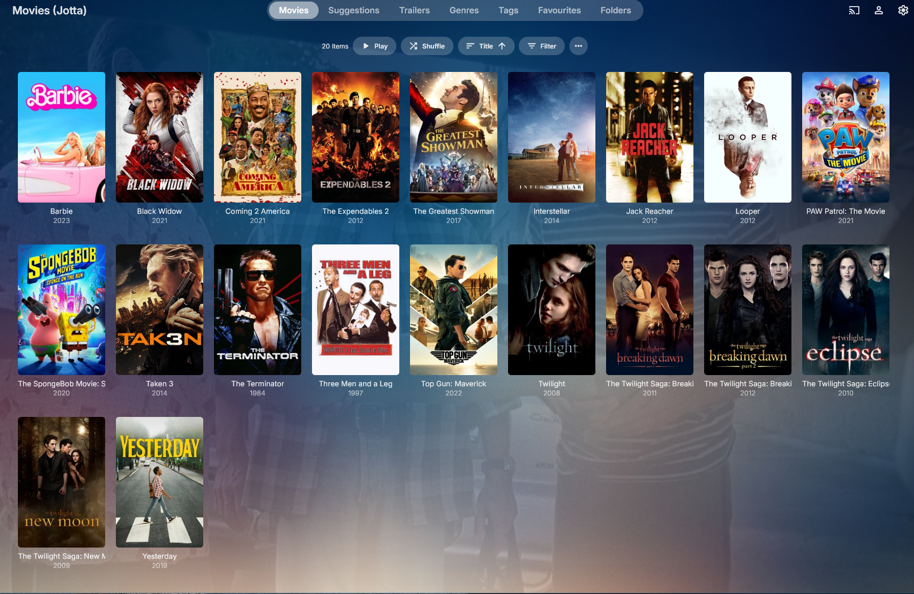

I then added a movie ("The Greatest Showman") that has two versions (HD and 4K) in two separate files.
Here is the library after adding the movie:
Here is the API count after adding that movie (same query as before):
If there is any relevant log content I can provide, please do let me know.

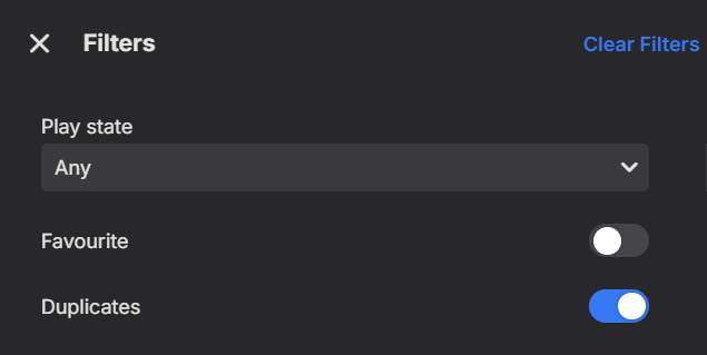

Since the current beta server now has a filter for 'Duplicates' which when toggled, includes only movies that contain multiple "versions" (and of course legit dupes)
An appropriate API filter like 'IsDuplicate' or 'ExcludeDuplicates' should in theory return the correct result that OP is looking for, but would require an update on the Homepage side for that widget to adopt.
