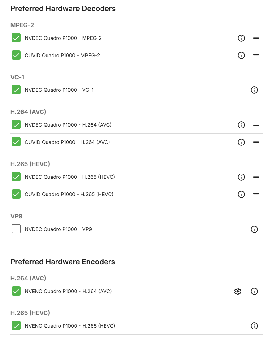

MacAndBrandon 0 Posted April 13 Posted April 13 Hey all, First time requesting assistance here so let me know if I'm missing anything. Recently I moved from Intel to AMD as I got a cheap second hand AMD 3900x, which is a significant upgrade from a N305. As it's an AMD CPU without an iGPU, I went and got an old Quadro P1000, and I've set it up with all the NVIDIA drivers and all. It's set up in Emby as below: Now the issue I'm getting is that for *some* shows, it straight up doesn't work. I've been testing this by setting the quality in the Emby app on my phone to "720p - 4mbps" (when the show is originally 1080p) and trying to play shows. For the ones that don't work, it just doesn't play anything (black screen). I've attached two transcoding logs - one that work, and one that didn't. The weird thing is that both are 1080p HEVC, so I would assume the encoding would be the same (but I'm a newbie to encoding video files and whatnot so I could be completely wrong). Please let me know if there's something I'm missing, or why this might be - thanks a lot in advance! NOT WORKING - ffmpeg-transcode-a16d58dd-da83-485b-9af3-7ab16397a11b_1.txt WORKING - ffmpeg-transcode-22850102-2067-43ae-a71b-29e16ea3ebff_1.txt

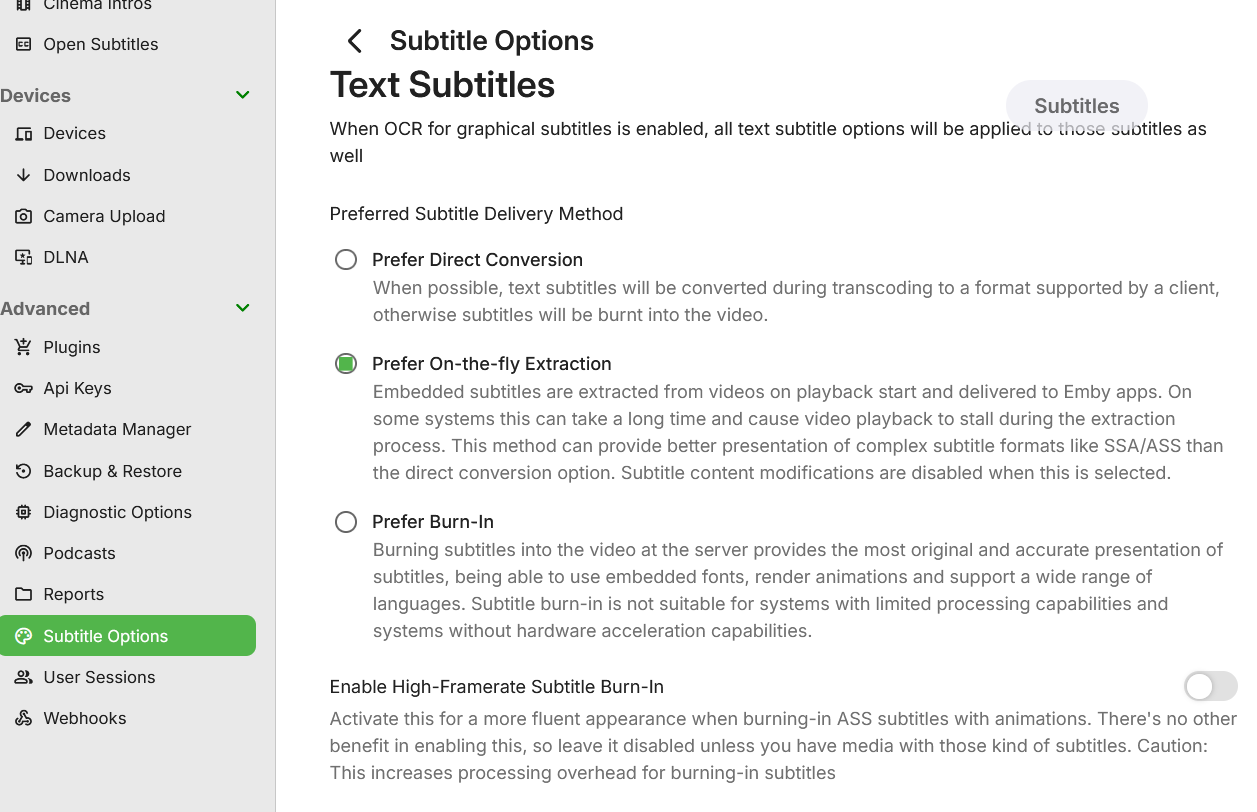

MacAndBrandon 0 Posted April 14 Author Posted April 14 Thanks a lot for having a look! Do you know where in the settings is allowing burn in? I also tried the "Allow subtitle extraction on the fly" setting which seemed to work on the phone but I tried Emby Theatre on the PC and it played but subtitles didn't play for whatever reason.
MacAndBrandon 0 Posted April 14 Author Posted April 14 I'm using version 4.8.11.0, and I unfortunately don't see these subtitle options under advanced. Is it a plugin I need to install?
RanmaCanada 457 Posted April 15 Posted April 15 2 hours ago, MacAndBrandon said: I'm using version 4.8.11.0, and I unfortunately don't see these subtitle options under advanced. Is it a plugin I need to install? Not that I am aware of. I am also on 4.8.11.0
Neminem 893 Posted April 15 Posted April 15 @MacAndBrandonyou need to install the "Diagnostics PlugIn" plugin, to get that extra feature. 1
MacAndBrandon 0 Posted April 16 Author Posted April 16 @NeminemThank you for that! Installed the plugin. I've turned on the "prefer burn-in" setting, as well as the "Allow subtitle extraction on the fly" setting, will have to test a bit more to make sure it works for everything but it seems to be working now! ("prefer burn-in" alone wasn't enough to make it work). I'll have to see if fancy subtitles still work too.
Neminem 893 Posted April 16 Posted April 16 When using this plugin. I think you need to reenable those options, after every restart of Emby server. 1
