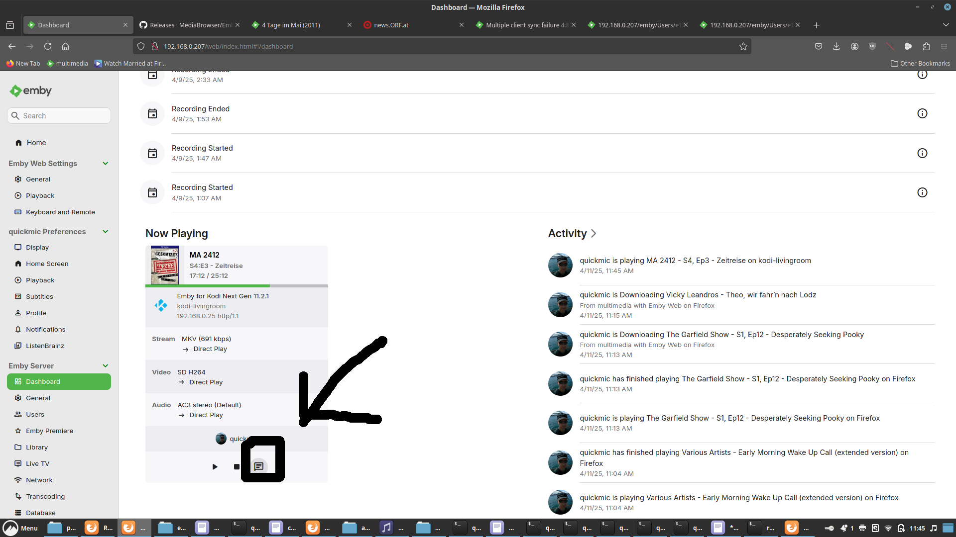

I gave it a few days, and sure enough all my issues stem from the server clock. I shouted the F word for a straight hour, given how much time I wasted. This thread is a total waste of time for any visitors, so I'd suggest delete it or rename it "Dumbass never bothered to check the pc clock, and sync went to hell". To excuse my noob mistake, this server has been powered on non stop for 15 years. I never wouldve thought to check such obvious things after so long a period of flawless function.
Anyway, there's  happy accident, as discovering the kodi companion plug-in ad been great! It works like a champ. No longer will I need to repair when I delete or shift videos around file system.
Lastly, I'm not sure if there's a discussion regarding the Titan version of Kodi, but after a few weeks of testing, I've downgraded back to Nexus. There's a host of performance issues I find too annoying to ignore with Titan, such as fast forwarding through a tv episode to the end will auto play the next episode, but the screen kicks out to the show menu while the episode plays in the background. Kind of minor, but still a bug. Plus Titan frequently crashes and restarts upon wake almost 100% of the time. Ne us, on the other hand, works perfectly. Is there any performance reasons to consider with emby on Titan? Am I sacrificing quality of display to avoid fiddly issues on Nexus?
Sorry for wasting your time with my 100% dumbass user side issue. But I greatly appreciate the effort.
