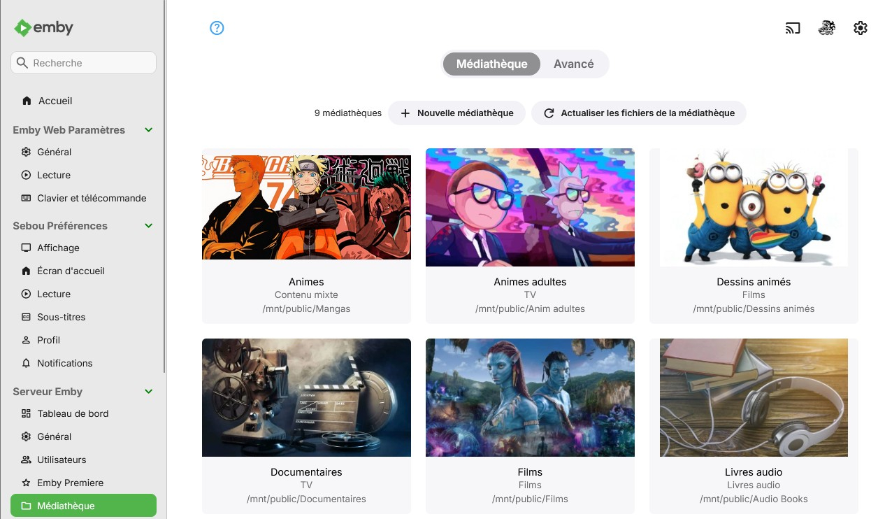

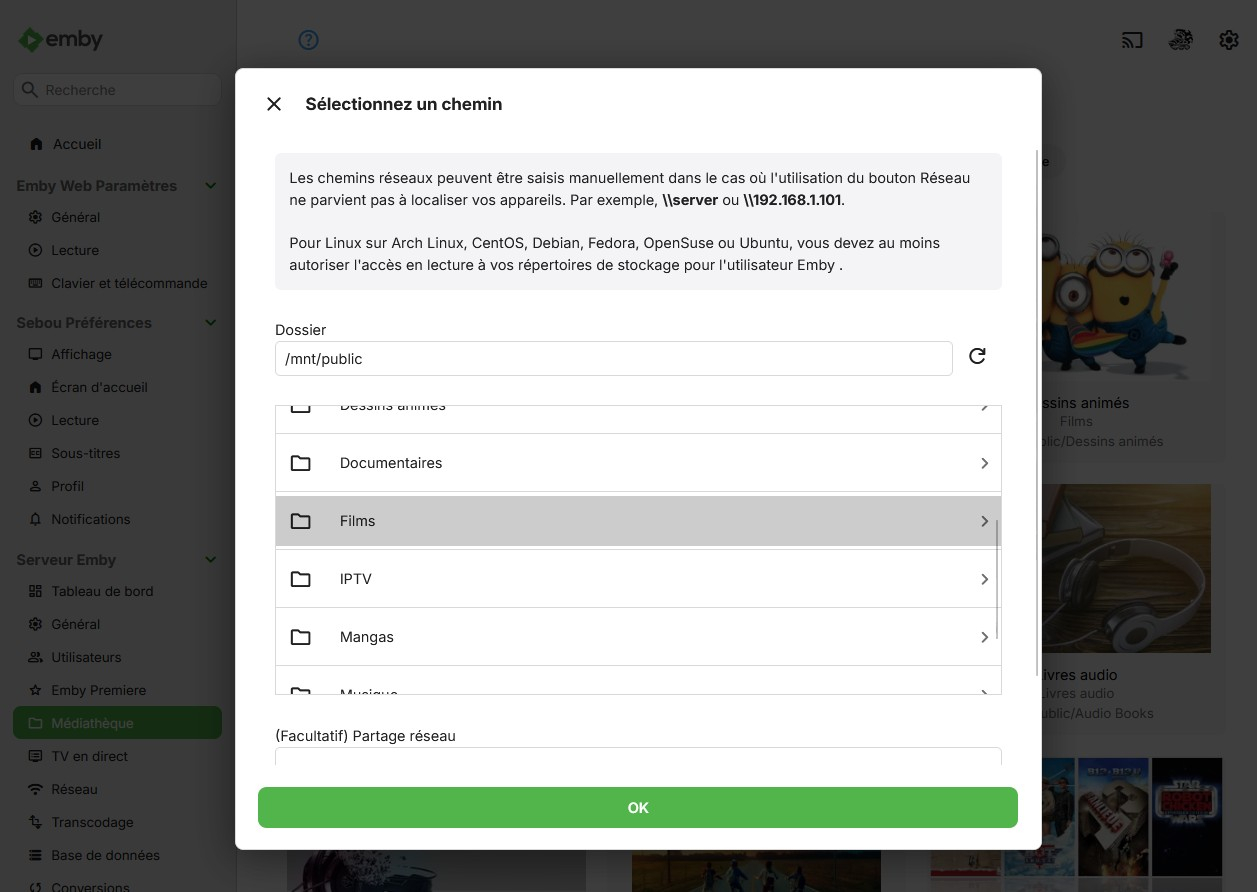

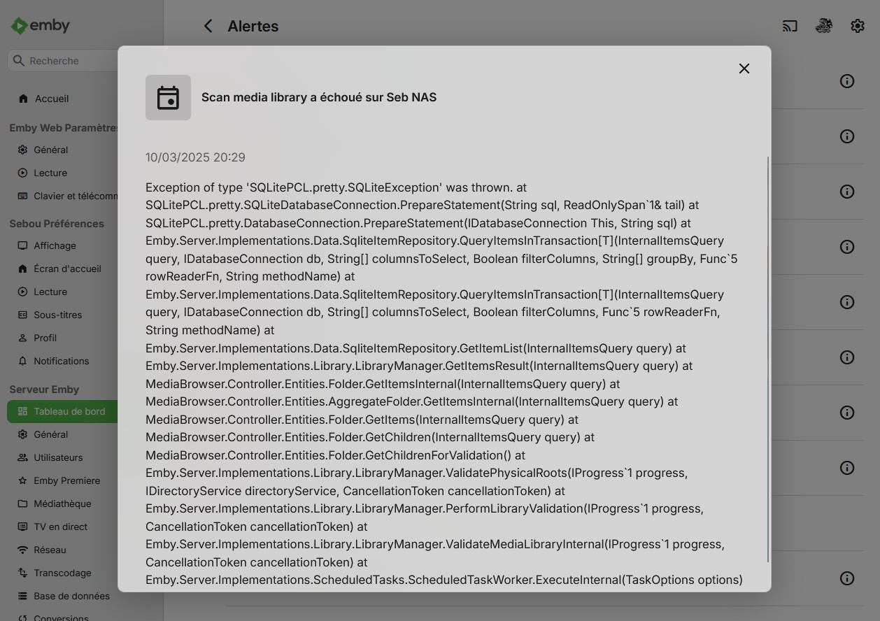

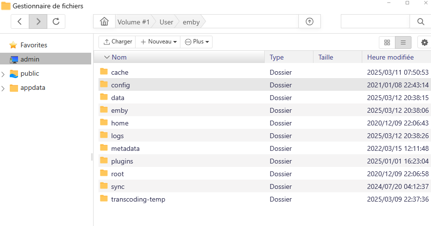

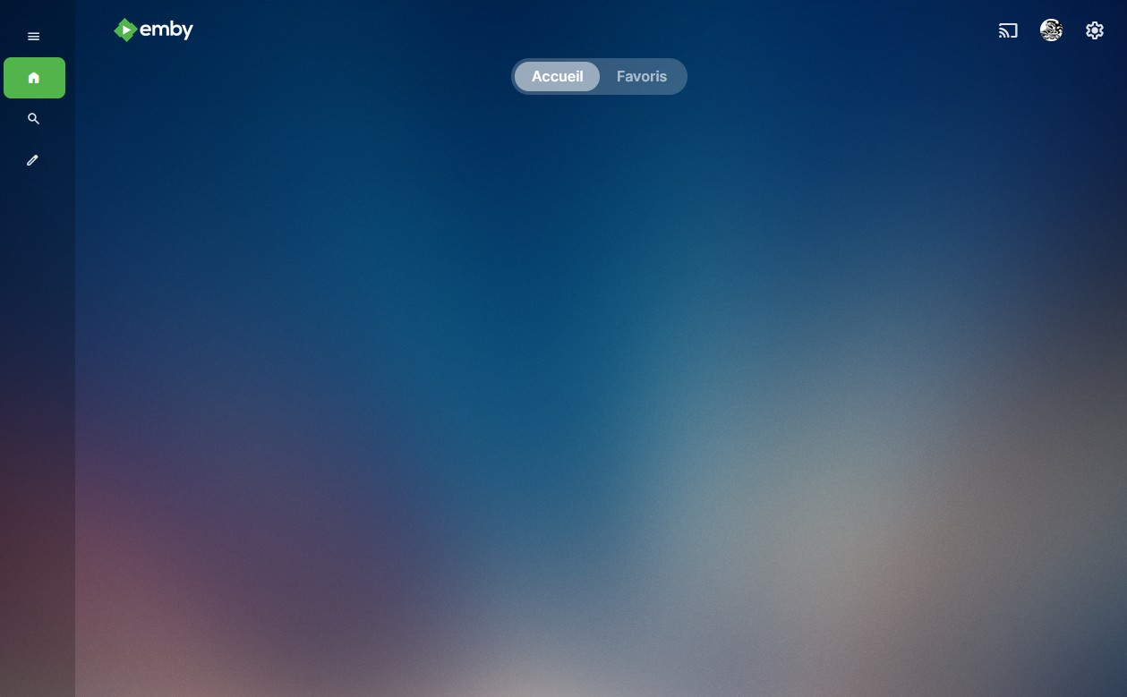

Seb988 0 Posted March 13 Posted March 13 Hello, I am using Emby on my TNAS since 2020 and had an issue recently after installing 4.9.0.41 (from 4.8.10.0) when some medias were no longer listed in the media libraries (one folder was even empty). I have then installed 4.8.11.0 and same issue. After searching on the forum, I understood that the database was corrupted and follow the tutorial to fix it but ended up deleting library.db, library.db-shm, library.db-wal files to start fresh because homepage folders were displayed but empty. Now I have recreated all my folders and linked them with my TNAS location but they are not displayed on the homepage. Scanning/refreshing library does not show any issue or logs. Not sure what to do next. I am attaching screenshots from current version I run and logs from before I cleaned up the corrupted database, and the latest log file on the TNAS Emby folder. embyserver.txt
Luke 40143 Posted March 13 Posted March 13 Hi, hi, you can’t go back from 4.9 to 4.8 , so the first thing is I would decide what version you want. If you want to beta test then I would go back to that. If you want to run on stable then you’ll need to make a fresh start and delete the server data folder: Emby Server Data Folder
Seb988 0 Posted March 13 Author Posted March 13 Thanks for the quick response I will stick to the stable version 4.8.11.0 Witch folder exactly I need to delete? All of them?
