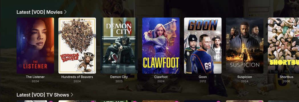

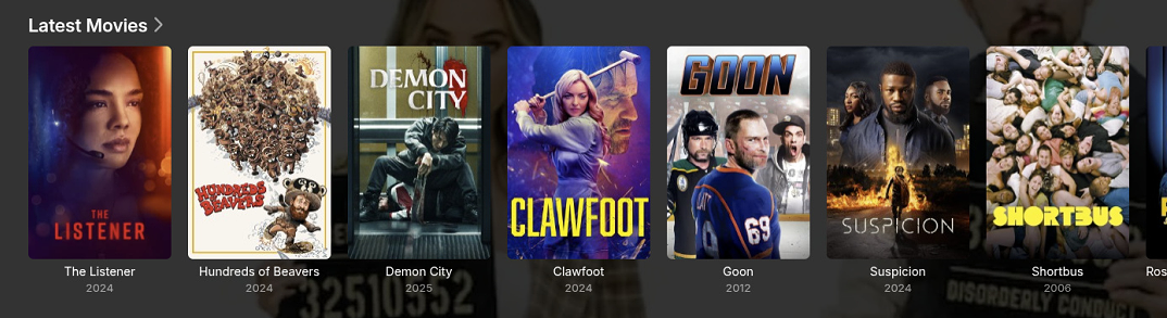

The home screen shows both libraries content in the Latest section. How can I prevent this so the library stay within their content media type?
Quote
Hi, but they are in their own separate Latest row, right?
sftech13
No

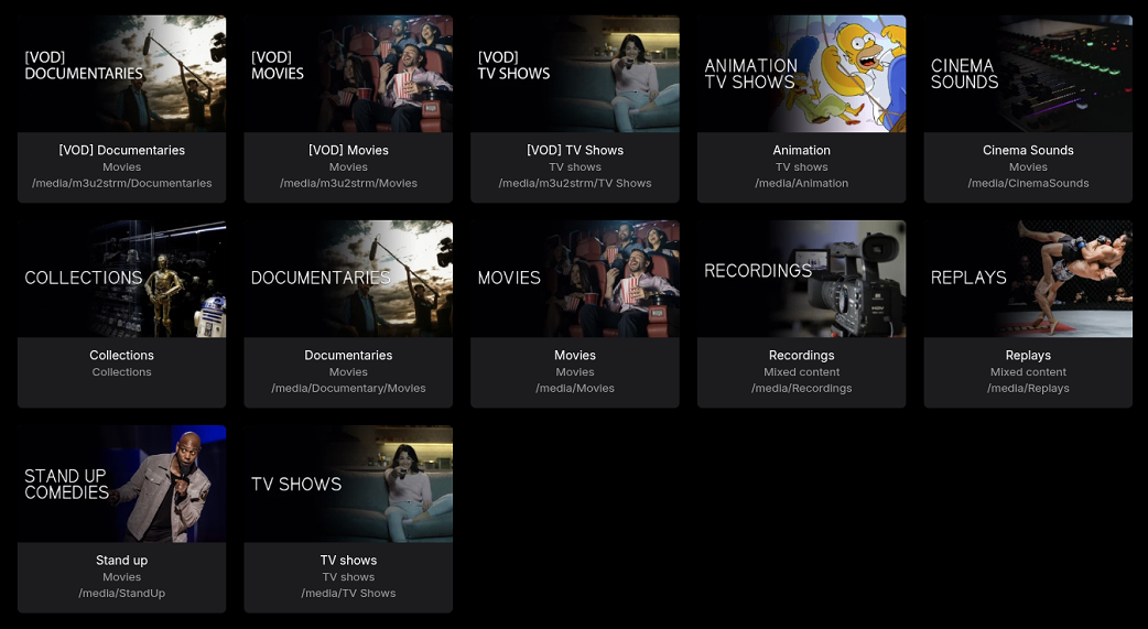

Folders for each library

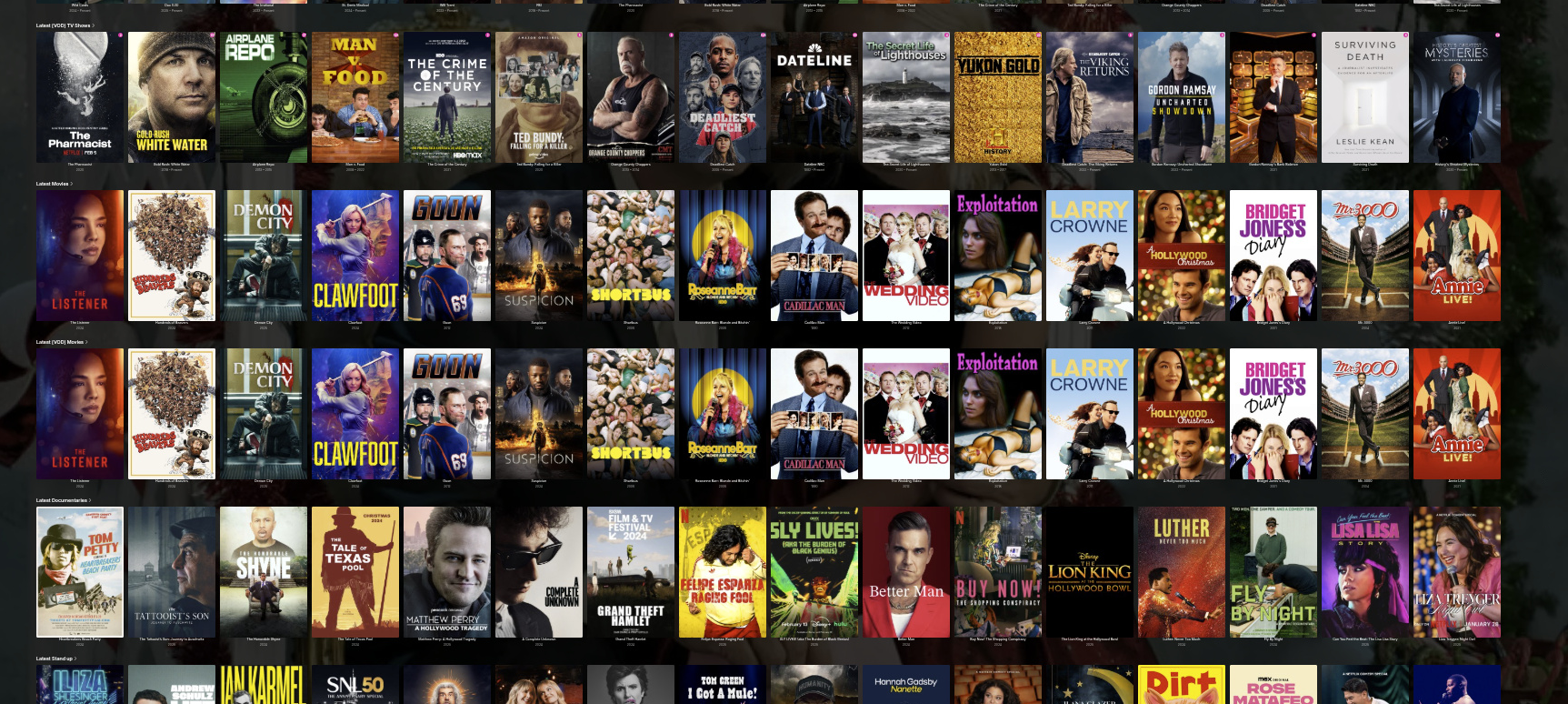

Can you please show the complete screenshot, rather than a cutout? Thanks.
sftech13
like this??? or what type of screen shot the content is alot.
OK yes that is odd. What version of the server is this?

Ok. Have you by any chance reorganized these libraries at all over the last few months in Emby library setup?
sftech13
Yes, I have
I added the VOD libraries and then I connected them to the current library since they're in different directories. I ended up not liking that so I removed them from the current directories and left them in their own directories. Although during that process I did have to remove the VOD libraries and then re-add them.
