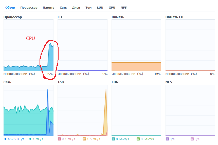

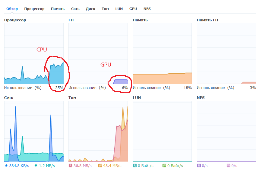

Pops32 3 Posted March 15 Author Posted March 15 (edited) 9 hours ago, Carlo said: These were AVI files. What I was looking for is if you also have this problem with mp4 or mkv files. The "MPEG4" in the title is confusing, so I thought it was MP4. Yes, it seems to be a problem with AVI, I just checked MP4 4K and MP4 1080p (codec tag avc1) from my phone - no CPU or GPU load. There is also a problem with MKV 720p H264: - first video (log ffmpeg-transcode-4f5cae67-6288-4753-95b8-118ebe33a43e_1) - CPU load 35%, GPU load 6%, i.e. there is simultaneous download (see screenshot 1); - second video (log ffmpeg-remux-e6b0c663-1fab-4f34-99d6-a5404bfd5dba_1) - CPU load 49%, GPU load 0%, i.e. acceleration does not work (see screenshot 2) embyserver (1).txt ffmpeg-transcode-4f5cae67-6288-4753-95b8-118ebe33a43e_1.txt ffmpeg-remux-e6b0c663-1fab-4f34-99d6-a5404bfd5dba_1.txt Edited March 15 by Pops32
Happy2Play 9441 Posted March 15 Posted March 15 For ffmpeg-transcode-4f5cae67-6288-4753-95b8-118ebe33a43e_1 I am not sure as decoding and encoding are happening with GPU. &TranscodeReasons=SecondaryAudioNotSupported,DirectPlayError >>>>>> Selected Codecs Decoder NVDEC NVIDIA T600 - H.264 (AVC) Adapter #0: 'NVIDIA T600' ComputeCapability: 7.5 Max Bitrate: 234 Mbit/s - Frame Sizes: 48x16...4096x4096 - Width Alignment: 2 - Height Alignment: 2 Color Formats: NV12 - Bit Depths: 8 Profiles: Constrained Baseline Profile (Level 6), Baseline Profile (Level 6), Main Profile (Level 6), High Profile (Level 6), Constrained High Profile (Level 6), Progressive High Profile (Level 6) Encoder NVENC NVIDIA T600 - H.264 (AVC) Adapter #0: 'NVIDIA T600' ComputeCapability: 7.5 Max Bitrate: 781 Mbit/s - Frame Sizes: max 4096x4096 - Width Alignment: 2 - Height Alignment: 2 Color Formats: NV12, P010, P016 - Bit Depths: 8, 10, 12, 14, 16 Profiles: Baseline Profile (Level 6.2), Main Profile (Level 6.2), High Profile (Level 6.2), High 4:4:4 Predictive Profile (Level 6.2) 11:31:37.667 Stream mapping: 11:31:37.667 Stream #0:0 -> #0:0 (h264 (native) -> h264 (h264_nvenc)) 11:31:37.667 Stream #0:6 -> #0:1 (copy) For ffmpeg-remux-e6b0c663-1fab-4f34-99d6-a5404bfd5dba_1 it will not use HWA as only audio is converted. As you see video is copied. &TranscodeReasons=AudioCodecNotSupported 11:35:28.086 Stream mapping: 11:35:28.086 Stream #0:0 -> #0:0 (copy) 11:35:28.086 Stream #0:1 -> #0:1 (dts (dca) -> mp3 (libmp3lame)) 11:35:28.086 Stream #0:5 -> #1:0 (subrip (srt) -> webvtt (native)) 11:35:28.086 Stream #0:6 -> #2:0 (subrip (srt) -> webvtt (native)) 11:35:28.086 Stream #0:7 -> #3:0 (subrip (srt) -> webvtt (native)) 11:35:28.086 Stream #0:8 -> #4:0 (subrip (srt) -> webvtt (native)) 11:35:28.086 Stream #0:9 -> #5:0 (subrip (srt) -> webvtt (native)) 11:35:28.086 Stream #0:10 -> #6:0 (subrip (srt) -> webvtt (native))
Pops32 3 Posted March 16 Author Posted March 16 On 3/15/2025 at 6:49 PM, Happy2Play said: as decoding and encoding are happening with GPU. It looks like you're right, it works in this case - I used Yandex browser (this is a chromium browser); and if you run the same video in Chrome (attached log ffmpeg-remux-fd000515-0472-4714-8003-56a8269743f4_1.txt) - it will look like the second case: On 3/15/2025 at 6:49 PM, Happy2Play said: For ffmpeg-remux-e6b0c663-1fab-4f34-99d6-a5404bfd5dba_1 it will not use HWA as only audio is converted that is, it depends on the browser ffmpeg-remux-fd000515-0472-4714-8003-56a8269743f4_1.txt embyserver (2).txt 1
