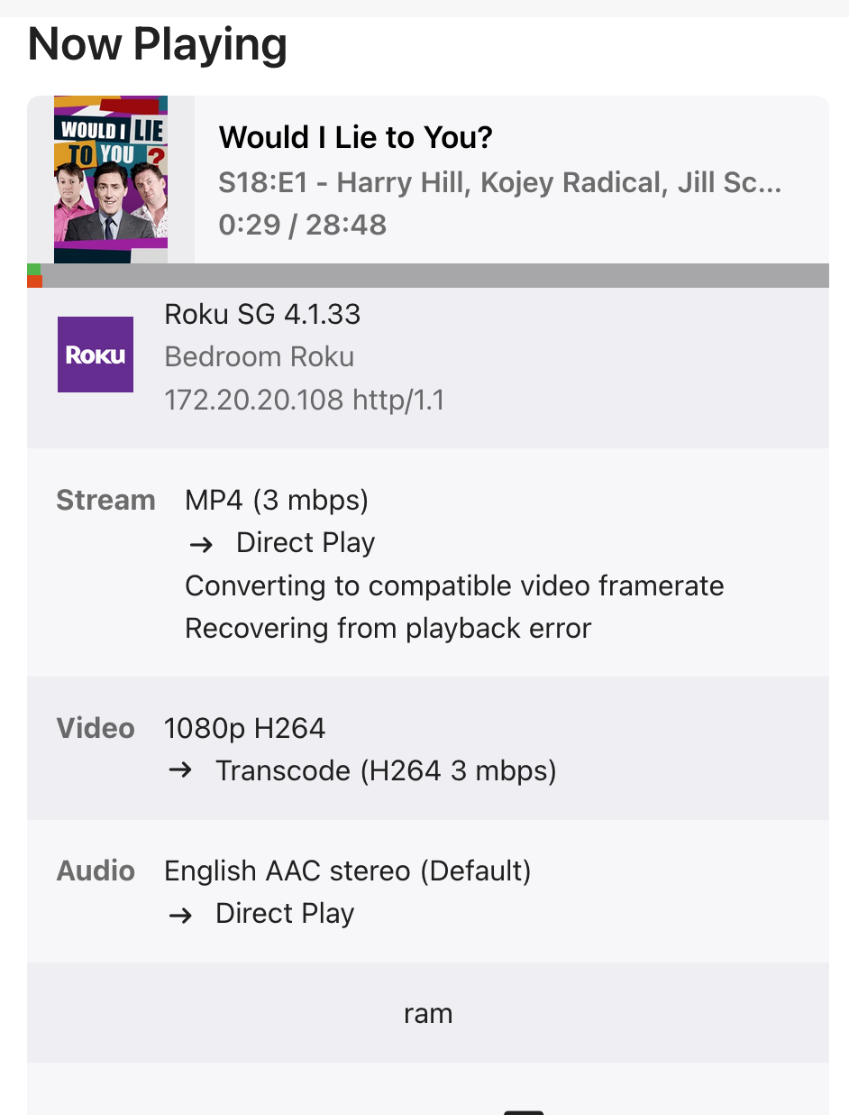

I have several series that play on the web client but fail on Roku Ultras running Emby client 4.1.33.
Server:
Operating System: Linux version 5.15.0-1072-raspi (buildd@bos03-arm64-059) (gcc (Ubuntu 11.4.0-1ubuntu1~22.04) 11.4.0, GNU ld (GNU Binutils for Ubuntu) 2.38) #75-Ubuntu
OS/Process: arm/arm
Emby Server version: 4.8.10.0
Operating system: Unix 5.15.0.1072
The attached logs are for one of these files that puts up a spinner for 30 seconds or so and then plays a few seconds of video and then repeats the process.  This generated the attached server log, a hardware detection log and then 25 ffmpeg-transcode logs (first and last attached), at which point I gave up.
This was on a freshly rebooted Roku.   I've tested with identical results with both 5Ghz WiFI and a wired ethernet connection to the Roku.
I initially though the problem was with very large files but the example logged was passed through Handbrake to produce a 3.33 MBPS H.264 file, with exactly the same symptoms as the original larger file.
I've been unable to identify a way to get logs from the Roku.
embyserver-63876877475.txt ffmpeg-transcode-75169916-d902-44de-a256-8595e6ea1e9f_1.txt ffmpeg-transcode-92ed2db9-1c0f-4f8c-aa31-15a173c5f27b_1.txt hardware_detection-63876876023.txt

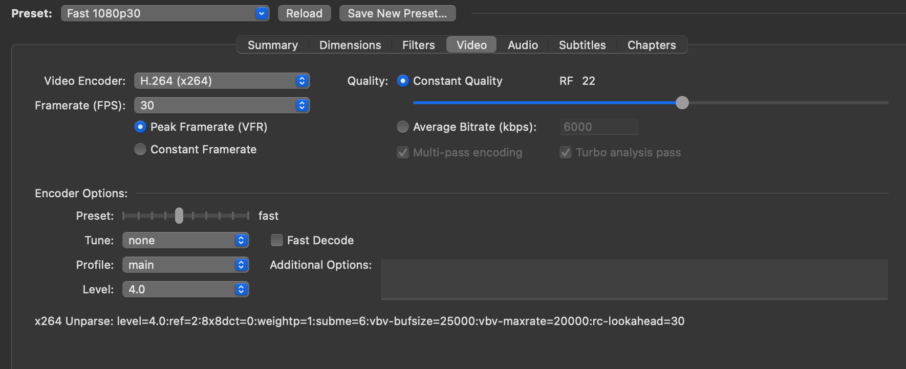

HI, if you look at this data from ffprobe:
{"Protocol":"File","Id":"b30368082de39c8a299a00122e097aef","Path":"/mnt/emby2/tv/Would I Lie to You!/Season 18/Would.I.Lie.to.You.S18E01.1080p.iP.WEB-DL.AAC2.0.H.264-NTb.mp4","Type":"Default","Container":"mp4","Size":721157989,"Name":"Would.I.Lie.to.You.S18E01.1080p.iP.WEB-DL.AAC2.0.H.264-NTb","IsRemote":false,"HasMixedProtocols":false,"RunTimeTicks":17288520000,"SupportsTranscoding":true,"SupportsDirectStream":true,"SupportsDirectPlay":true,"IsInfiniteStream":false,"RequiresOpening":false,"RequiresClosing":false,"RequiresLooping":false,"SupportsProbing":false,"MediaStreams":[{"Codec":"h264","CodecTag":"avc1","Language":"und","ColorTransfer":"bt709","ColorPrimaries":"bt709","ColorSpace":"bt709","TimeBase":"1/90000","VideoRange":"SDR","DisplayTitle":"1080p H264","NalLengthSize":"4","IsInterlaced":false,"BitRate":3164102,"BitDepth":8,"RefFrames":1,"IsDefault":true,"IsForced":false,"IsHearingImpaired":false,"Height":1080,"Width":1920,"AverageFrameRate":29.347536,"RealFrameRate":150,"Profile":"Main","Type":"Video","AspectRatio":"16:9","Index":0,"IsExternal":false,"IsTextSubtitleStream":false,"SupportsExternalStream":false,"Protocol":"File","PixelFormat":"yuv420p","Level":40,"IsAnamorphic":false,"ExtendedVideoType":"None","ExtendedVideoSubType":"None","ExtendedVideoSubTypeDescription":"None","AttachmentSize":0},{"Codec":"aac","CodecTag":"mp4a","Language":"eng","TimeBase":"1/48000","DisplayTitle":"English AAC stereo (Default)","DisplayLanguage":"English","IsInterlaced":false,"ChannelLayout":"stereo","BitRate":164098,"Channels":2,"SampleRate":48000,"IsDefault":true,"IsForced":false,"IsHearingImpaired":false,"Profile":"LC","Type":"Audio","Index":1,"IsExternal":false,"IsTextSubtitleStream":false,"SupportsExternalStream":false,"Protocol":"File","ExtendedVideoType":"None","ExtendedVideoSubType":"None","ExtendedVideoSubTypeDescription":"None","AttachmentSize":0}],"Formats":[],"Bitrate":3337049,"RequiredHttpHeaders":{},"AddApiKeyToDirectStreamUrl":false,"ReadAtNativeFramerate":false,"ItemId":"89287"}
This is what is causing the server transcoding:
"RealFrameRate":150
Is there anything you might have configured in handbrake to cause that? The Roku can possibly direct play this file, it's just that framerate is one of the criteria that our app uses to determine if it can handle it or not.

The original file was 1920x1080 at 50 fps.   Here are the Handbrake settings I used:Screenshot2025-03-07at1_32_45PM.thumb.png.d20841afc4d6f4ff2711f2bb11834f66.png
So a 150fps frame rate is a bit of a puzzle. I'll try turning off the Variable Frame Rate option and report back.
Hi, has this helped?

No really. When you convert from 50 to 30 fps, you need to distribute the existing 50 in each second frames in some ideally equal way to 30.
Example:
You got 50 pieces of cake and 30 guests.
How can you make sure that each guest can get the equal amount of cake?
Prime Factorization to find the smallest common multiple:
50 = 2 * 5 * 5
30 = 2 * 3 * 5
All green factors appear in both, except the red one (3) is missing in the 50 and needs to be added:
2 * 5 * * 3 = 150
So, to distribute your 50 pieces of cake, you cut each one into three pieces, so you got 150 pieces and each guest will get 5. (150 / 30 = 5)
For the framerate conversion, each frame isn't cut but tripled, so for each 30 fps frame, you have 5 50 fps frames as a source merge into a single frame.
1 1 1 2 2  => 1
2 3 3 3 4  => 2
4 4 5 5 5  => 3
6 6 6 7 7  => 4
7 8 8 8 9  => 5
etc
Variable frame rate is something for screen recordings or surveillance cams, but nor for home entertainment!

Netfool
Setting constant frame rate in Handbrake seems to have done the trick.  Sadly I don't see a way to make that happen in Emby's transcode processor.
  • Thanks 1

Yes, setting constant frame rate seems to do the trick.
