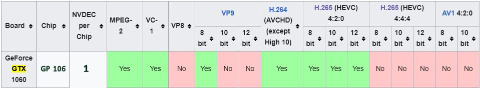

visproduction 285 Posted March 6 Posted March 6 (edited) Of interest: GTX 1060 supports: https://en.wikipedia.org/wiki/Nvidia_NVDEC Edited March 6 by visproduction

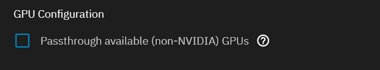

Carlo 4552 Posted March 9 Posted March 9 (edited) Check carefully you have done these steps: https://www.truenas.com/docs/truenasapps/stableapps/emby/ Check it again. If still not working have a look below. May not apply to a specific version of TrueNAS. Emby User settings make the emby user a member of video and render groups Enable GPU Passthrough on TrueNAS Scale: Go to System Settings > Advanced in the TrueNAS Scale interface. In the Isolated GPU Devices section, select the GPU you want to dedicate to applications. Save the settings and reboot the system to isolate the GPU. Add GPU to the Emby App: In the TrueNAS Scale Apps menu, locate the Emby app and click Edit. Look for a section like GPU or Resources (depending on the app interface). Assign the isolated GPU to the Emby app. This step ensures Emby has access to the GPU for hardware transcoding. Verify GPU Access in Emby: Once the app is updated, log in to the Emby server dashboard. Navigate to Settings > Transcoding and ensure hardware transcoding is enabled. Check for available hardware decoders (e.g., Intel Quick Sync or NVIDIA NVENC). If no decoders are listed, there may be a permissions or configuration issue. Edited March 10 by Carlo

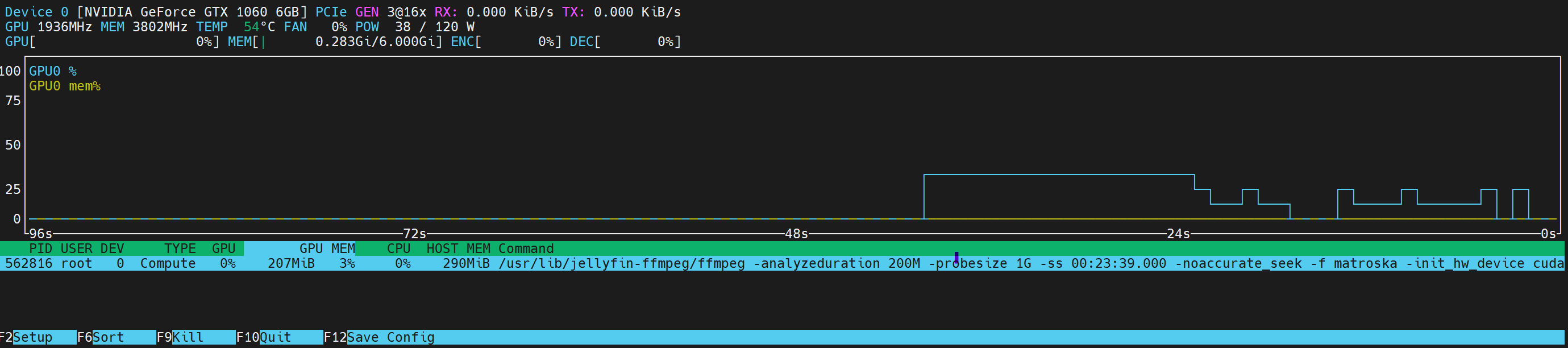

Dark6846 2 Posted March 29 Author Posted March 29 i have now tested it with jellyfin. it works there without any problems. so i do not assume that my hardware/setup outside the docker container and its config is the problem.
