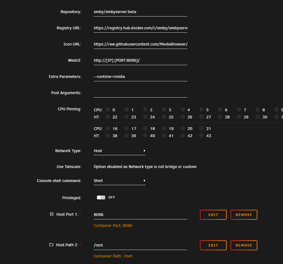

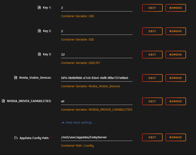

allanp81 0 Posted March 6 Author Posted March 6 Here is my docker settings: I've tried setting the GIDLIST as 18 and other things but makes no difference. HEVC transcoding works in Jellyfin etc. but not this. I'm also using the beta as it wouldn't work with the normal docker so I thought maybe it was fixed in the beta and then when I tried to go back to final it wouldn't because of a DB error.

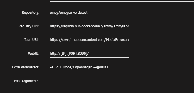

Neminem 893 Posted March 9 Posted March 9 This worked for me. Try adding --gpus all to extra parameters
allanp81 0 Posted March 9 Author Posted March 9 Thanks for the suggestion but sadly that no made no difference.

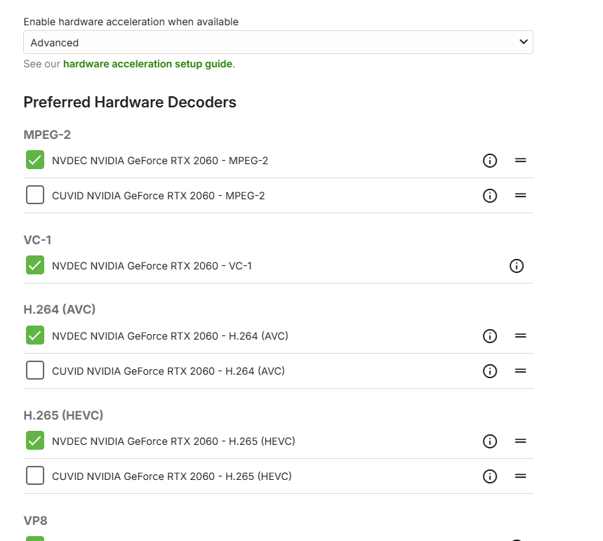

allanp81 0 Posted March 14 Author Posted March 14 All boxes for hardware transcoding within Emby are ticked: All of the files I attempt with Emby work fine in Jellyfin (and used to work fine in Emby). I fully expect some video/audio codecs to require transcoding. That's not the issue, the issue is that they never even start playing with hardware transcoding enabled. Everything works fine with software transcoding.
