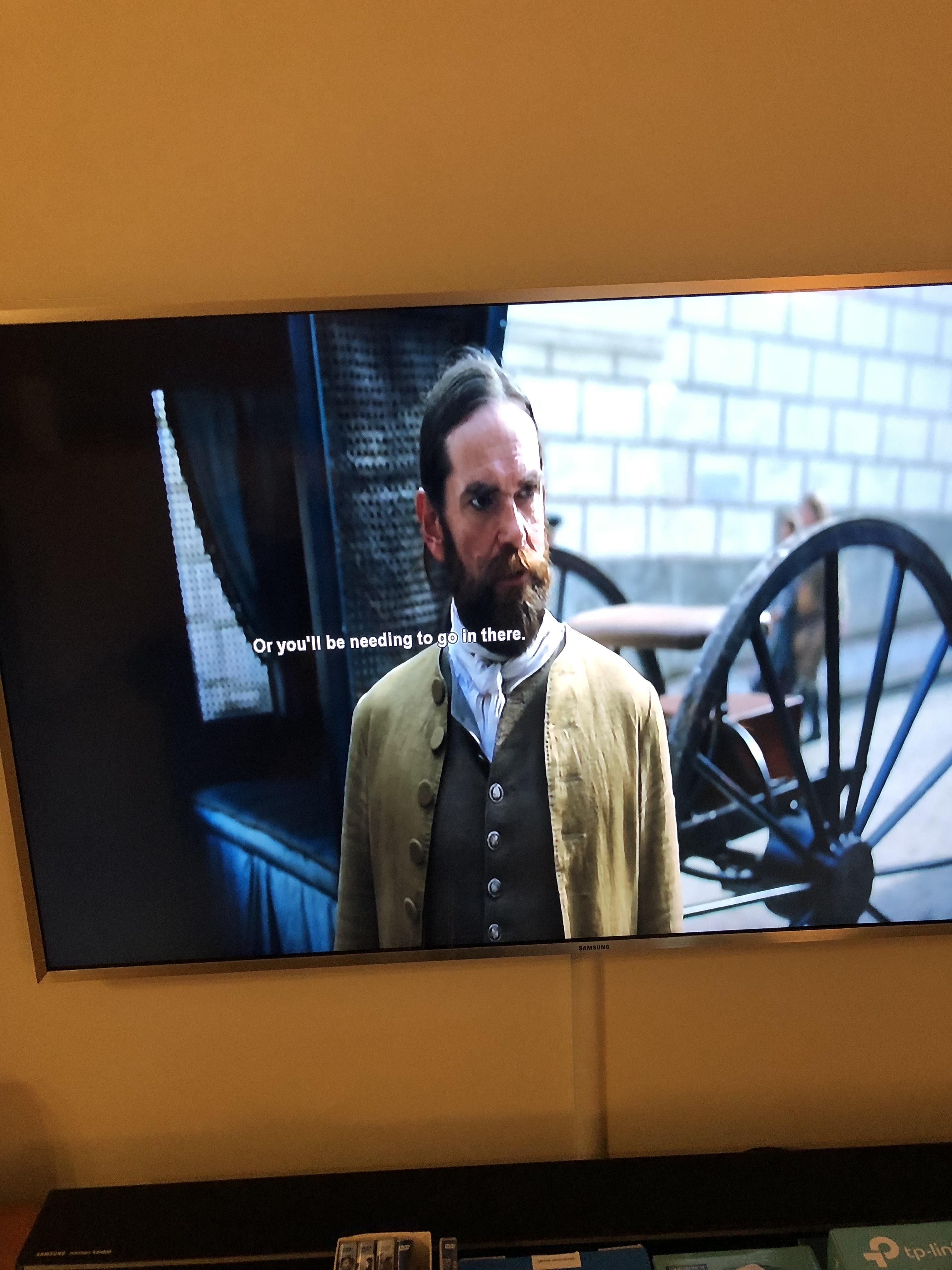

jra11500 2 Posted March 4 Posted March 4 Up to this point, I have ripped all my movies and series in the MP4 format. Now I have a need to use subtitles in several languages and am testing the MKV Lossless format. In viewing on my Samsung Smart TV with an Amazon FireTV stick, the subtitles appear in the vertical center of the video and I can not get the subtitles to appear at the bottom of the screen. If I view the same video with the native Samsung app, the subtitles appear at the bottom as expected. Am I missing something here?

jra11500 2 Posted March 7 Author Posted March 7 I have installed both apps and both have the same results. The subtitles continue to display in the middle of the screen. Also, the video does not automatically display in a full screen even though auto aspect ratio is selected. I also have an issue with forced subtitles which do not work. I have to select a subtitle language and the subtitles are always displayed. From what I understand, forced subtitles should only appear when there is a different language spoken. I don't know if Emby has a problem or if there is a problem when I rip the video. I use VideoByte.

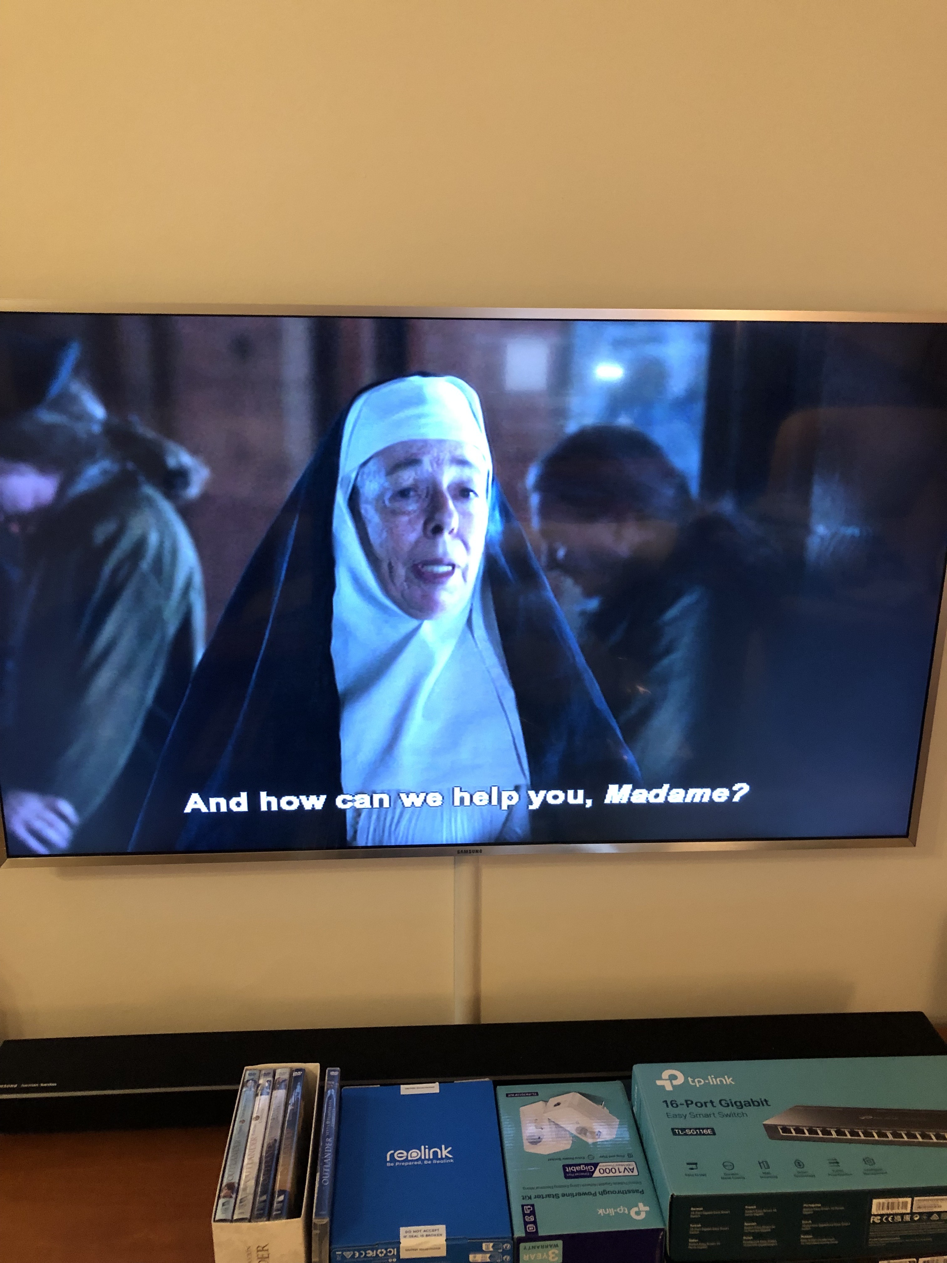

jra11500 2 Posted March 8 Author Posted March 8 @ebr, Thanks for responding. Your comment about the subtitle file contents made me realize that perhaps the file does have the full subtitles. After all, when you purchase a DVD and subtitles are available on that DVD, then the subtitles will always be displayed when selected. I am continuing to test this. The DVD I have chosen is from the Outlander series, Season 2, third episode where French is spoken in some scenes. If I turn off subtitles, nothing is shown even when French is spoken. If I turn on subtitles, then they are always on. As stated before, this is probably normal behavior. I can accept this but it does bring me back to the original problem of where the subtitles are displayed. Here is my setup: Synology NAS with Emby server 4.8.10.0 FireTV stick with Emby app 2.1.26a In starting the video, the aspect ratio is wrong and the subtitles are in the very middle of the screen. The appears to be a problem with the FireTV app as the subtitles are at the bottom when using the native Samsung TV app. Attached are the snapshots:
ebr 15670 Posted March 8 Posted March 8 Those two look like different types of subs - at the very least one may be being burned in while the others are being displayed by the client. Can you please provide ffmpeg logs for each of those examples?

ebr 15670 Posted March 9 Posted March 9 The direct stream log is from the Fire but it appears no subtitle was chosen for that playback. The transcode log is from the Samsung and the first sub track is chosen which is an English DVDSUB and is being burned in by the server. I suspect the direct stream log doesn't match with the playback you showed. Can you try searching for our standard android app (Just "Emby" on Amazon) on the same device's app store and see how that compares? Thanks.
jra11500 2 Posted March 9 Author Posted March 9 (edited) It's odd but things seem to be working now. Earlier, I tried the standard Android app but it was doing the same thing (that is, subtitles in the middle of the screen). On the server I installed the diagnostics plug-in but made no changes in any of the settings. Now, when starting an episode with subtitles off, the app is indicating "Direct Play" (as seen under User Sessions in the server window) but it is necessary to select Playback Correction on the TV to get the screen to fill. If I then turn on subtitles, transcoding begins and the subtitles are burned in and appear correctly at the bottom of the screen. The only inconvenience now is that I have to select Playback Correction every time I start an episode. Edited March 9 by jra11500 Text correction 1
