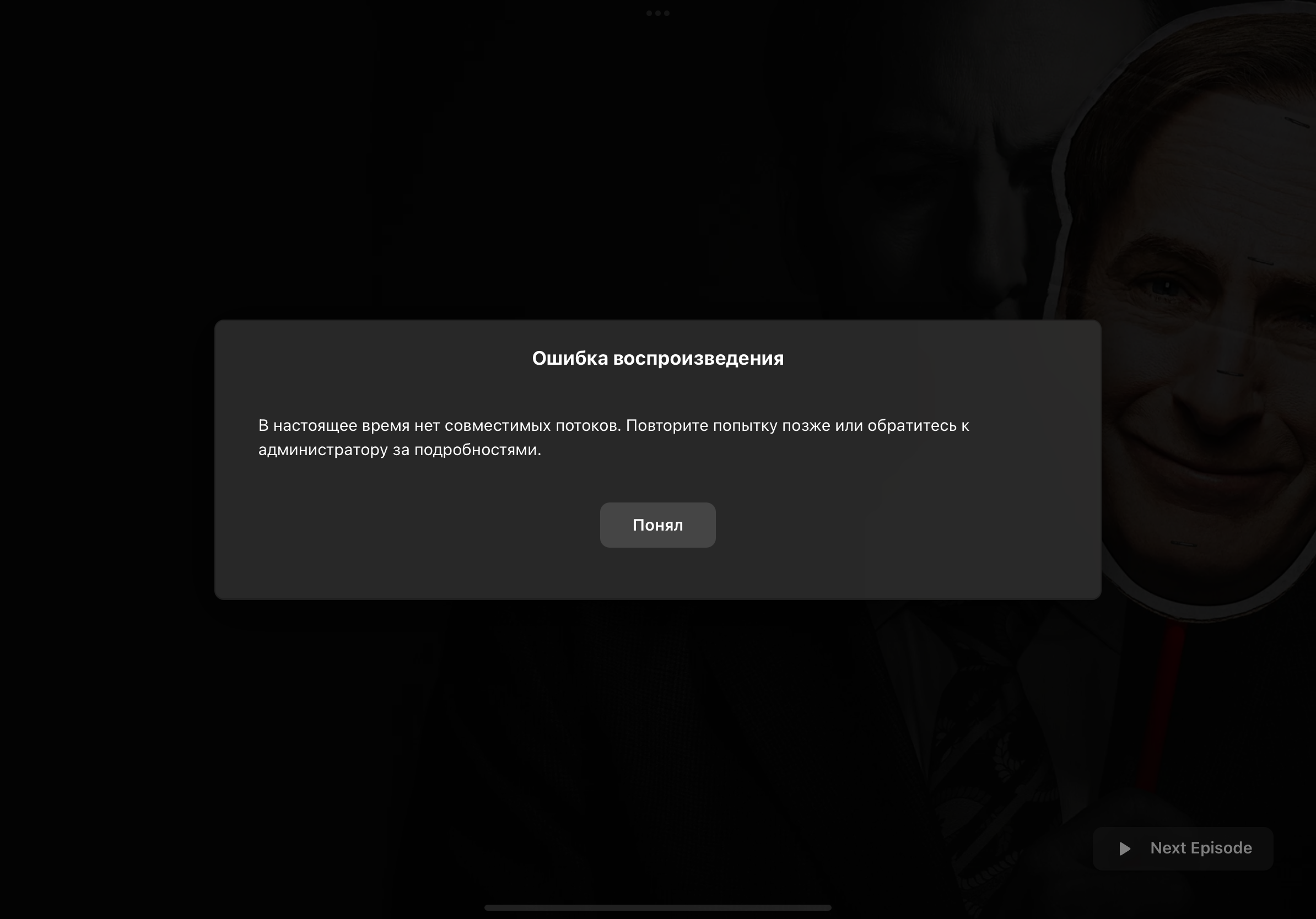

Alepim 7 Posted February 28 Author Posted February 28 On iPad I see a playback error: There are currently no compatible streams. Please try again later or contact your administrator for details.

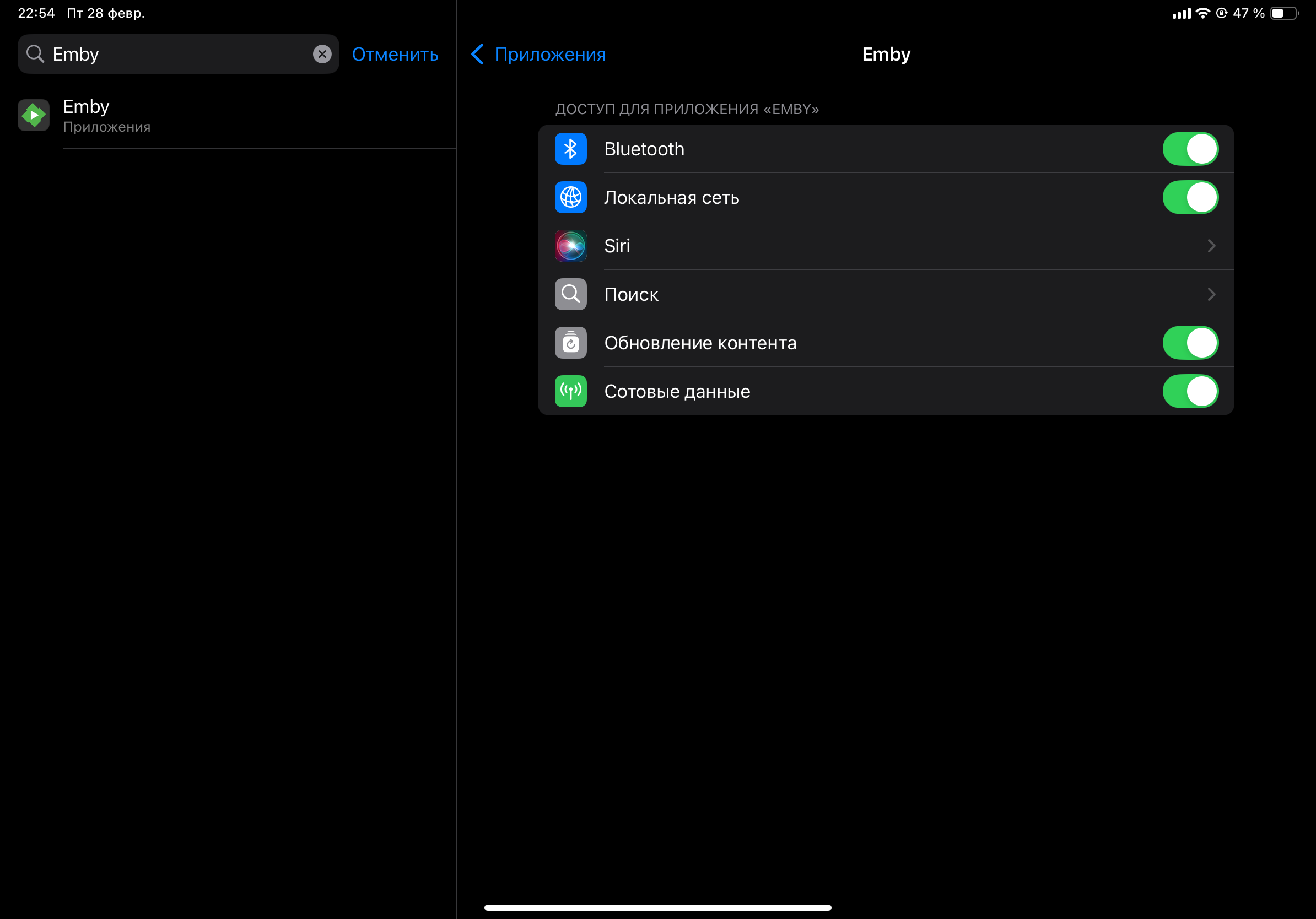

Luke 40082 Posted February 28 Posted February 28 HI, I would check iOS settings and ensure that the emby app is granted local network access.
Alepim 7 Posted February 28 Author Posted February 28 5 minutes ago, Luke said: HI, I would check iOS settings and ensure that the emby app is granted local network access. The switch for "Local Network" is enabled for the Emby app, but maybe there are some other settings?
Alepim 7 Posted February 28 Author Posted February 28 25 minutes ago, Luke said: HI, can you show a screenshot? thanks. Spoiler
