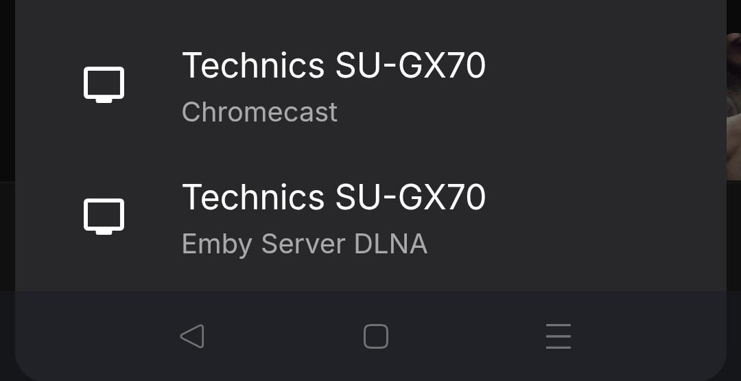

xiewen 0 Posted February 13 Author Posted February 13 Right now on Chromium (Linux system) it doesn't show the amplifier at all. Now on my Android phone in the Emby-App it only shows the Chomecast option. Yesterday on my Android for a very short period of time it also showed the DLNA option (see screenshot). When I choose the Chromecast option I see a blue circle (trying to connect which fails) and the music plays locally from my phone. The DLNA issue though might be a network/amplifier problem... I realized that the amplifier shows up replugging it. I contacted Technics support about it. Let's see. Should I open another Thread about emby not being able to connect to this particular Chromecast?
