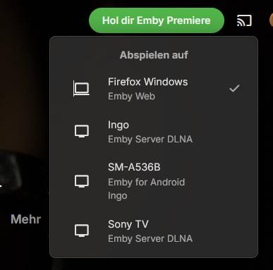

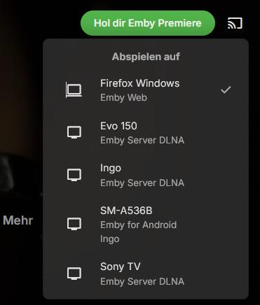

imebro 1 Posted February 27 Author Posted February 27 Hallo Luke, today i want try to start the EMBY-App with my phone again. Strangely enough, I can no longer select my amplifier (see screenshot). Previously, I could also start my music via the Emby mobile app, for example. Now I first have to establish a Bluetooth connection on the PC, then connect the amplifier and then select the amplifier for the output... Only then does it work. And then I have to select “Firefox Windows - Emby App”. Previously it said “Evo 150”. This no longer appears. Has this perhaps changed due to a recent update? Greetings, imebro
Luke 40121 Posted February 27 Posted February 27 3 hours ago, imebro said: Hallo Luke, today i want try to start the EMBY-App with my phone again. Strangely enough, I can no longer select my amplifier (see screenshot). Previously, I could also start my music via the Emby mobile app, for example. Now I first have to establish a Bluetooth connection on the PC, then connect the amplifier and then select the amplifier for the output... Only then does it work. And then I have to select “Firefox Windows - Emby App”. Previously it said “Evo 150”. This no longer appears. Has this perhaps changed due to a recent update? Greetings, imebro Is your amplifier running and connected to the network?
imebro 1 Posted February 28 Author Posted February 28 Hello Luke, yes, my amplifier is running and connected to the network. I have nothing changed in EMBY (Browser and Phone-App), but EMBY yesterday don´t find the amplifier. But now i have try it again and now i can see the amplifier "Evo 150" as "Emby Server DLNA". I can not understand, because yesterday i have start my music about the path with the "windows explorer". Greetings imebro
Luke 40121 Posted February 28 Posted February 28 Sometimes it may help to restart the amplifier while Emby Server is running. It's possible that the amplifier only sends out broadcasts over the network when it starts.

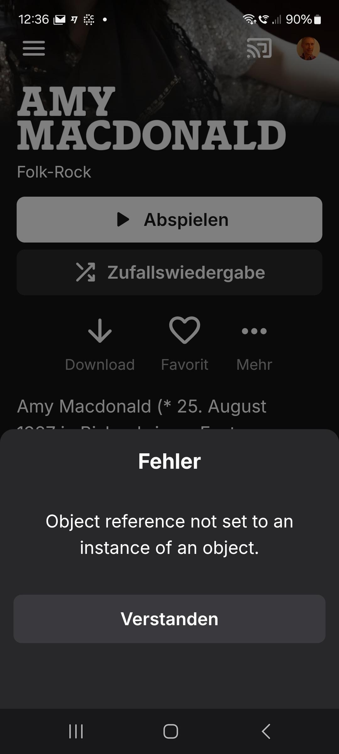

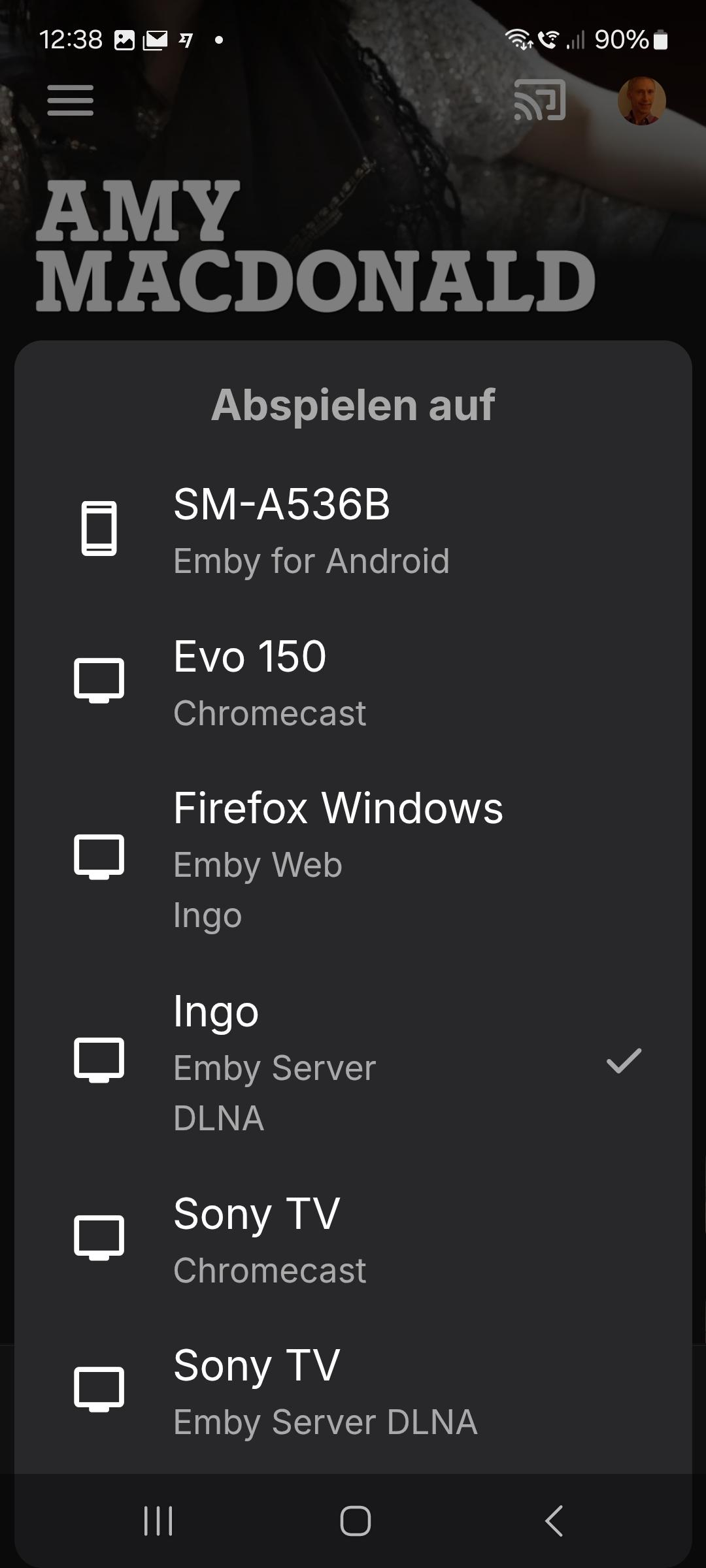

imebro 1 Posted April 1 Author Posted April 1 Hello Luke, I have been using EMBY for a while now and am happy with it. But since Sunday, playing tracks via the smartphone no longer works. I have attached 2 screenshots. On the 1st screenshot you can see that I have selected the correct server via the smartphone app “Ingo Emby Server DLNA”. On the 2nd screenshot you can see the error message that appears as soon as I start a track. I had this error at the beginning, but I don't know how I solved the problem back then. For your information: My laptop is switched on during this and I also use EMBY on the laptop via the browser (Firefox). When I start a title there, I get the same error message. Do you have any idea how I can solve this problem? Thank you and best regards, imebro
Luke 40121 Posted April 1 Posted April 1 17 minutes ago, imebro said: Hello Luke, I have been using EMBY for a while now and am happy with it. But since Sunday, playing tracks via the smartphone no longer works. I have attached 2 screenshots. On the 1st screenshot you can see that I have selected the correct server via the smartphone app “Ingo Emby Server DLNA”. On the 2nd screenshot you can see the error message that appears as soon as I start a track. I had this error at the beginning, but I don't know how I solved the problem back then. For your information: My laptop is switched on during this and I also use EMBY on the laptop via the browser (Firefox). When I start a title there, I get the same error message. Do you have any idea how I can solve this problem? Thank you and best regards, imebro Hi there, please attach the Emby server log from when the problem occurred: How to Report a Problem Thanks!

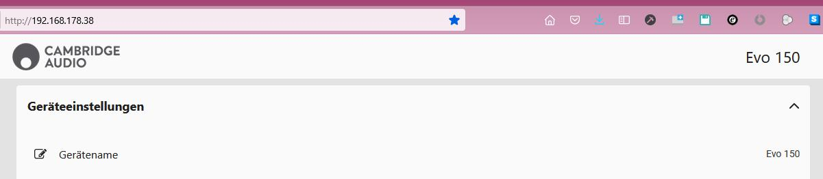

imebro 1 Posted April 2 Author Posted April 2 Hello Luke, I have now reconnected the external hard disk directly to the streaming amplifier (Evo 150) as a test. Access via the original Cambridge Audio app works very well. But I can't connect to the music on the external hard disk via Emby. I have already tried to specify the IP address for access. But Emby cannot find the Evo 150 or the external hard disk on the Evo 150. Greetings from imebro

imebro 1 Posted April 4 Author Posted April 4 Hello Luke, the external hard disk is now connected directly to the Evo 150 amplifier. And this Evo 150 is connected to the router via LAN cable. My laptop is also connected directly to the router via LAN cable. I therefore thought that it would be possible to access the hard disk connected to the Evo 150 from the laptop via EMBY. But after I had entered the IP address of the Evo 150 in EMBY, no connection could be established. However, I have a connection to the settings of the Evo 150 amplifier via the browser using the same IP address. ----------- I would also be interested to know whether you were able to find a solution to the previous problem in the LOG file that I sent... i.e. when the external hard disk was connected directly to the router. Thanks for your help... Best regards, imebro

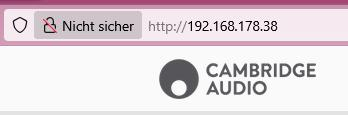

imebro 1 Posted April 5 Author Posted April 5 (edited) Thanks, but my amplifier (Evo 150) i can see in the browser about his internet-Adress. You can see it at the Screenshot. But with the same IP-Adress i can not find him with EMBY. Maybe i make a mistake. Can you tell me, what i must do for have a connection with EMBY, when my amplifier ist connected with my router in the same network? Greetings, imebro Edited April 5 by imebro

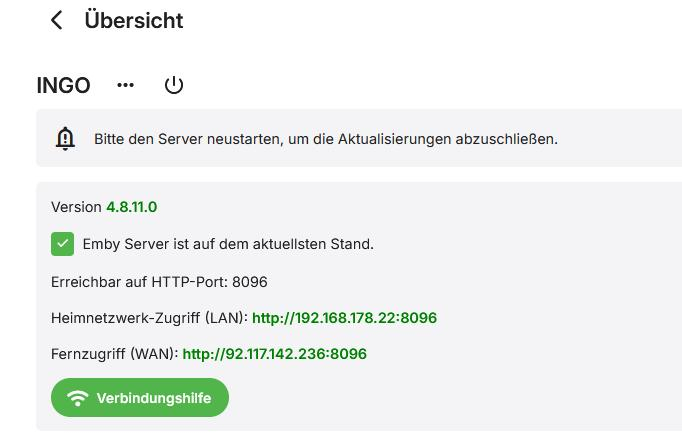

imebro 1 Posted April 6 Author Posted April 6 (edited) Hello Luke, thanks for you answer again. I have posted 2 screenshots here. One shows the settings in the EMBY dashboard and the other shows the IP address of the Evo150 amplifier displayed in the browser. And now i have restart the EMBY-Server. Greetings, imebro Edited April 6 by imebro
