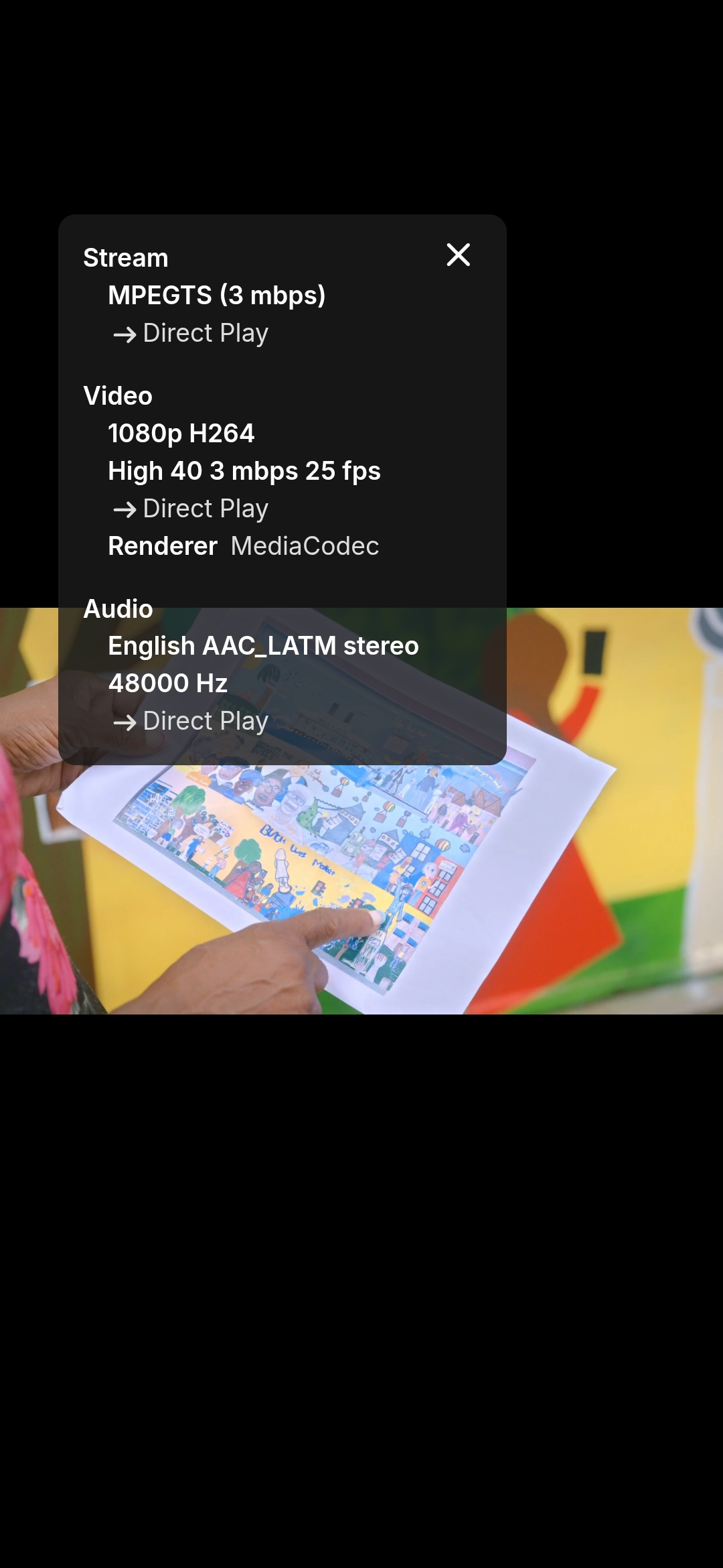

Jibest 27 Posted February 9 Posted February 9 Hi, I've noticed that on my Android devices (Samsung Phone & Fire Tablet) I get no audio when streaming live TV channels from my HDHomerun. This happens if I upgrade the app to version 3.4.36. If I downgrade to version 3.4.20 I get working audio again. Update again to 3.4.36 and back to no audio. The Stats for nerds shows the same information on both versions of the app so it doesn't appear that it's treating the steam differently. Have others reported this? I'll get a server log uploaded once I get chance.

Jibest 27 Posted February 10 Author Posted February 10 As promised here are the server logs. From 11:48am the first stream was on app version 3.4.36 and there was no sound. The stream after that was using app version 3.4.20 and sound played fine. If you need anything else let me know.embyserver.txt

Jibest 27 Posted February 12 Author Posted February 12 9 minutes ago, Luke said: Hi, if you create a recording from the channel. Does the problem happen with that? Same thing happens. Audio plays fine when using the older app but there is no sound on recordings when using the new one. If I lower the quality to force a transcode you then get audio. Just to clarify this is only happening in the mobile app. The TV apps are all fine. I've tested this on 2 Samsung phones & a Fire tablet so far and all have the same behaviour.
