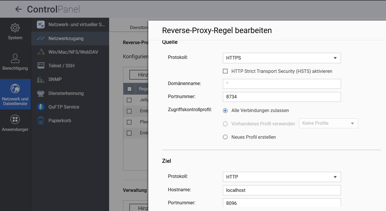

3. In the Control Panel, head over to Reverse Proxy, add one for Emby and set it up like this:

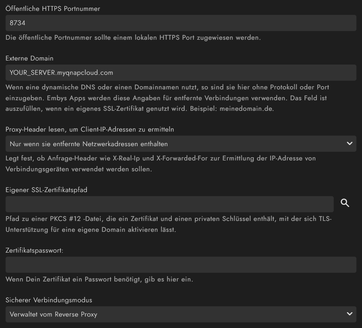

4. In Emby, go to the Network settings and fill in your data
This approach will redirect the requests from https://YOUR_SERVER.myqnapcloud.com:8734 to your QNAP http://LOCAL_NAS_IP:8096.

I created an account just to reply to this. I had no idea about the reverse proxy on qnap or how it worked, but this saved me soooooooooooooo much time and stress! Thank you so much! This was by far the easiest way to use QNAPs native SSL cert. Now I don't have to worry about manually renewing the ssl cert on Emby every 3 months!
