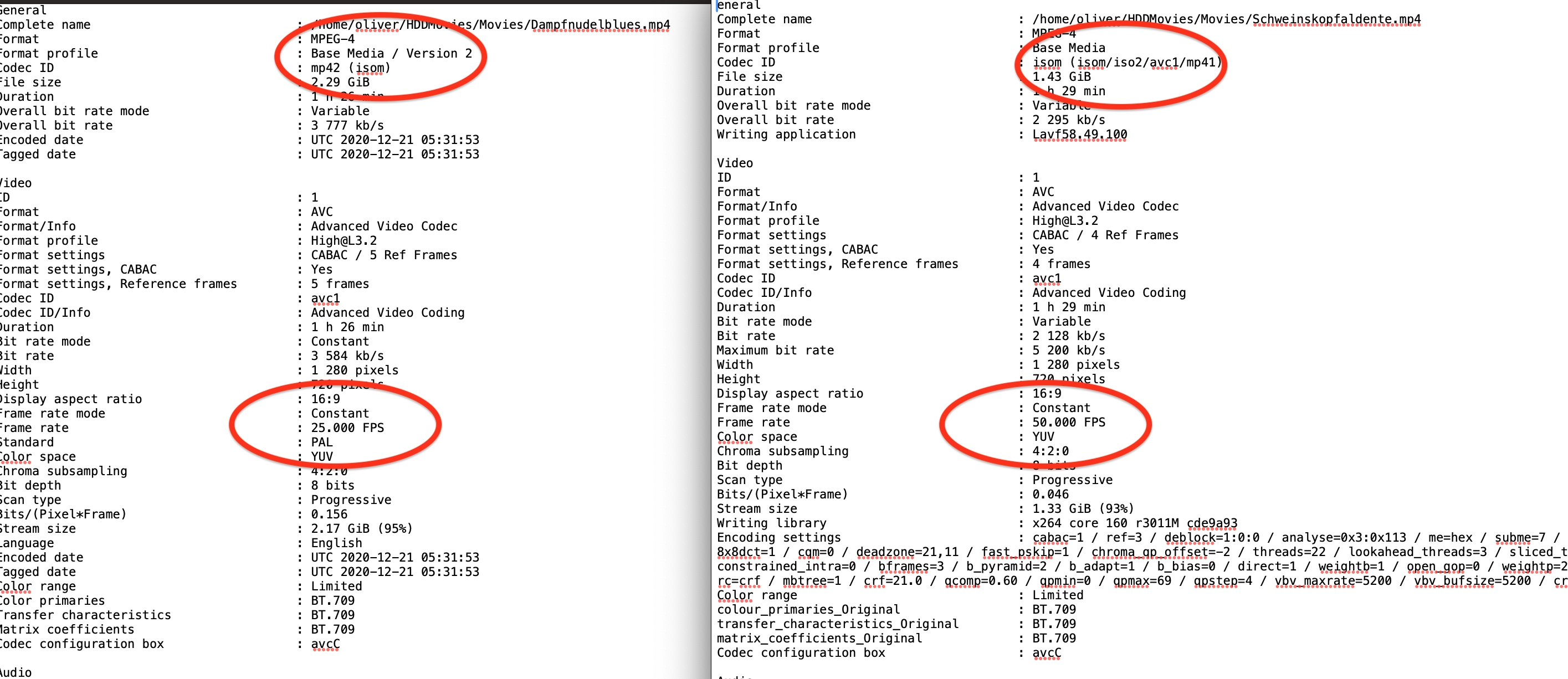

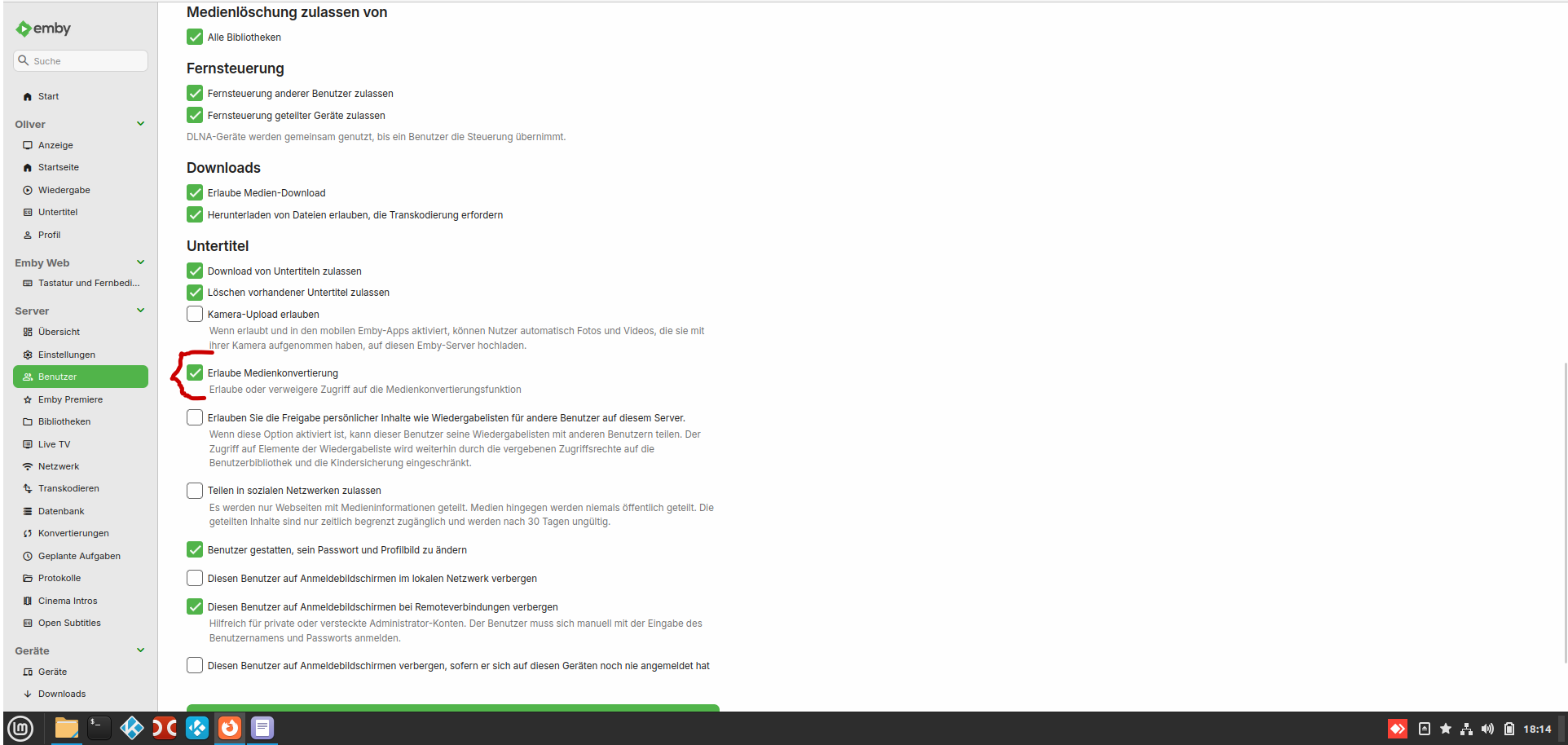

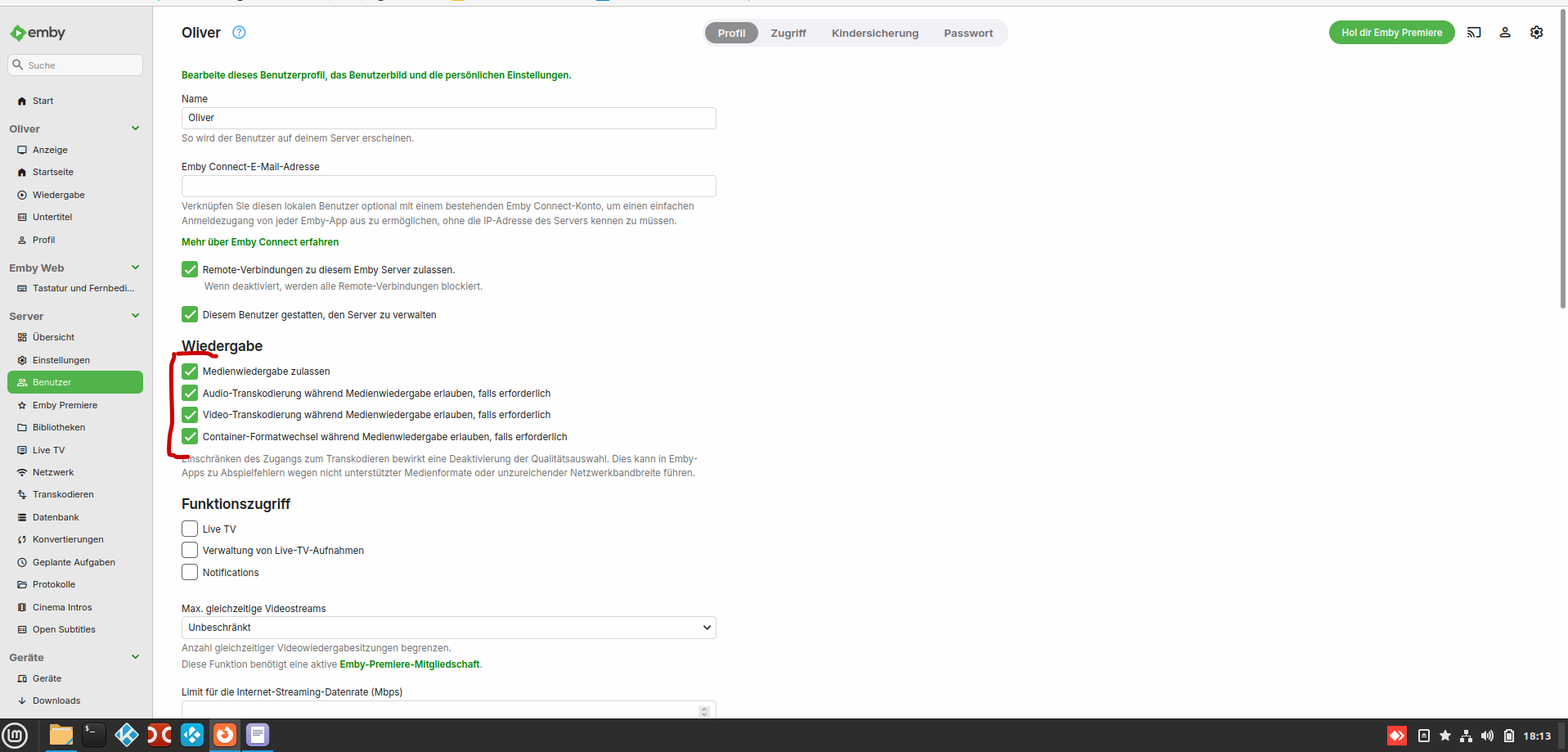

olli14 2 Posted January 24 Posted January 24 I have many movies (mkv files and ts files and mp4 files) on my Linux Mint pc. Emby server is running on this pc. With the Emby app on my Samsung TV I can look all movies that have ts file or mkv file. But I can't l look most of my mp4 files. When I try to look one of my mp4 files I get an error after a few seconds someting like this: "There is no stream available at the moment. Please ask your administrator". I tried to enable and disable different transcode settings (see pictures "Einstellungen1.png" and "Einstellungen2.png"). With these different transcode settings I tried to play the mp4 file "22 Kugeln" and made transcode logs and also the emby log. Attached the logs. Further I opened some mp4 files with Mediainfo. You find the Mediainfo of those four mp4 files (Dampfnudelblues.mp4 and 22Kugeln.mp4 and DerSchatzimSilbersee.mp4 and Schweinskopfaldente.mp4) attached. Only mp4 file "Dampfnudelblues" is playing. When I compare the MediaInfo I see that all mp4 files with "bit rate mode = variable" are not playing. Only mp4 files that have "Bit rate mode = constant" are playing. When I play for example "22 Kugeln.mp4" without using Emby then my Samsung TV is playing this mp4 file. Need help please. ffmpeg-directstream-erster Versuch1.txt ffmpeg-transcode-zweiter Versuch3.txt ffmpeg-directstream-vierter Bersuch4.txt ffmpeg-transcode-erster Versuch3.txt ffmpeg-transcode-zweiter Versuch2.txt ffmpeg-directstream dritter Versuch1.txt ffmpeg-directstream-vierter Versuch3.txt ffmpeg-transcode erster Versuch2.txt ffmpeg-directstream-dritter Versuch2.txt ffmpeg-directstream-vierter Versuch1.txt embyserver.txt ffmpeg-directstream-zweiter Versuch1.txt ffmpeg-directstream-dritter Versuch4.txt ffmpeg-directstream-vierter Versuch2.txt DerSchatzimSilbersee-Mediainfo.txt Schweinskopfaldente-Mediainfo.txt 22Kugeln-Mediainfo.txt Dampfnudelblues-Mediainfo.txt
SamES 1004 Posted January 24 Posted January 24 It could be the variable rate, but I suspect it is possibly one of these causing the issue

pektoral 22 Posted January 27 Posted January 27 Hi olli14, same problem here, but i know what is the problem. On some cheap samsung tv´s there is no playback for 50 frames movies of the german tv station. Just check your tv information, emby is doing everything well in this case. You could just convert to 25 frames, but this is causing very bad quality and bucking. Kind regards, pektoral 1 1
pektoral 22 Posted January 27 Posted January 27 Just to provide additionally information: https://forum.mediathekview.de/topic/3268/framerate-problem I have 2 Samsung TV´s one can only play 25 frames, nothing more. The second one is able to play all framerates without any problems. Kind regards, pektoral 1

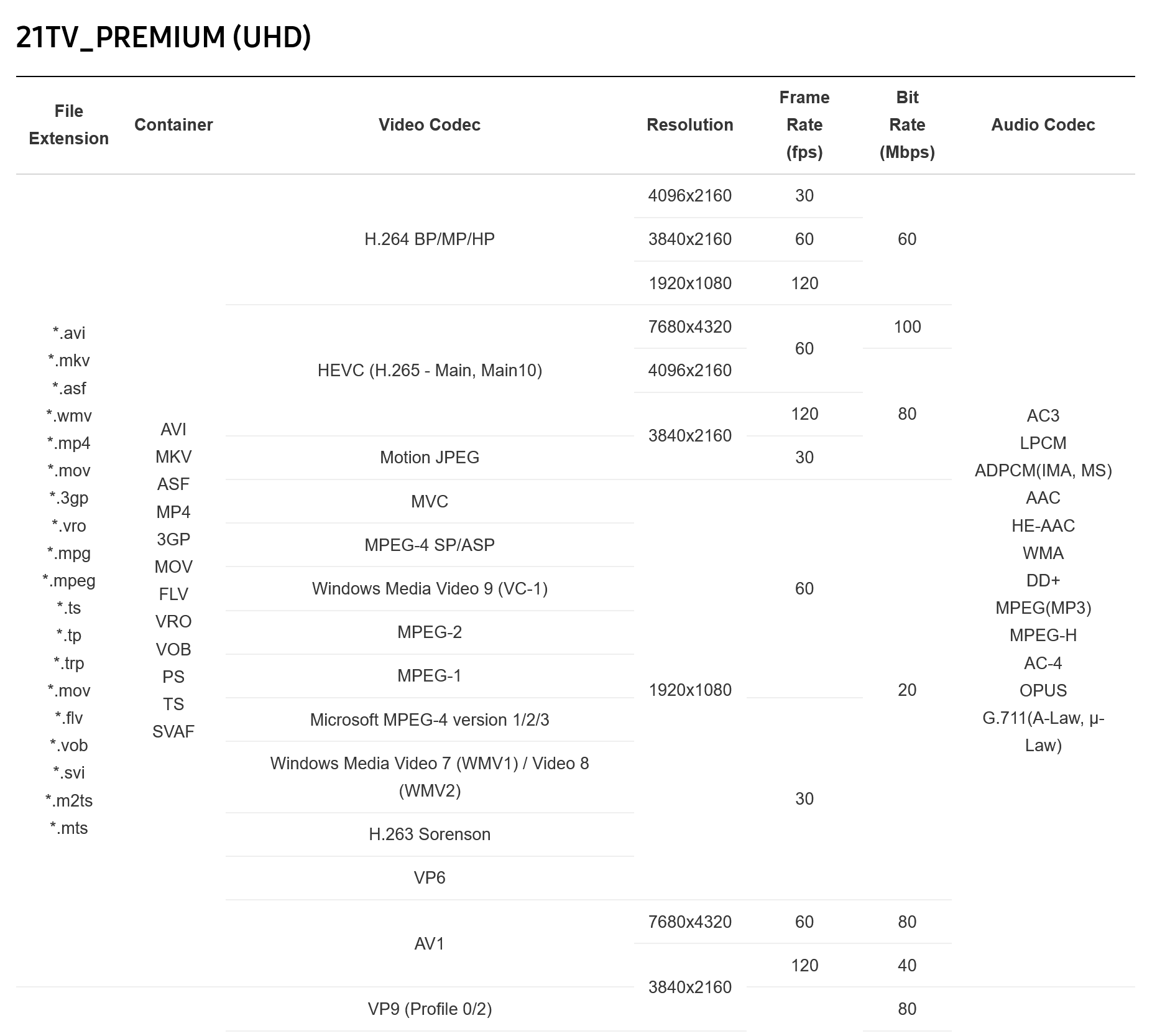

SamES 1004 Posted January 27 Posted January 27 2 hours ago, pektoral said: Hi olli14, same problem here, but i know what is the problem. On some cheap samsung tv´s there is no playback for 50 frames movies of the german tv station. Just check your tv information, emby is doing everything well in this case. You could just convert to 25 frames, but this is causing very bad quality and bucking. Kind regards, pektoral Thanks for providing this information. That is good to know. @olli14for reference, this is the codec matrix from Samsung. https://developer.samsung.com/smarttv/develop/specifications/media-specifications/2021-tv-video-specifications.html I think that your model is a 21TV_BASIC1, but as @pektoralhas pointed out. Samsung does release certain models in different markets and for suppliers that is further restricted, and even for ‘normal’ models, this matrix isn’t always 100% reliable. The ‘DirectPlayError’ is triggered when the TV can’t playback the original file using the player that is available to apps, in which case we will try and transcode the video to make it playable. In this case, we can’t ‘fix’ anything to make it work, but if you can narrow down and prove that it is the framerate, or some other parameter then you could manually convert them to avoid this error.

olli14 2 Posted January 27 Author Posted January 27 Hi pektoral the file with vp9 and 50 frames (your link) also doesn't work. 1. At the moment I can say that all mp4 files I have tested so far and which don't play with Embny have frame rate 50. BUT: when I put these files (with frame rate 50) on an usb stick every file plays fine with the internal media player of my Samsung tv. 2. At the moment I can say that all mp4 files I have tested so far and which play with Emby have frame rate 25. 3. So it seems that it is not "bit rate mode = variable". Something that I absolutely don't understand: does Samsung really limit the functionality of the player that is made available to apps like emby so that the player has not the full capability? It seems to be like that. But WHY? So it seems that I have no chance to play these "frame rate 50" mp4 files with emby!? 1
pektoral 22 Posted January 28 Posted January 28 10 hours ago, olli14 said: Hi pektoral the file with vp9 and 50 frames (your link) also doesn't work. 1. At the moment I can say that all mp4 files I have tested so far and which don't play with Embny have frame rate 50. BUT: when I put these files (with frame rate 50) on an usb stick every file plays fine with the internal media player of my Samsung tv. 2. At the moment I can say that all mp4 files I have tested so far and which play with Emby have frame rate 25. 3. So it seems that it is not "bit rate mode = variable". Something that I absolutely don't understand: does Samsung really limit the functionality of the player that is made available to apps like emby so that the player has not the full capability? It seems to be like that. But WHY? So it seems that I have no chance to play these "frame rate 50" mp4 files with emby!? Hi Olli, i have checked your tv playback capabilities, you should be able to play up to 60 frames. (see my picture included) So the problem on your side should not be the framerate limit of some samsung tv´s. My guess is still the variable bitrate...could you provide a small sample? If you want a quick solution without reencoding just use a firestick with the emby android app. Kind regards, pektoral
SamES 1004 Posted January 28 Posted January 28 21 hours ago, SamES said: I think that your model is a 21TV_BASIC1, but as @pektoralhas pointed out. Samsung does release certain models in different markets and for suppliers that is further restricted, and even for ‘normal’ models, this matrix isn’t always 100% reliable. Please note my previous comment - just because it's in the matrix, it doesn't mean it will play. To clarify, we pass the file url directly to the Samsung avplayer. Aside from setting the player dimensions, there are no parameters to be set. We don't set fps, bitrate or any other parameters. The player will try and play it and if successful, then all good. If it does not, then it will throw an error and we handle it as best we can. If we know that the file is not compatible (using the matrix as a guide) then we won't attempt to DirectPlay, we will convert the video or audio as necessary.
