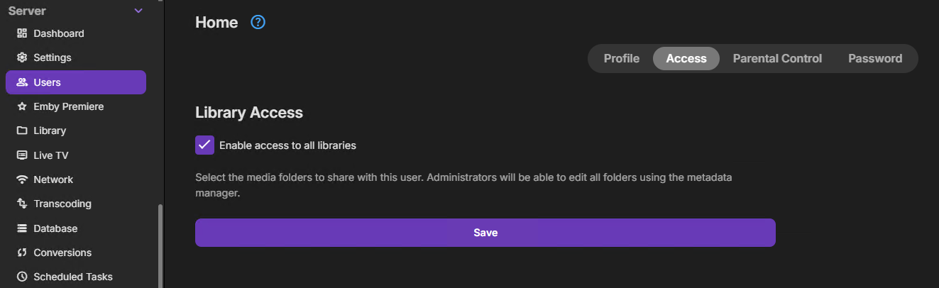

rbjtech 4996 Posted January 11 Posted January 11 If you are 100% sure the passwords are good (they are case sensitive) - ensure 'Device Access' is set to 'All' in the users profile. You may be restricting it to only existing devices ?
Raptor6L 28 Posted January 11 Author Posted January 11 Hi rbjtech Definitely sure the passwords are correct.110%. Where exactly is that "device access" option? I've searched high and low in Emby Server\ Users for it, but cannot locate it in either user profile.
seanbuff 1147 Posted January 11 Posted January 11 1 hour ago, Raptor6L said: Where exactly is that "device access" option? I've searched high and low in Emby Server\ Users for it, but cannot locate it in either user profile. Scroll to the very bottom of the 'Access' tab of each user profile.

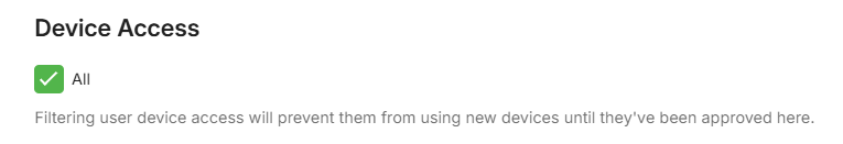

Raptor6L 28 Posted January 11 Author Posted January 11 9 hours ago, seanbuff said: Scroll to the very bottom of the 'Access' tab of each user profile. I've only got 1 option to tick in the access tab:
