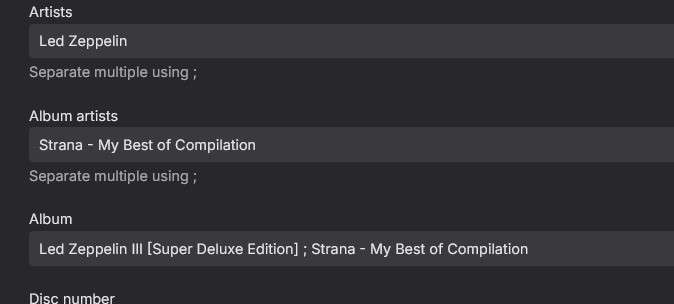

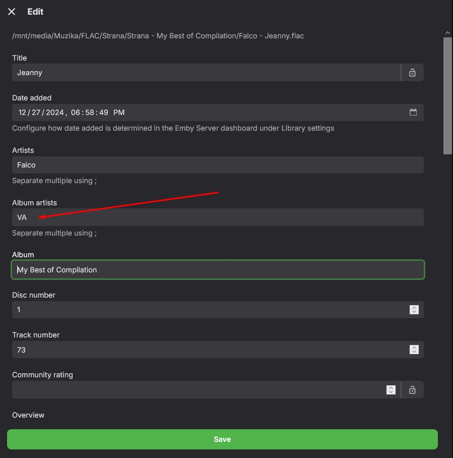

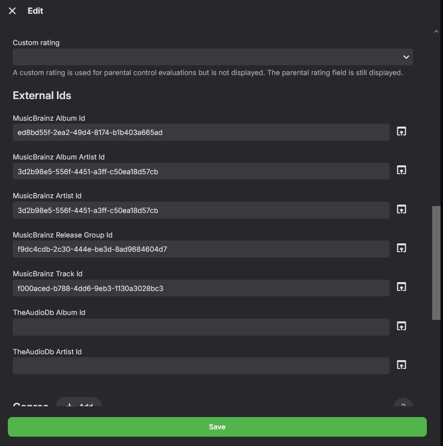

Nabukodonosor 13 Posted December 31, 2024 Posted December 31, 2024 Hey guys. So I'm trying to make a music compilation from bunch of songs by various artists, to play it with the Symphonium app. With albums it works great, but not that ideal with compilations. So, the manual says: "Tagging your albums and tracks should be straightforward with the possible exception of various artist or compilation albums. For these types of compilation albums if you want all tracks to show up as a single entity you want to make sure both the "album" and "album artist" fields are the same for all tracks. Otherwise the album will be split up for the various artists listed." I did that, using a tagging software, for both album and album artist I put "My compilation", and it works...but the thing I really don't like is the field below the song name where for the album says "My compilation". Is there a way to fix this because I would really like to know from which album is the song? And the 2nd issue...I tag my songs, but Emby server pulls external IDs, like on my screenshot below, and ruins everything, because after that, every song is presented like a single album. Also, for some songs, my album and album artist fields get changed too. I tried checking "Lock this item to prevent future changes" but that gets unchecked after the next server syncing. Any ideas how to fix these issues?
user24 245 Posted December 31, 2024 Posted December 31, 2024 (edited) Hi, for your first question here are a few thoughts... The Album field in Emby will accept multiple values/tags. Therefore you could potentially tag a compiled group of Songs as (e.g.): Song 1 Album: My Compilation ; Original Album 1 Song 2 Album: My Compilation ; Original Album 2 I did a very quick test (importing from Mp3tag) with these Emby results: Sorry, I can't check Symphonium as I don't use it (and I don't have time for extensive testing right now). Therefore you may need to test this out yourself to see how it impacts on the rest of your Emby library with Albums, etc. but you should be able to retain your Compilation as a whole Album. Does Symphonium read Emby Playlists? If you have these songs on the original albums within Emby already, have you thought about creating compilation playlists rather than the compilation album approach? Even if they are just individual songs you have in a folder, you could still possibly create a Playlist rather than an Album??? Also, have you investigated Collections at all? There may be a good combination of Album tagging, Playlists and/or Collections that could give the result you are after? Sometimes it takes a bit of experimenting... Cheers! Edited December 31, 2024 by user24

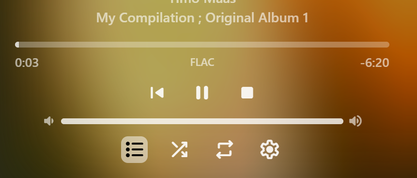

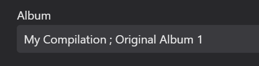

Nabukodonosor 13 Posted January 1 Author Posted January 1 Also, that multiple tag with ; didn't work, because Emby doesn't support multiple tags for album...only album artists. In your case, it just named the album "My Compilation ; Original Album 1"
