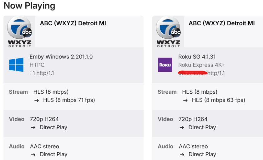

Chillout 102 Posted December 24, 2024 Posted December 24, 2024 My new Windows Emby app has been experiencing more frequent live TV (IPTV) faults where the broadcast immediately ends and kicks me back to the guide than when I was using the Theater App over the past couple years. Not sure if its the new app, i started watching the live tv channel on the Emby app while watching the same channel using the web app. The new Emby Windows app stops but the Web app keeps playing, so I'm thinking maybe its an issue with the WIndows app? Anyone else experiencing more issues with live tv and the new app?

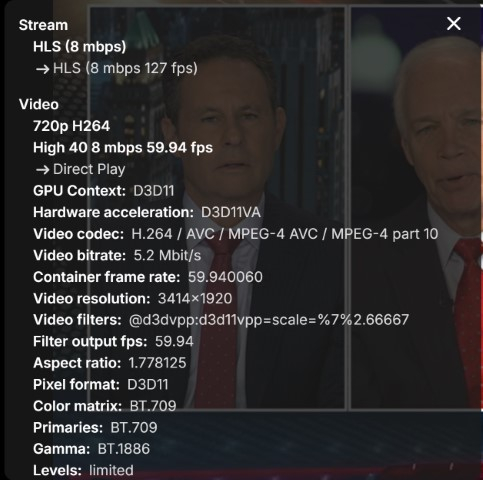

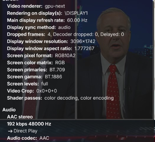

Guest Posted December 24, 2024 Posted December 24, 2024 Try setting it to energy efficient. And maybe post a screenshot of the stats while playing.

Guest Posted December 24, 2024 Posted December 24, 2024 That looks good. The mpv log should provide more information.

Chillout 102 Posted December 24, 2024 Author Posted December 24, 2024 (edited) Emby Windows stopped playback at around 9:22 mark while the Roku kept playing. (note, host server website address is included in the EmbyClient.txt log -- I edited it out but it should be sanitized IMO) 2024-12-23 20:28:42.583 Info ConnectionManager: [ApiClient] Successfully reached server at https://hostip.com mpv-20241223T210554721.txt EmbyClient.txt Edited December 24, 2024 by Chillout

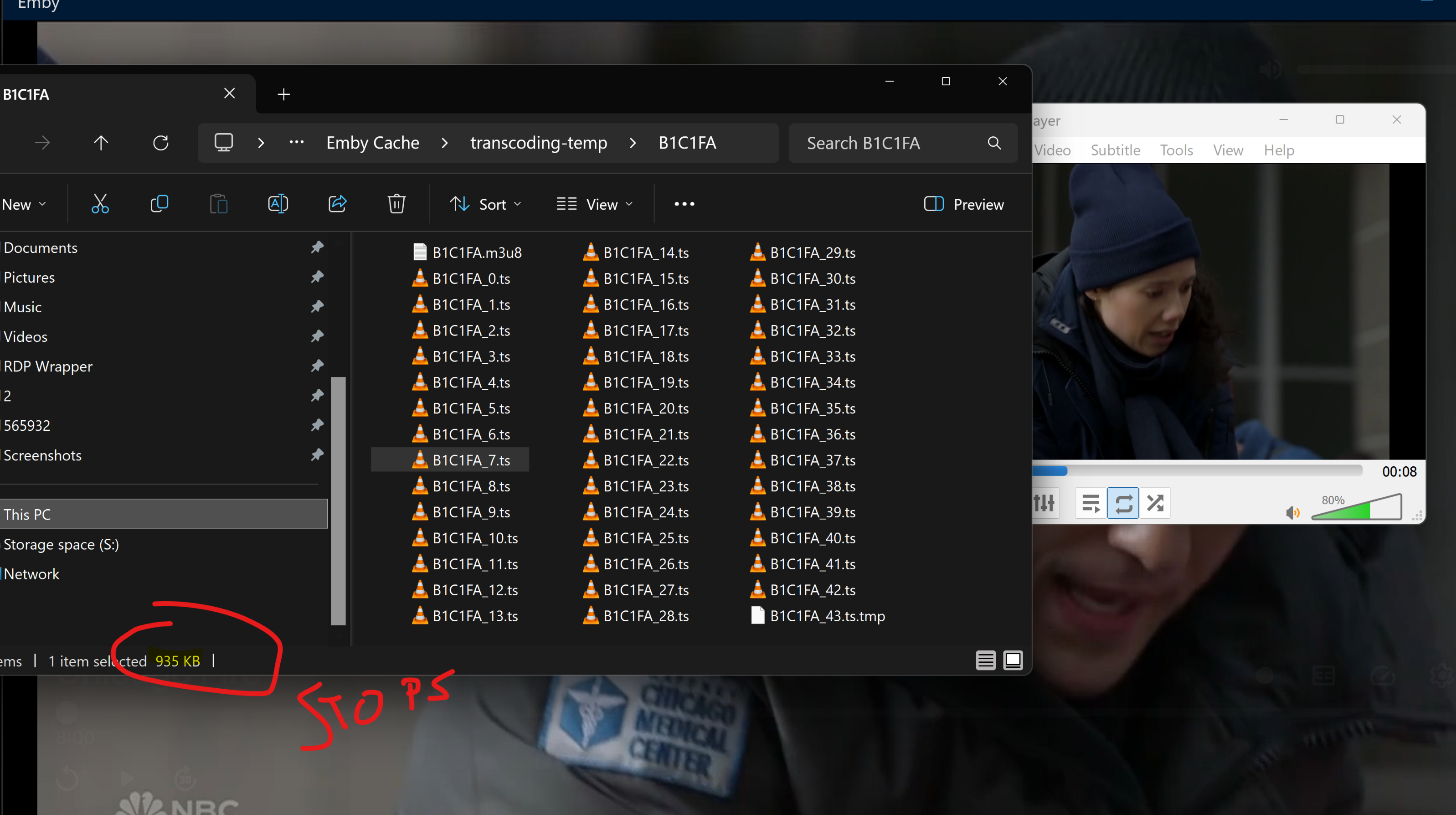

Chillout 102 Posted January 30 Author Posted January 30 (edited) That doesnt seem to help... I paused live TV the entire time while watching the transcoding folder add the .ts files until they all disappeared after about 100 segments. I'm assuming thats when it stopped and cleaned itself up. I dont know if its any significance, but the M3U that works has larger .ts files than the one that doesnt. Edited January 30 by Chillout
softworkz 4836 Posted January 30 Posted January 30 21 minutes ago, Chillout said: That doesnt seem to help... I paused live TV the entire time while watching the transcoding folder add the .ts files until they all disappeared after about 100 segments. This doesn't sound like what I've been asking for...

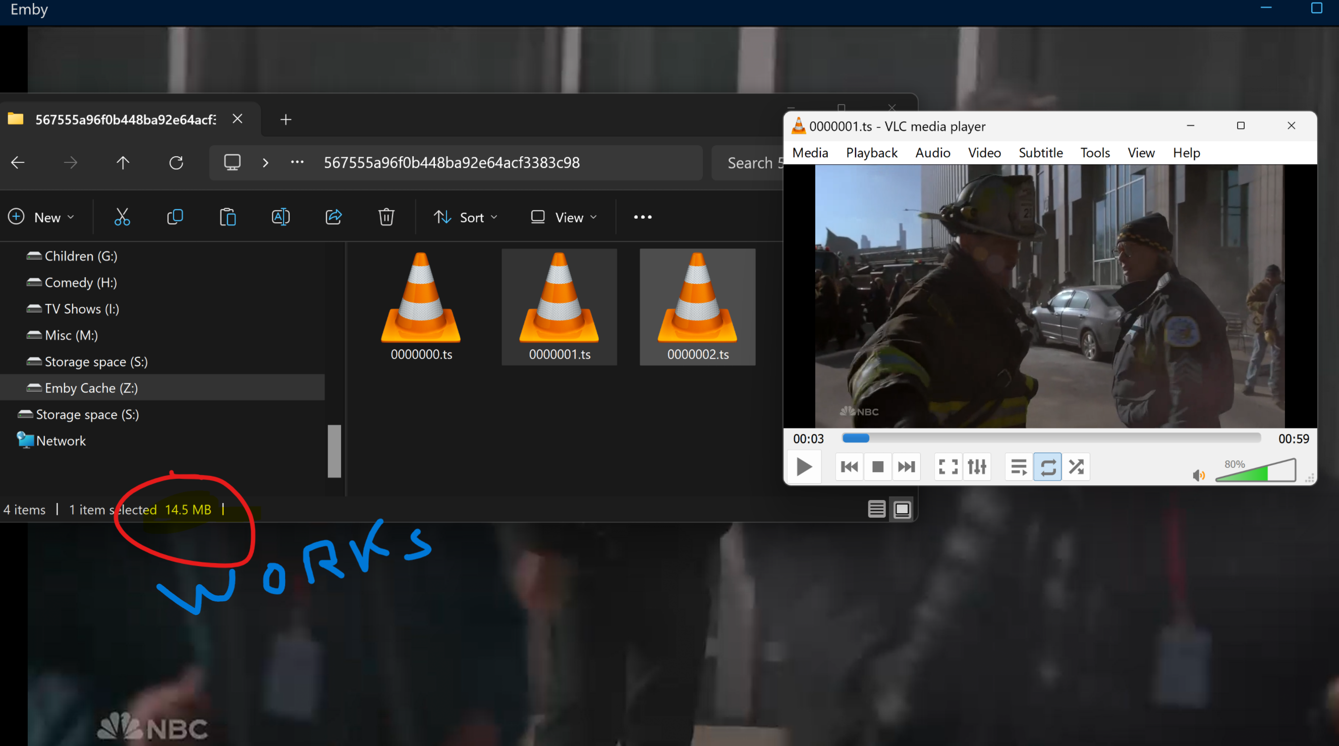

Chillout 102 Posted January 30 Author Posted January 30 Sorry, the first time I played, paused for 60 sec, then resumed playback. It stopped and returned me back to the guide after 10min.
