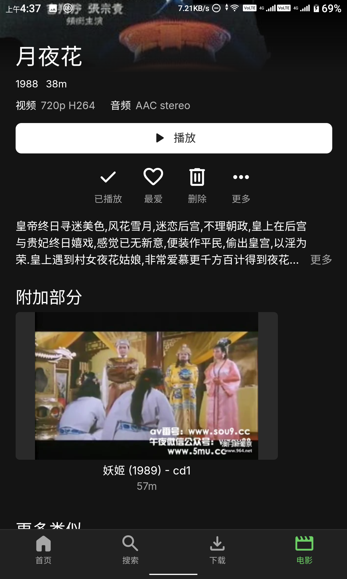

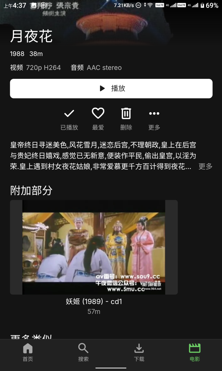

bfogdb20825 2 Posted December 22, 2024 Posted December 22, 2024 My device is Synology DS220+. The installed version is the one from the Package Center, and its version number is 4.8.10.0 - 724081000. The problem I'm currently having is that the additional parts of Split video files (file stacking) are out of order. I've read https://emby.media/support/articles/Movie-Naming.html in detail. And I've tried various segment names as guided, such as 1>2>3, a>b>c, part#, cd#, dvd#, pt#, disk#, disc#. You can also use: moviename#.ext Where # can be A through D. Examples: \Movies\Avatar (2009)\Avatar (2009)-cd1.mkv \Movies\Avatar (2009)\Avatar (2009)-cd2.mkv I've also tried sorting the APP page, file names, and titles in both ascending and descending order. However, the additional parts are still out of order. Moreover, I've tried putting multiple different movies' cd1/cd2 in the same folder. I found that sometimes the additional parts of the same movie couldn't be recognized as belonging to one movie but were recognized as two separate movies instead. Later, after I strictly followed the guidance to create new folders and place them in, this phenomenon disappeared. But their order is still chaotic! Finally, I tried Jellyfin. I found that these phenomena were normal with it. It can recognize them properly under any circumstances embyserver.txt

bfogdb20825 2 Posted December 22, 2024 Author Posted December 22, 2024 1 hour ago, Happy2Play said: Can you remove this content do full scan, then readd it as I am looking of "Debug App: Found extra AdditionalPart" login like shown in linked topic above. Or if you have a different movie you can add. Yes this is the recommended method these days as not all clients will automatically play second part. I have already tried deleting the media library and re-adding it, and added spaces before and after the " - " in the file names, but they are still out of order. The file name is "妖姬". Another thing is that I hope Emby can automatically stack all the movies' CD1/CD2 in the same folder just like Jellyfin does, instead of requiring me to create a new folder for each movie to organize them. Currently, the situation is chaotic. Some are successfully stacked but in a disordered manner, and some are even split into two independent movies. embyserver (4).txt

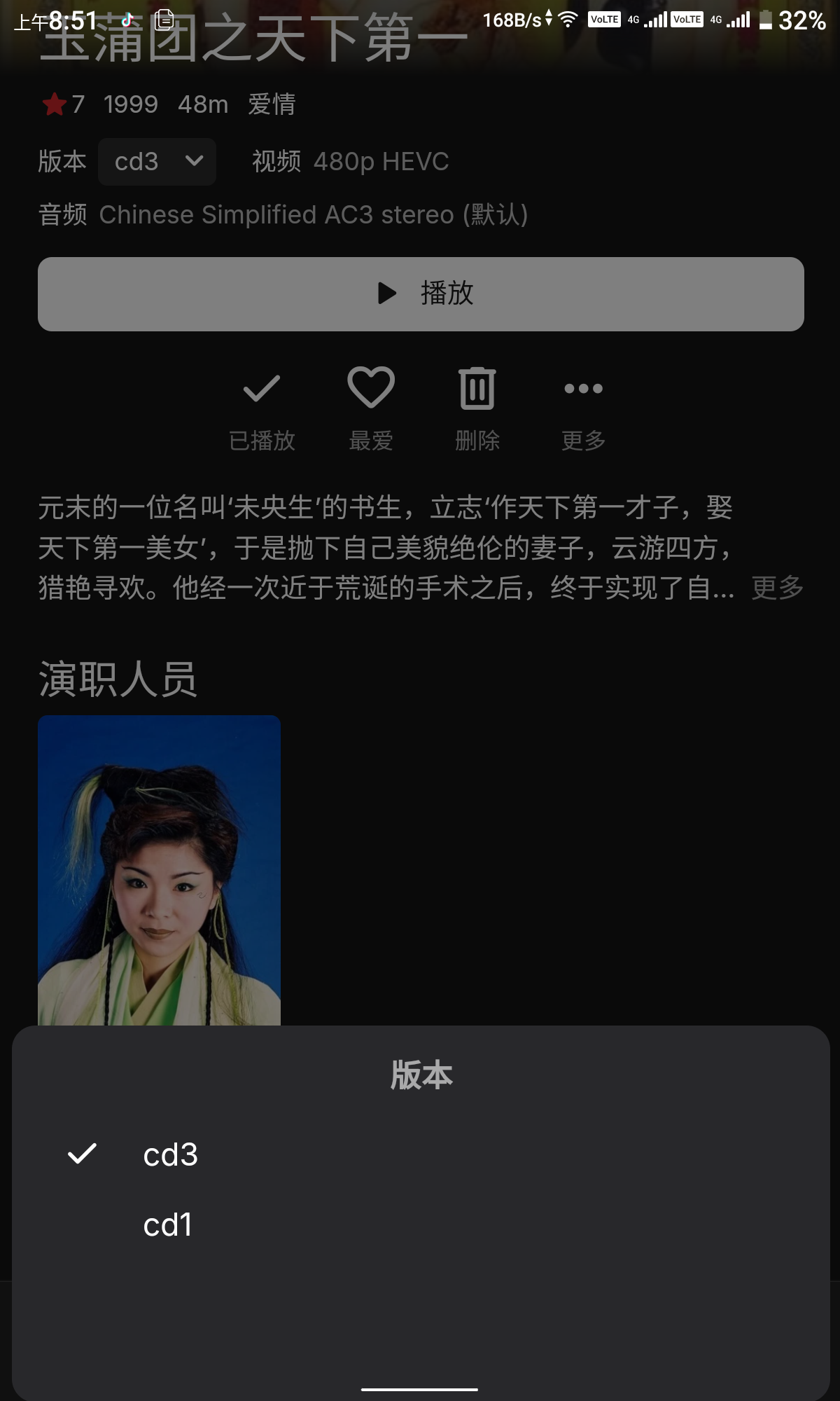

bfogdb20825 2 Posted December 29, 2024 Author Posted December 29, 2024 8 hours ago, Luke said: @bfogdb20825can you please provide a specific example? How are those files named and organized? Please provide exact examples. Thanks ! When I upgraded to the latest beta version 4.9.0.34 and named and sorted strictly according to the guidelines, it has been working properly. Examples: \Movies\Avatar (2009)\Avatar (2009)-cd1.mkv \Movies\Avatar (2009)\Avatar (2009)-cd2.mkv However, if all the movies with cd1/cd2 are put into one folder, the sorting is still chaotic and many files won't be stacked. I hope this problem will be improved in the future. Examples: \Movies\Avatar (2009)-cd1.mkv \Movies\Avatar (2009)-cd2.mkv \Movies\text(2009)-cd1.mkv \Movies\text(2009)-cd2.mkv

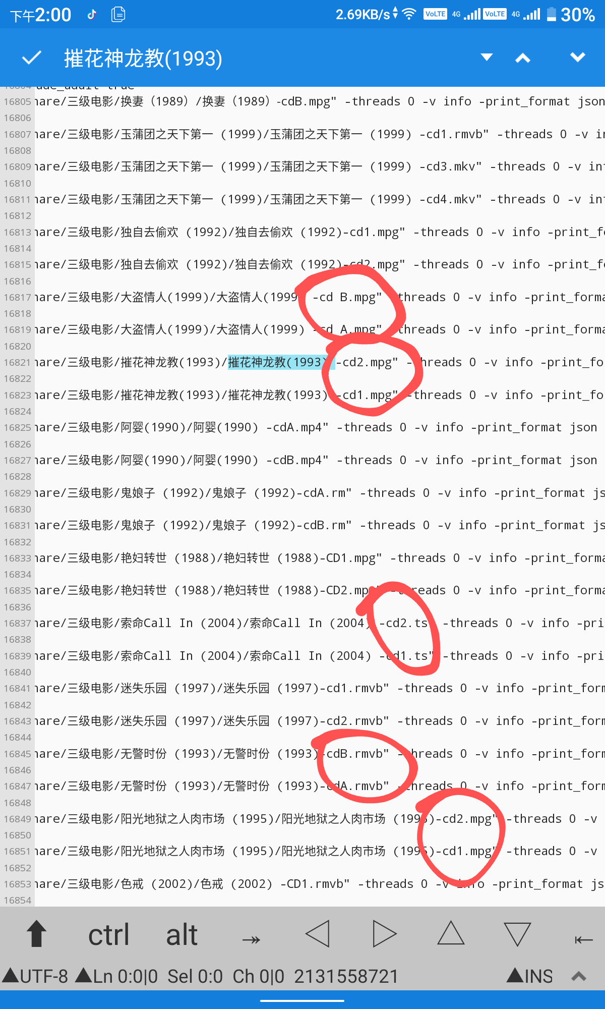

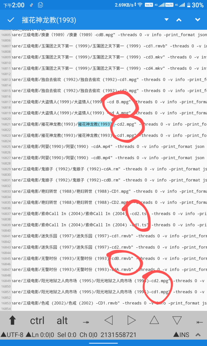

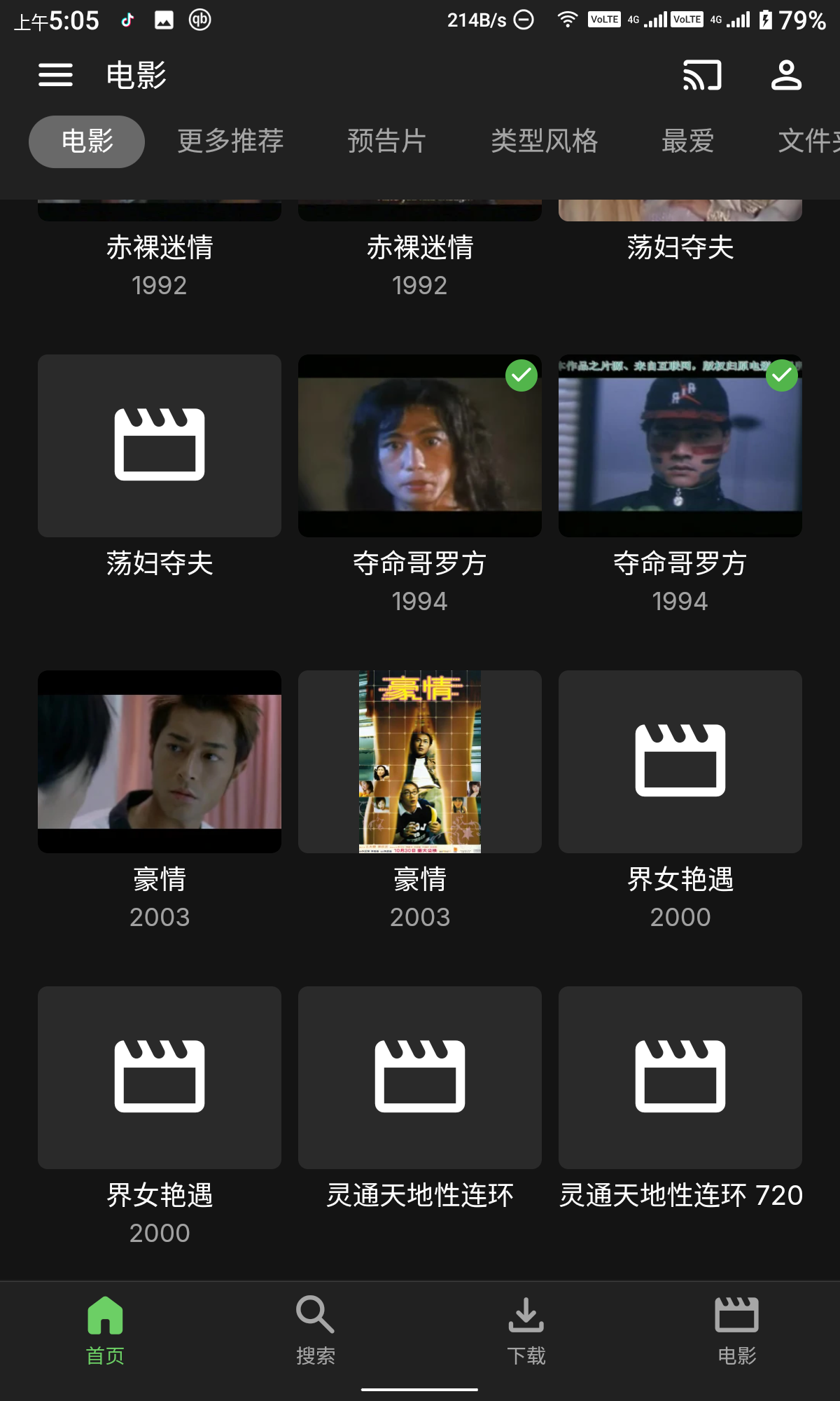

bfogdb20825 2 Posted December 29, 2024 Author Posted December 29, 2024 44 minutes ago, Luke said: 好,我们来看看这个。谢谢。 After I tested that the new version was normal, the file names became disordered again after migration. The name is 摧花神龙教(1993) .mpg. file:"/volumeUSB2/usbshare/三级电影/摧花神龙教(1993)/摧花神龙教(1993) -cd2.mpg" -threads 0 -v info -print_format json -show_streams -show_chapters -show_format -show_data 2024-12-29 13:45:23.083 Info MediaProbeManager: ProcessRun 'ffprobe' Process exited with code 0 - Succeeded 2024-12-29 13:45:23.091 Info MediaProbeManager: ProcessRun 'ffprobe' Execute: /var/packages/EmbyServer/target/bin/ffprobe -i file:"/volumeUSB2/usbshare/三级电影/摧花神龙教(1993)/摧花神龙教(1993) -cd1.mpg" -threads 0 -v info -print_format json -show_streams -show_chapters -show_format -show_data 2024-12-29 13:45:23.107 Info MediaProbeManager: ProcessRun 'ffprobe' Process exited with code 0 - Succeeded embyserver (7).txt
bfogdb20825 2 Posted December 29, 2024 Author Posted December 29, 2024 55 minutes ago, Luke said: OK we'll take a look at that. Thanks. The ones in reverse order in the log are disordered. The problem remains the same.
Happy2Play 9442 Posted December 29, 2024 Posted December 29, 2024 As mentioned debug logging would show this better. As the probe order doesn't tell us the "Debug App: Found extra AdditionalPart" order. As your image is actually just it probe sometimes the first file and sometimes not. So are all the ones that are probed in the correct order displayed properly? 1

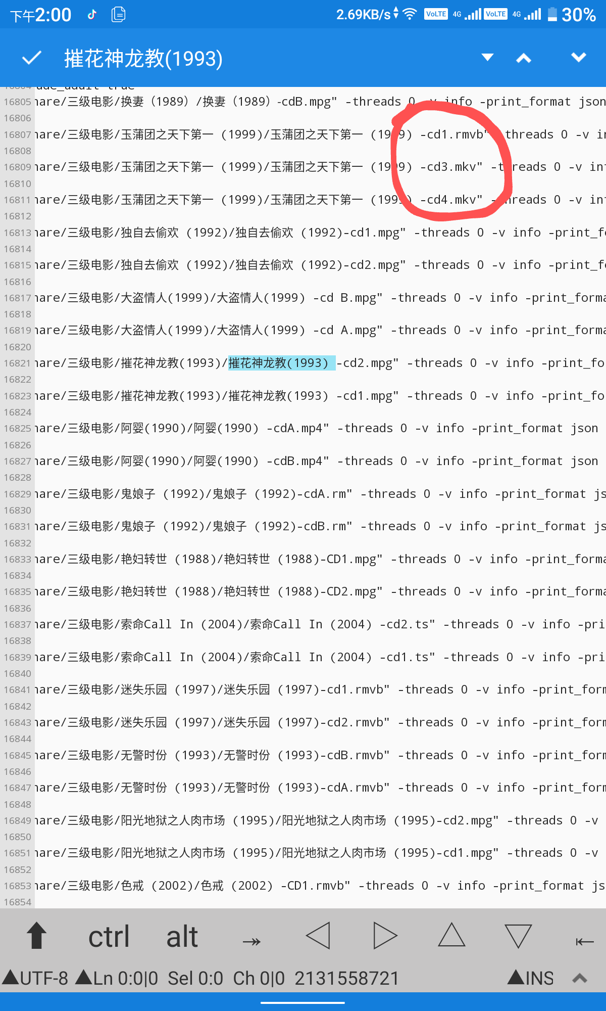

bfogdb20825 2 Posted December 30, 2024 Author Posted December 30, 2024 8 hours ago, Happy2Play said: As mentioned debug logging would show this better. As the probe order doesn't tell us the "Debug App: Found extra AdditionalPart" order. As your image is actually just it probe sometimes the first file and sometimes not. So are all the ones that are probed in the correct order displayed properly? Yes. The content displayed in the log in positive order is indeed in positive order, and the content displayed in the log in reverse order is also in reverse order. However, when the file extension suffixes are different, they will not be stacked and there will be omissions when scanned. 1
