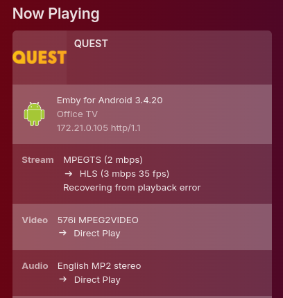

GrumpyNick 2 Posted December 23, 2024 Author Posted December 23, 2024 Okay then here goes! On Google TV device/Nvidia Shield/Android Phone when I go to watch some channels like "Quest" which is channel 12 on Freeview for me in the Midlands, UK it takes just over a minute to actually show the channel. During this minute the Emby dashboard shows no activity, then just after a minute I see activity on the dashboard and it has "Recovering from playback error" at the bottom of the "stream" section, screenshot attached. On all devices I am using the what I believe is classed as the "Universal" Android app so not the dedicated Android TV one. Emby server is hosted in a Proxmox LXC with Nvidia pass-through working on an Quadro P4000. Clients and server are on different subnets, everything else Emby works beautifully. As to add from before I don't get this issue if using Emby Theatre on my Kubuntu device. ffmpeg-directstream-5fa8abce-506c-47b9-af19-30b09fdbeb6d_1.txt embyserver.txt
Carlo 4552 Posted December 28, 2024 Posted December 28, 2024 Hi, Hi, does this only happen on Quest? I noticed in the ffmpeg log there is a huge offset between the video and audio channels of 780ms or more than 3/4 of a second. The HLS segment length being used is 3 seconds so the offset itself is roughly 1/4 of the segment. In your app setting in the subtitle menu, try setting the subtitle mode to "no subtitles" and see if that helps at all. Try the above and send another set of logs after, if it didn't help. Carlo
