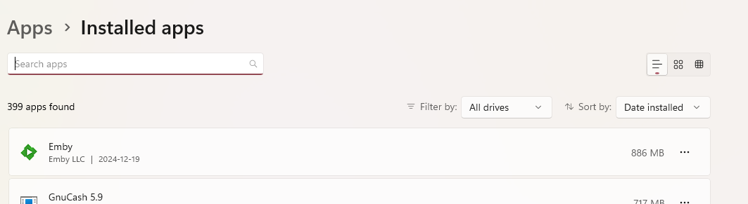

softworkz 4570 Posted December 19, 2024 Posted December 19, 2024 2 hours ago, DarWun said: Yesterday the Windows Store updated Emby Theatre Desktop to the new app. When I click on the icon in my start menu, nothing happens. When I try to open the app from the Windows Store, nothing happens. If found the location where the app was installed. But I have not found any logs that I can upload to help with troubleshooting the issue. Can you see it under Settings >> Apps >> Installed Apps? Please uninstall from there and then reinstall from the store.
DarWun 310 Posted December 20, 2024 Author Posted December 20, 2024 4 minutes ago, softworkz said: Can you see it under Settings >> Apps >> Installed Apps? Please uninstall from there and then reinstall from the store. Thanks for responding @softworkz. Yes, I can see it under installed apps. I had uninstalled it and reinstalled it before I posted. Nothing changed. I just uninstalled and reinstalled it again after you responded. No change.

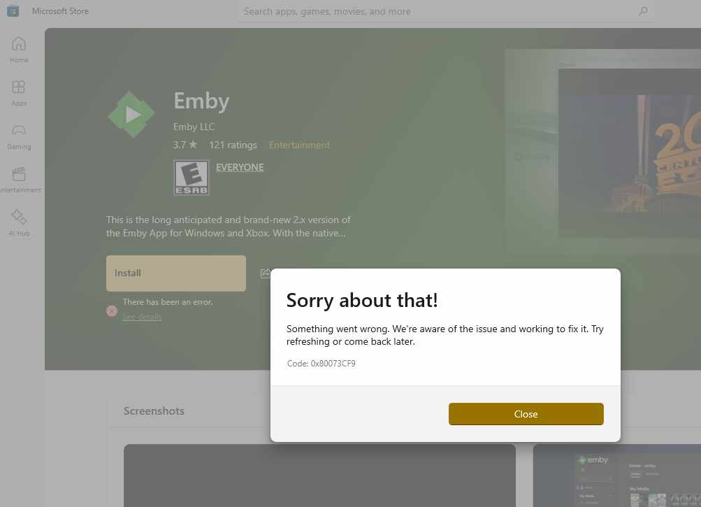

visproduction 283 Posted December 20, 2024 Posted December 20, 2024 FYI: New Emby install works fine on Win 10 64bit, but fails on Win10 32bit. Nothing is installed and no logs to show on the 32 bit workstation. Just the pop-up notice in the store: Sorry about that... Code: 0x80073CF9 Not compatible with 32 bit?
softworkz 4570 Posted December 20, 2024 Posted December 20, 2024 8 minutes ago, visproduction said: FYI: New Emby install works fine on Win 10 64bit, but fails on Win10 32bit. Nothing is installed and no logs to show on the 32 bit workstation. Just the pop-up notice in the store: Sorry about that... Code: 0x80073CF9 Not compatible with 32 bit? There's a 32 bit version which goes through automated testing on each release, same like the 64 bit and the xbox version. Which Win10 versions do you have in both cases?

visproduction 283 Posted December 21, 2024 Posted December 21, 2024 Duplicate answer to the blog on this topic: This workstation with Emby Web up and running already fails to install the new Windows Store Emby Theater. Edition Windows 10 Home Version 22H2 Installed on 4/22/2023 OS build 19045.5247 Experience Windows Feature Experience Pack 1000.19060.1000.0 Emby Web is up and running on this box. Again, maybe you need to actually be admin to install. The other workstation Win 64 latest installs fine. It could also be I may have locked out some Windows store feature. I could try to install something else. Happy to test further, if you don't find a reason.
softworkz 4570 Posted December 22, 2024 Posted December 22, 2024 10 hours ago, visproduction said: Again, maybe you need to actually be admin to install No. 10 hours ago, visproduction said: It could also be I may have locked out some Windows store feature That seems more likely, given the figures of installations and the fact that you're the only having this issue. 10 hours ago, visproduction said: I could try to install something else. Good idea.
visproduction 283 Posted December 22, 2024 Posted December 22, 2024 (edited) sw, MS Store Downloaded and installed Text edit plus. Opened admin access and app install tests OK. --- Tried again new Emby version from store. Same error. Download fails, admin not requested Saved Chrome logs: End of Local State (snips): Quote ... YgAfECjzY7//VIQK0=","saved_system_profile_hash":"A2FC904546E4F20EFCA0911231F8BD6510732E28","stats_buildtime":"1734459675","stats_version":"131.0.6778.205","system_crash_count":0},"unsent_log_metadata":{"initial_logs":{"sent_samples_count":3,"unsent_persisted_size_in_kb":0,"unsent_samples_count":0},"ongoing_logs":{"sent_samples_count":8133217,"unsent_persisted_size_in_kb":0,"unsent_samples_count":0}}},"variations_compressed_seed":"safe_seed_content","variations_country":"us","variations_crash_streak":0,"variations_failed_to_fetch_seed_streak":0,"variations_google_groups":{"Default":[],"Profile 4":[]},"variations_last_fetch_time":"13379356095410451","variations_limited_entropy_synthetic_trial_seed":"8","variations_limited_entropy_synthetic_trial_seed_v2":"5","variations_permanent_consistency_country":["131.0.6778.205","us"],"variations_safe_compressed_seed":"H4sIAAA... ... 8mZxEa22QUA","variations_safe_seed_date":"13379311359000000","variations_safe_seed_fetch_time":"13379356095410451","variations_safe_seed_locale":"en-US","variations_safe_seed_milestone":131,"variations_safe_seed_permanent_consistency_country":"us","variations_safe_seed_session_consistency_country":"us","variations_safe_seed_signature":"MEQCIHXVeP1nKQzws6JYwiD+Wx6c7CWOC2KApk6lKIor3gNLAiBZBC99qGlyOsjeMc7tWyTdB1PEIft/iHGAMCxGNDtiVw==","variations_seed_date":"13379356095000000","variations_seed_milestone":131,"variations_seed_signature":"MEQCIHXVeP1nKQzws6JYwiD+Wx6c7CWOC2KApk6lKIor3gNLAiBZBC99qGlyOsjeMc7tWyTdB1PEIft/iHGAMCxGNDtiVw==","was":{"restarted":false}} Breadcrumbs: ... 0:32:10 Memory Pressure: Moderate 0:32:11 SafeBrowsing.Download.WarningBypassed 0:32:17 Download.Open 0:32:20 Memory Pressure: Moderate 0:32:30 Memory Pressure: Moderate ... Chrome_Debug_log: Quote [6700:11948:1222/074951.687:WARNING:chrome_main_delegate.cc(672)] This is Chrome version 131.0.6778.205 (not a warning) [6700:11948:1222/074951.898:VERBOSE1:statistics_recorder.cc(607)] Collections of all histograms Histogram: Chrome.ProcessSingleton.NotifyResult recorded 1 samples, mean = 1.0 (flags = 0x41) 0 O (0 = 0.0%) 1 -O (1 = 100.0%) {0.0%} 2 ... Histogram: Chrome.ProcessSingleton.TimeToNotify recorded 1 samples, mean = 0.0 (flags = 0x41) 0 -O (1 = 100.0%) 10 ... Histogram: Startup.LoadTime.RecordedProcessCreation recorded 1 samples, mean = 1.0 (flags = 0x1) 0 O (0 = 0.0%) 1 -O (1 = 100.0%) {0.0%} 2 O (0 = 0.0%) {100.0%} Histogram: UMA.PersistentAllocator.BrowserMetrics.UsedPct recorded 0 samples (flags = 0x41) 0 ... Histogram: UMA.PersistentAllocator.EarlyHistograms.BrowserMetrics recorded 1 samples, mean = 1.0 (flags = 0x41) 0 O (0 = 0.0%) 1 -O (1 = 100.0%) {0.0%} 2 ... Histogram: UMA.PersistentHistograms.InitResult recorded 1 samples, mean = 2.0 (flags = 0x41) 0 ... 2 -O (1 = 100.0%) {0.0%} 3 ... Console log error in Chrome inspect: (js location: https://apps.microsoft.com/assets/js/market-collection-service-b97deee3.js) Quote market-collection-service-b97deee3.js:1 Collection MerchandiserContent/Apps/Primary/ExploreAWorldOfMusic/_ExploreAWorldOfMusic was not permitted for US permits @ market-collection-service-b97deee3.js:1 Manifest: property 'start_url' ignored, type string expected. Excerpt from market-collection... js code at apps.microsoft.com class c { constructor(e) { this.collectionIds = e } permits(e) { if (!e) return !1; const t = this.collectionIds.some(s => s.equalsIgnoreCase(e)); return t || console.warn(`Collection ${e} was not permitted for ${n.market}`), t } getHiddenClass(e) { return Array.isArray(e) ? e.every(t => this.permits(t)) ? null : "d-none" : this.permits(e) ? null : "d-none" } getSpotlightCollection() { return this.collectionIds.find(e => e.equalsIgnoreCase(r.MoviesSpotlight) || e.equalsIgnoreCase(r.MoviesSpotlightUS)) } } Hope that helps. Edited December 22, 2024 by visproduction

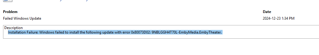

DarWun 310 Posted December 23, 2024 Author Posted December 23, 2024 On 12/20/2024 at 5:20 PM, DarWun said: Thanks @softworkz. As you surmised, disabling the firewall didn't fix the issue. I'll report back after updating to the next version. And I'm posting back. Earlier today, the app updated to 2.204.0. Even though the update notes identified the an error was fixed when trying to start the app when a 3rd party firewall is installed, the Emby app would not start. A few minutes ago, the Microsoft Store updated the app to 2.207.0. After doing so, the app starts. Thanks @softworkz! 1
softworkz 4570 Posted December 23, 2024 Posted December 23, 2024 The 2.204 version has never completed certification, and I doubt that you really had it, because it has the fix included. Anyway, I'm glad to hear that it's fixed. Thanks for confirming! 1
DarWun 310 Posted December 23, 2024 Author Posted December 23, 2024 (edited) 1 hour ago, softworkz said: The 2.204 version has never completed certification, and I doubt that you really had it, because it has the fix included. Anyway, I'm glad to hear that it's fixed. Thanks for confirming! I'm a bit fuzzy as to what the Windows Store updated to be honest. At around 1pm, it updated Emby LLC. I didn't actually see the version number. All I know is when I tried to start the app after that update, it still would not start. When I got home later tonight, the app had been updated again. After that update, the app started. I just assumed it was 2.204.0 earlier today, and then 2.207.0 after that based on the version history listed in the Microsoft Store. Important part, as you say, is that it is working now. And first impressions are extremely positive! edited to add: Okay, I think I get what happened. The earlier install actually failed with the following error. Edited December 24, 2024 by DarWun 1
visproduction 283 Posted December 24, 2024 Posted December 24, 2024 8 hours ago, softworkz said: Chrome logs? Why Chrome logs? Just open the MS Store app, search for Emby and install. Because install never happens, I just get an error notice.
