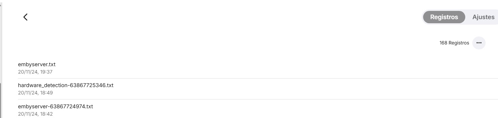

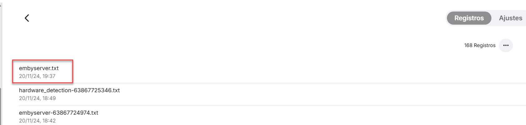

Luke 40063 Posted November 21, 2024 Posted November 21, 2024 10 minutes ago, AngelSing said: Hello, and where can I find this ffmpeg file? How to Report a Problem Same place as those log files.

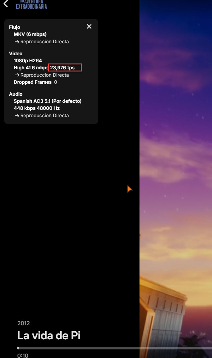

AngelSing 43 Posted November 21, 2024 Author Posted November 21, 2024 10 minutes ago, Luke said: How to Report a Problem Same place as those log files. Are you referring to this file?: One question, is the FPS that appears in statistics for nerds something else?
Luke 40063 Posted November 21, 2024 Posted November 21, 2024 That is the original FPS of the source video, so not an indication of how fast the transcoding is happening.
