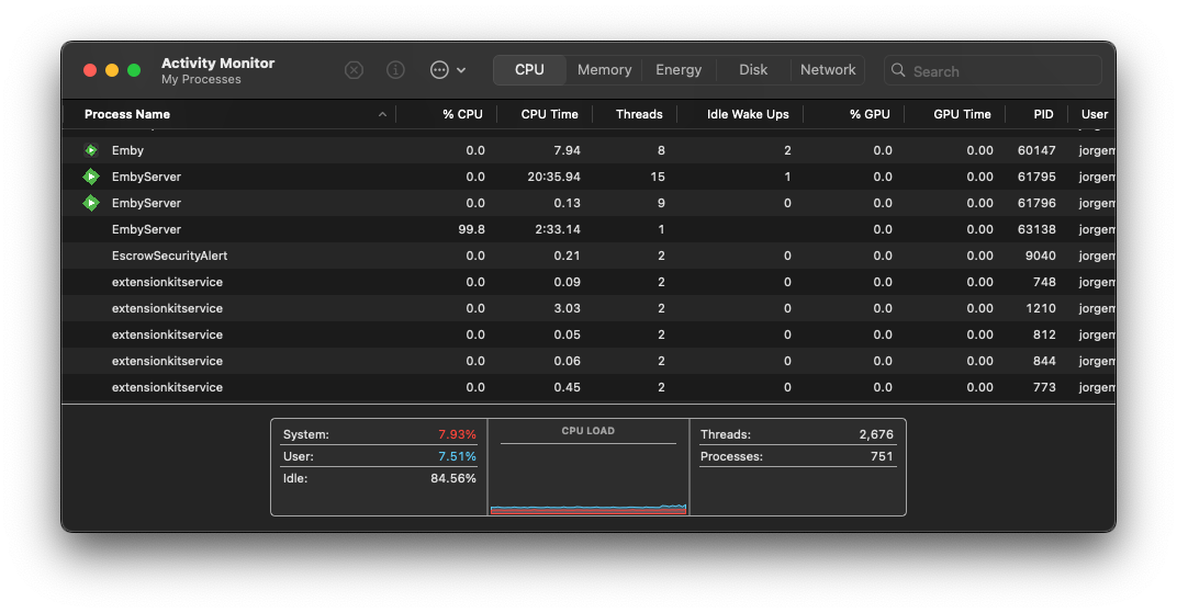

jmariani 21 Posted October 26, 2024 Posted October 26, 2024 Usually, Emby starts two "embyserver" instances on MacOS. From time to time, while scanning a library, a third embyserver instance starts. When this happens, scanning seems to lost track, and the library ends unfinished (see the two tracks to the right) embyserver.txt

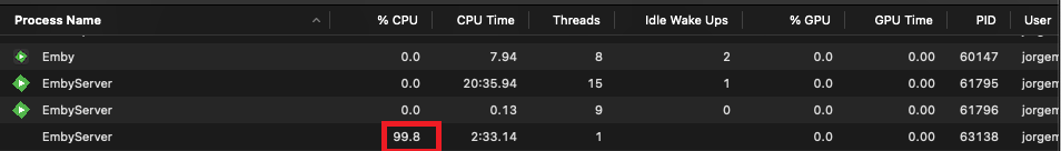

jmariani 21 Posted March 18 Author Posted March 18 Embyserver is running, and I can see two (2) "EmbyServer" running in Activity Monitor Then, I start a Library scan. Emby, after a long while, starts processing files with ffprobe. Sometimes (most of the times) stops processing. This spawns a new "EmbyServer" process and then I can see three (3) "EmbyServer" processes in Activity Monitor. I then kill the three processes, find in the log the offending file, start EmbyServer again and go to "Songs" tab. Find the track, and do a "Refresh metadata". Emby, after a long while, processes the file and after another long while, starts processing pending files. Sometimes this finishes ok, sometimes it stops in another file. Attached log and image. It just happened. And again. embyserver.txt

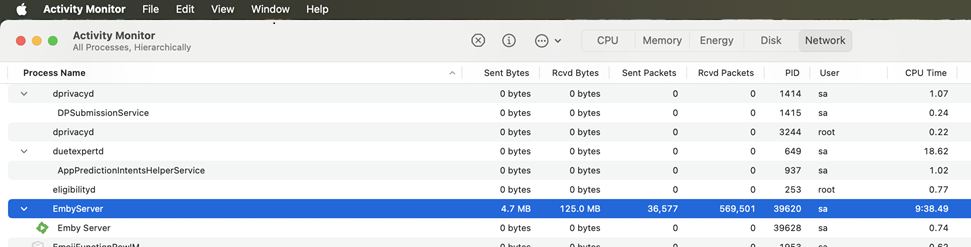

sa2000 424 Posted March 18 Posted March 18 5 hours ago, Luke said: have you seen this before I see a couple of PIDs on my MacBook Pro - and when viewed in ActivityMonitor hierarchically one shows as being the parent 7 hours ago, jmariani said: Sometimes (most of the times) stops processing. This spawns a new "EmbyServer" process and then I can see three (3) "EmbyServer" processes in Activity Monitor The % CPU is high. I wonder if MacOS is restarting the process after attempting to kill it You could look for any crash reports / diagnostics / logs created by MacOS - Open /Applications/Utilties in Finder and open the Console.app and see if there is anything relating to Emby Server in Crash Reports, Diagnostics or system log. Also would like to know how these processes show in Activity Monitor when View All Processes Hierarchically is selected And with processes going back many hours, would be useful to look at the contents of the whole logs folder.

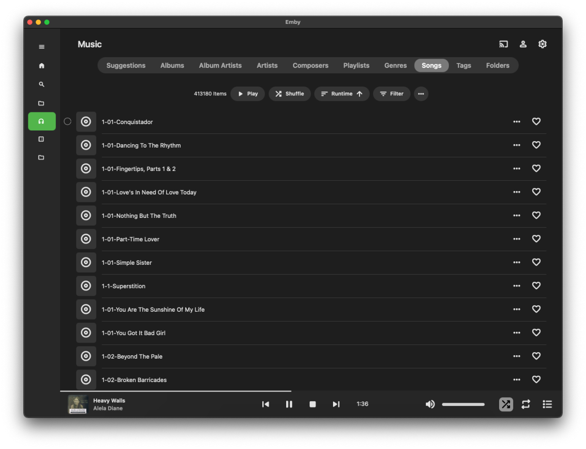

jmariani 21 Posted March 19 Author Posted March 19 (edited) I am able to play songs, see album, song, artists etc. lists. Library scan is disabled (I mean, does not work). Logging doesn't work either. And I can see the unprocessed songs like the image attached. Edited March 19 by jmariani
