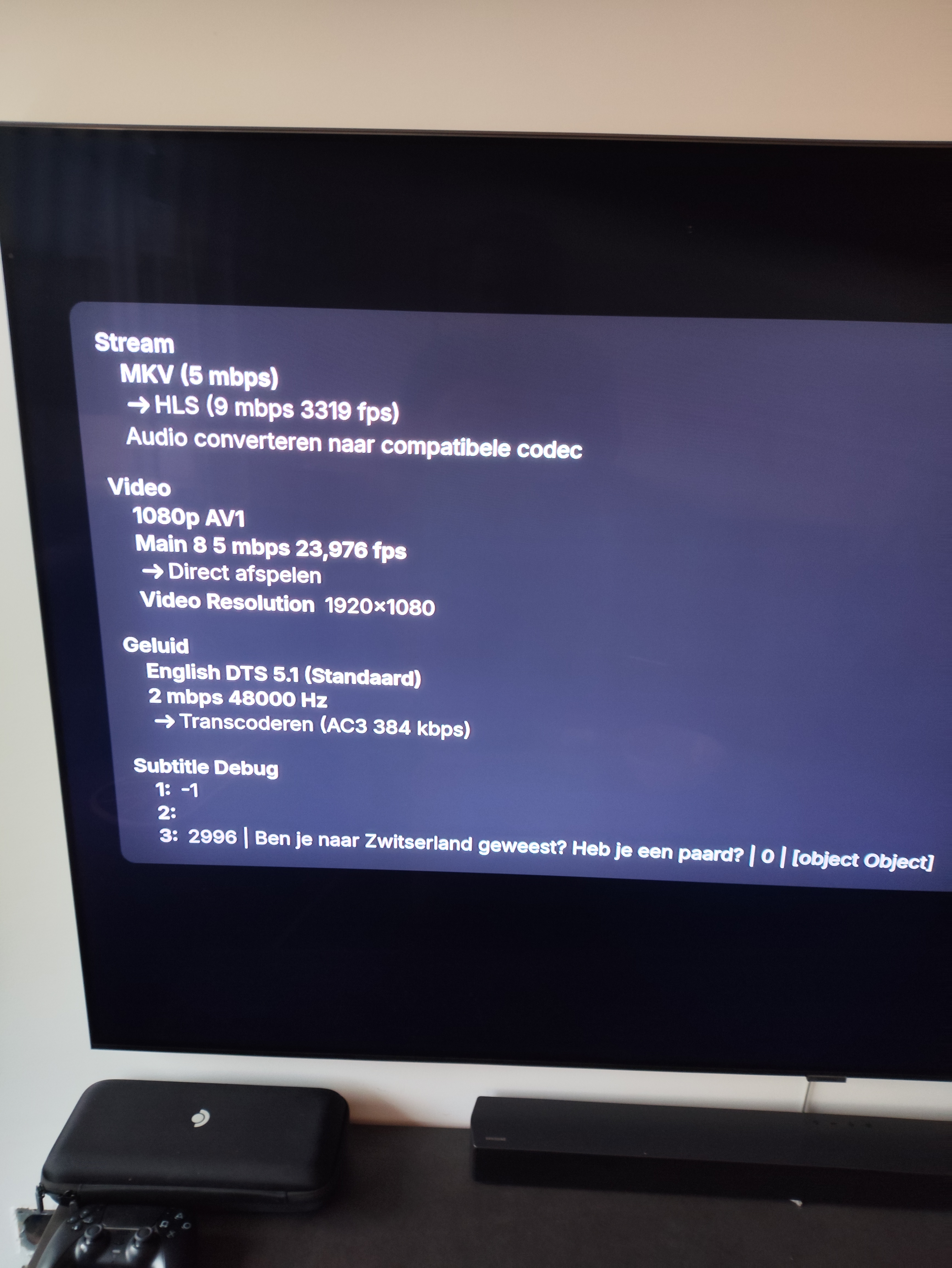

I added the stats for nerds as well so that you can see the exact behavior while playing.

16 hours ago, SamES said:
I suspect the issue here is that DTS audio is causing the audio to be converted, but I'm not sure that av1 is working in the HLS stream with .ts segments that are currently being used.
 @Lukeis this likely the case?  A possible reference here: https://www.reddit.com/r/ffmpeg/comments/13ocph8/hls_segmentation_av1/
You may want to remove AV1 from hls video codecs.

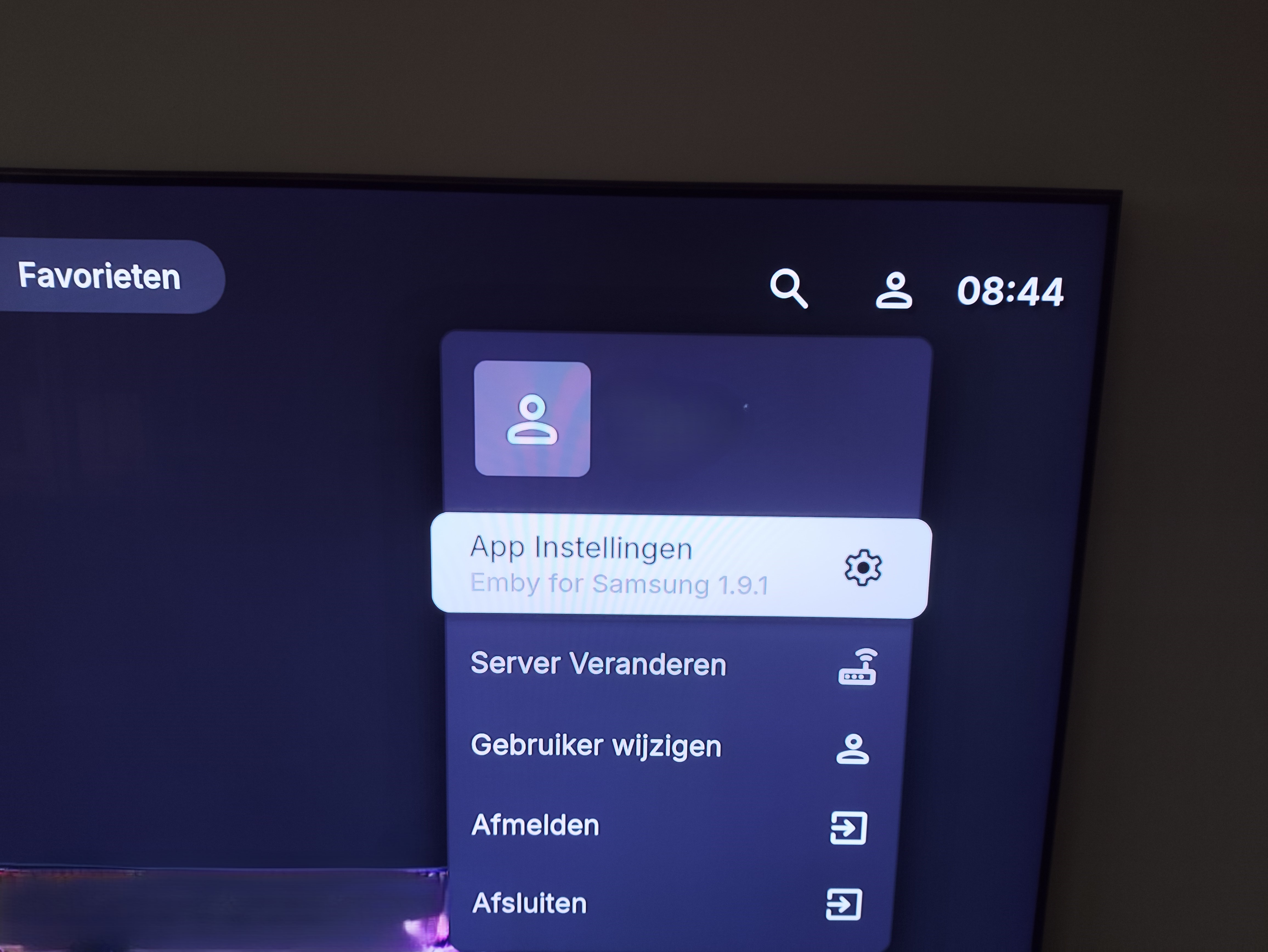

@SamESI have installed 1.9.1 this weekend but I have some bad news.
The issue is still persisting. see below pictures
1731484288488.thumb.jpg.7a10a0b60d61a7c4e4c0f6bdc13d3ff5.jpg1731484288482.thumb.jpg.2d775ac20c1eb8a4a61676a098f05008.jpg
Sorry, it didn't make it into 1.9.1, it came out sooner than I expected.
