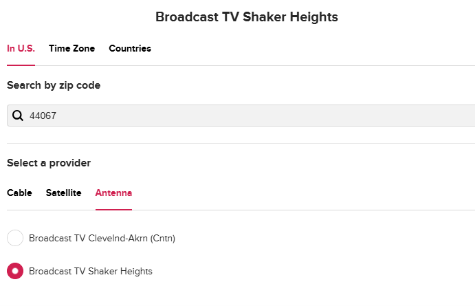

Happy2Play 9458 Posted October 22, 2024 Posted October 22, 2024 (edited) Dev will have to comment as looking at TV Guide for that zip code antenna source has two different listings and the one Emby appears to get doesn't even have those channels ie the Shaker Heights listing. Spoiler <select is="emby-select" class="selectGuideChannel emby-select" label="Guide data channel" id="embyselect76"> <option value="20492">3.1 WKYCDT - NBC</option> <option value="42697">3.2 WKYCDT2 - CRIME</option> <option value="42700">3.3 WKYCDT3 - COZITV</option> <option value="107047">3.4 WKYCDT4 - QUESTSD</option> <option value="118839">3.5 WKYCDT5 - THENEST</option> <option value="122046">3.6 WKYCDT6 - SHOPLC</option> <option value="127864">3.7 WKYCDT7 - QVC</option> <option value="21101">5.1 WEWSDT - ABC</option> <option value="72901">5.2 WEWSDT2 - GRIT</option> <option value="92188">5.3 WEWSDT3 - LAFF</option> <option value="111091">5.4 WEWSDT4 - IONPLUS</option> <option value="118455">5.5 WEWSDT5 - HSN</option> <option value="129850">5.6 WEWSDT6 - QVC</option> <option value="122274">6.1 WTCLLD - TELE</option> <option value="21247">8.1 WJWDT - FOX</option> <option value="70518">8.2 WJWDT2 - ANTENNA</option> <option value="106509">8.3 WJWDT3 - COMET</option> <option value="106510">8.4 WJWDT4 - CHARGE</option> <option value="43687">17.1 WDLIDT - SCNEWS</option> <option value="73020">19.1 WOIOLD - CBS</option> <option value="21320">19.1 WOIODT - CBS</option> <option value="73022">19.2 WOIOLD2 - METVN</option> <option value="54702">19.2 WOIODT2 - METVN</option> <option value="114149">19.3 WOIODT3 - DABL</option> <option value="121077">19.4 WOIODT4 - THE365</option> <option value="34712">21.1 WFMJDT - NBC</option> <option value="46264">21.2 WFMJDT2 - CW</option> <option value="113744">21.3 WFMJDT3 - DABL</option> <option value="64003">23.1 WVPXDT - ION</option> <option value="64298">23.2 WVPXDT2 - COURT</option> <option value="64300">23.3 WVPXDT3 - BOUNCE</option> <option value="64302">23.4 WVPXDT4 - IMYS</option> <option value="82707">23.5 WVPXDT5 - JTV</option> <option value="83505">23.6 WVPXDT6 - QVC</option> <option value="124819">23.8 WVPXDT8 - HSN</option> <option value="44366">25.1 WVIZDT - PBS</option> <option value="46488">25.2 WVIZDT2</option> <option value="57737">25.3 WVIZDT3 - WORLD</option> <option value="57703">25.4 WVIZDT4 - CREATE</option> <option value="102096">25.5 WVIZDT5 - HD06</option> <option value="73448">25.9 WVIZDT9</option> <option value="112488">26.1 WUEKLD - TBD</option> <option value="112489">26.2 WUEKLD2 - NTDA24</option> <option value="112491">26.3 WUEKLD3 - DEFY</option> <option value="112492">26.4 WUEKLD4 - SHOPLC</option> <option value="112493">26.5 WUEKLD5 - SHOPHQ</option> <option value="112494">26.6 WUEKLD6 - TLEX</option> <option value="112495">26.7 WUEKLD7 - CRMES</option> <option value="51535">27.1 WKBNDT - CBS</option> <option value="51557">27.2 WKBNDT2 - FOX</option> <option value="112276">28.1 KONVLD - BEINX</option> <option value="112277">28.2 KONVLD2 - DEFY</option> <option value="112278">28.3 KONVLD3 - BEINSES</option> <option value="112279">28.5 KONVLD5 - QVC</option> <option value="112280">28.6 KONVLD6 - OUTLAW</option> <option value="95763">29.1 WAOHCD - RETROTV</option> <option value="95764">35.1 WOCVCD - CATCHYC</option> <option value="34516">43.1 WUABDT - CW</option> <option value="46950">43.2 WUABDT2 - OUTLAW</option> <option value="74183">43.3 WUABDT3 - OXYGEN</option> <option value="35489">45.1 WNEODT - PBS</option> <option value="35493">45.2 WNEODT2 - CAS</option> <option value="48309">45.3 WNEODT3 - FNX</option> <option value="48311">45.4 WNEODT4 - VME</option> <option value="45659">47.1 WRLMDT - TCTWLD</option> <option value="65427">47.2 WRLMDT2 - TCTHD</option> <option value="71179">47.3 WRLMDT3</option> <option value="44734">49.1 WEAODT - PBS</option> <option value="44737">49.2 WEAODT2 - CAS</option> <option value="49759">49.3 WEAODT3 - FNX</option> <option value="49762">49.4 WEAODT4 - VME</option> <option value="76318">53.1 WCDNLD - DYSTR</option> <option value="55926">55.1 WBNXDT</option> <option value="69574">55.2 WBNXDT2 - BUZZR</option> <option value="75029">55.3 WBNXDT3 - MVIES</option> <option value="98045">55.4 WBNXDT4 - HEROICN</option> <option value="110254">55.5 WBNXDT5 - STARTTV</option> <option value="110255">55.6 WBNXDT6 - BINGE2</option> <option value="42793">61.1 WQHSDT - UNI</option> <option value="85553">61.2 WQHSDT2</option> <option value="85962">61.3 WQHSDT3 - GET</option> <option value="90205">61.4 WQHSDT4 - IMYS</option> <option value="112715">61.5 WQHSDT5 - DABL</option> <option value="122062">61.6 WQHSDT6 - SHOPLC</option> </select> And the channels you listed only appear in the Clevelnd-Akrn listing but have no idea how Emby/Gracenotes differentiate the two local areas per the area code. So it may actually require a different area code to get what you are missing but devs may have to reach out to provider to see what is going on. Edited October 22, 2024 by Happy2Play
eveready1010 0 Posted October 22, 2024 Author Posted October 22, 2024 (edited) Thanks for the reply. I've tried a couple other zip codes but with no luck. Is there some internet service out there that will list area codes for a specific station, so I don't have to keep guessing unsuccessfully? Thank you. [Edit] I should mention that I have 2 antennas combined to 1 hd homerun quad. One pointing northwest, for the cleveland antennas, and the other pointing south for the akron area. This has worked flawless till about a year ago when the other channels started showing up with no data. Most of them still actually do work, just not guide data. Not what happened to cause this. Edited October 22, 2024 by eveready1010 Typed area code instead of zip code. Add more details.
Carlo 4552 Posted October 22, 2024 Posted October 22, 2024 Try picking a city halfway between you and the broadcast tower. Try looking on Zap2it.com for it. If you can't find it try Googling the stationid for a station's website. Many stations have a "where to watch" on the site which will have cable systems and OTA areas with their channel number. It wouldn't hurt to use the contact link on the website or email letting them know you receive the station broadcast OTA but Zap2It.com has no listing.
