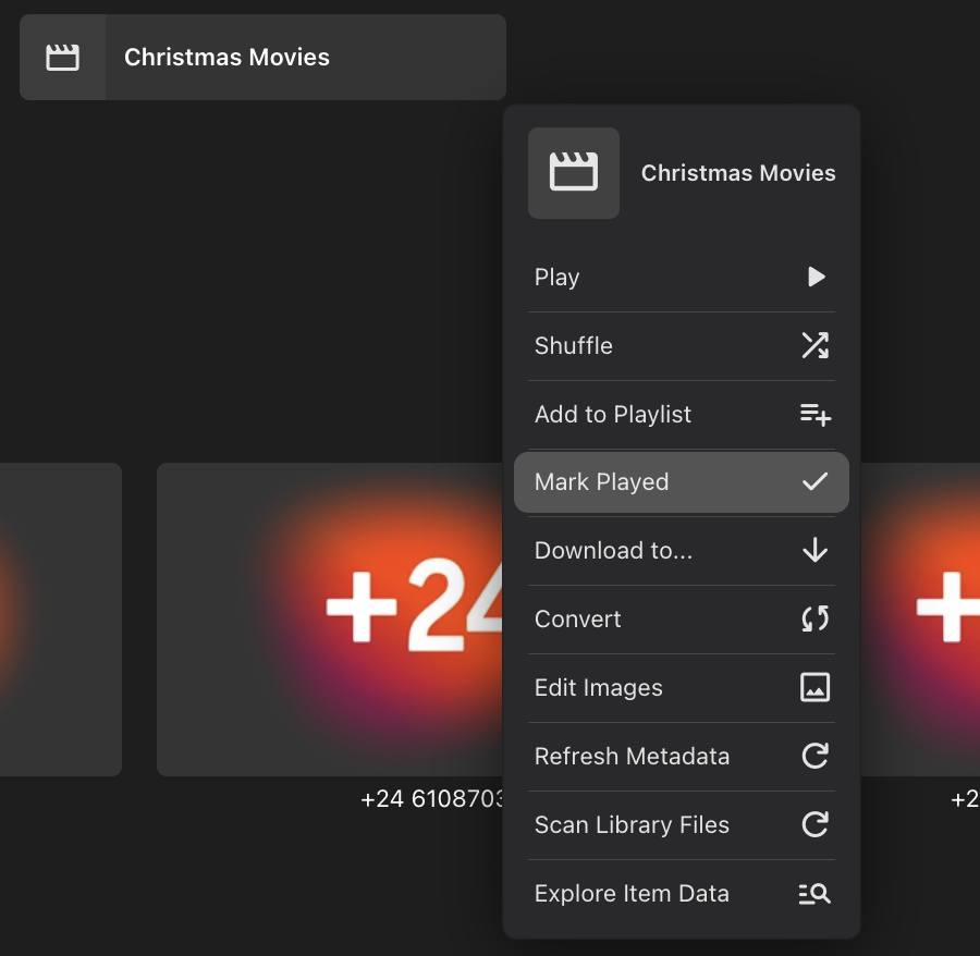

DarkStar1977 93 Posted October 17, 2024 Posted October 17, 2024 @ebr @LukeCould be a simple solution for what @HouseOfCardsis asking without risking the play state and with a minor modification: Let's take the "Christmas Movies" example: When Christmas is coming by some automation he adds a folder with Christmas movies, during the Christmas period those movies are presented as "new" and he and his family watch those. When Christmas period is finished by some automation he remove this folder from the library.. If I understand correctly the situation, the solution culd be: Create a Library just for this movies let's gonna call it "Christmas Movies". He can add the Christmas Movies to the library and configure his home Screen that this library will be the first shown (meanwhile this library is empty nothing will appear). With the automation, he adds the Christmas Movies to this library when Christmas approach. This will result on having on first line screen his Christmas movies. The trick comes here: On the library options menu, you can mark as played an entire library: But there's not an option to mark an entire library as "unplayed", I've checked and never appears this option. If the "unplayed" option is implemented, will be as simple as when those movies are re-added next christmas, just mark the entire library as "unplayed". Hope this helps. 1

DarkStar1977 93 Posted October 17, 2024 Posted October 17, 2024 2 minutes ago, TZTZoro said: yes, that is for you as user, using the api from emby you can write a simple script to grab the user id from every user on your server and mark every item as not played, add it to the automation of moving the files and it is fixed without any need for the devs For sure but I'm not an expert on scripting and I don'r know if the user requesting this can do it with a script. In any case, If a "played" option is available for libraries, same as for seasons and for episodes, movies, whatever, seems logic to me that is possible to mark as "unplayed" a library the same way you can do it with an episode, a movie, a season or whatever in emby, except a library. 1

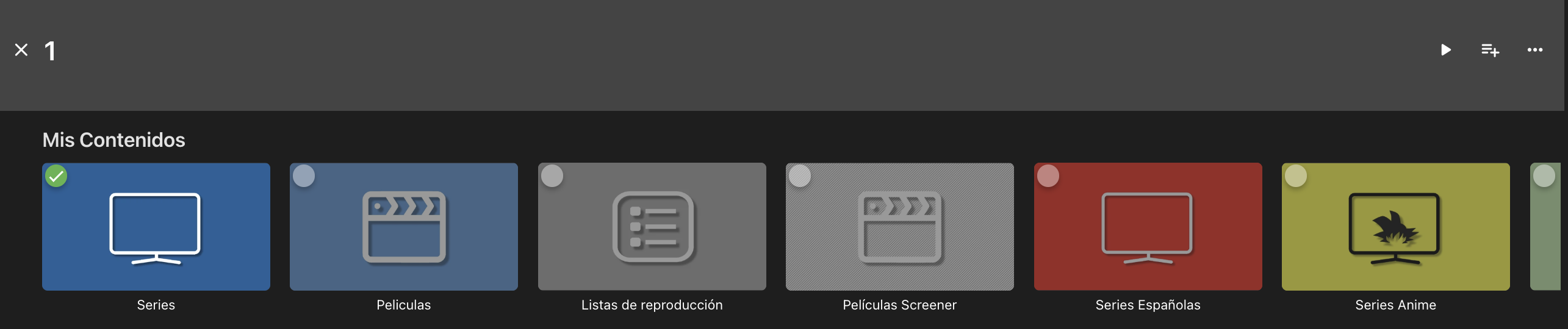

GrimReaper 4141 Posted October 17, 2024 Posted October 17, 2024 27 minutes ago, DarkStar1977 said: But there's not an option to mark an entire library as "unplayed", I've checked and never appears this option. 19 minutes ago, DarkStar1977 said: If a "played" option is available for libraries, same as for seasons and for episodes, movies, whatever, seems logic to me that is possible to mark as "unplayed" a library the same way you can do it with an episode, a movie, a season or whatever in emby, except a library. Multi-select only that single library, three-dot menu top-right will have "Mark Unplayed" as well.

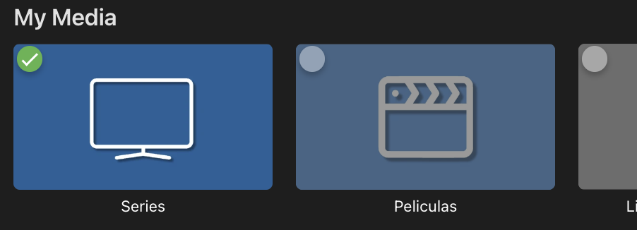

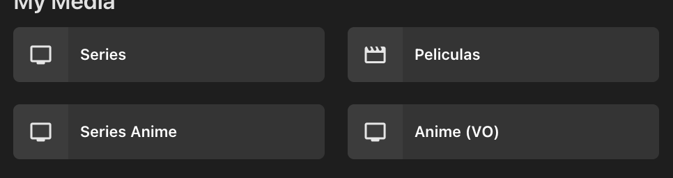

DarkStar1977 93 Posted October 17, 2024 Posted October 17, 2024 6 minutes ago, GrimReaper said: Multi-select only that single library, three-dot menu top-right will have "Mark Unplayed" as well. That's Great but Multi-Select only works if you have on the home screen "My Media": If you have the "My Media Smalll", you cannot multi-select anything from libraries. In any case @HouseOfCardsyou have here a working workaround for your issue. @GrimReaperseems reasonable that this will be available even if you're using the "Small My Media", so a contextual menu will be desired, if the solution is already implemented on the multi-selection, this means is just adding the menu option because the programming is already done. Thanks
GrimReaper 4141 Posted October 17, 2024 Posted October 17, 2024 2 minutes ago, DarkStar1977 said: seems reasonable that this will be available even if you're using the "Small My Media", so a contextual menu will be desired, if the solution is already implemented on the multi-selection, this means is just adding the menu option because the programming is already done I agree, seems like an omission, multi-select should be available regardless of My Media or My Media (small). @Luke 1
