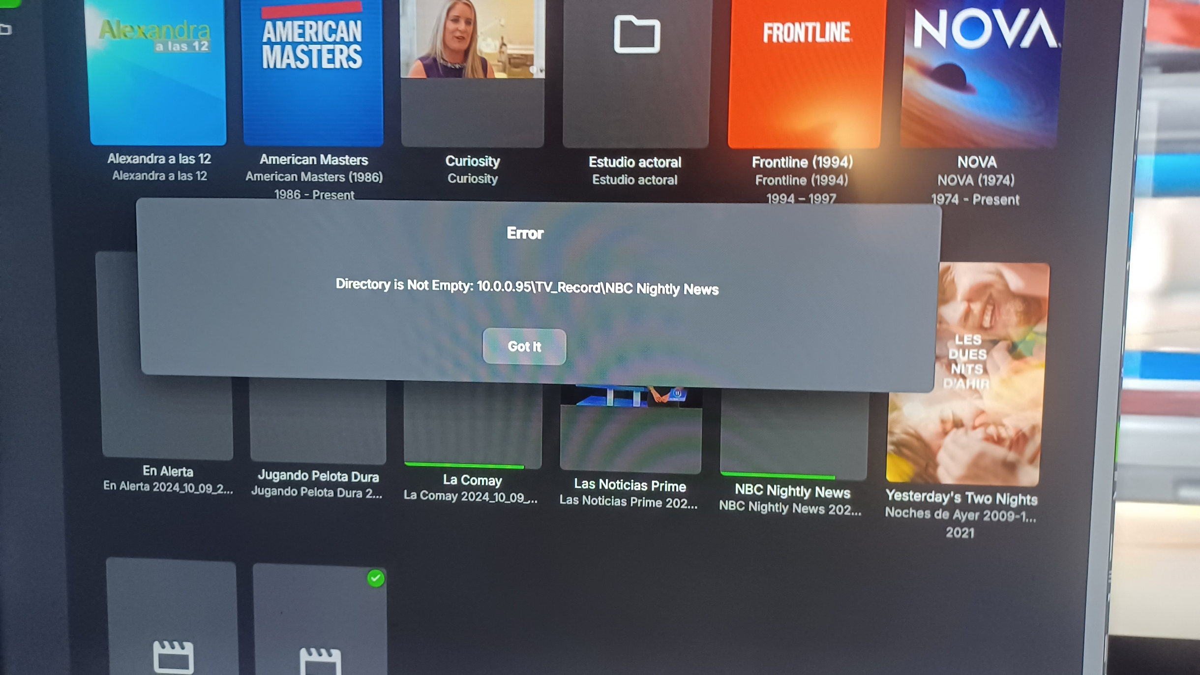

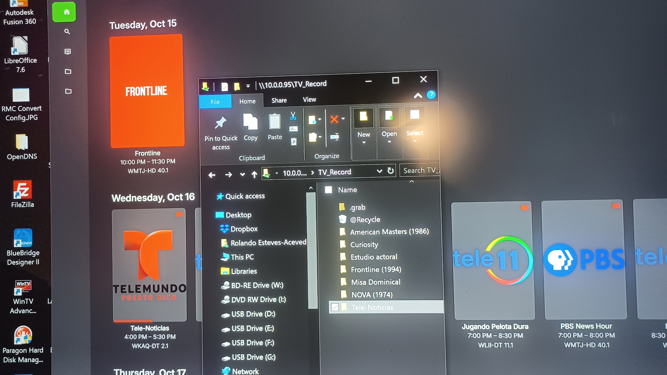

Rolando1948 1 Posted October 16, 2024 Author Posted October 16, 2024 Yesterday Oct.15, as previously described, I deleted all the Live TV Series folders from my NAS with my PC's file manger, so that Emby would then proceed to record the next day's series recordings and place then in the corresponding folder, but I decided in one of the folders, to delete the recording of the previous day series recording, but leave the empty series folder, to observe the following day Oct.16, what Emby's behavior would be. Today Oct.16, I went to the Schedule, right after the programed time for the recording and could observe that Emby indicated to be recording at the correct time and channel the recording, but upon opening the corresponding series recording folder that I had left empty the previous day, there was no file of the recording to be found. During this process, I also observed that a subsequent programed recording, scheduled about a half hour later, of which I had deleted its previous day recording and folder, Emby then did create a folder for it and was placing the recording in it. Thus, I was able to confirm that the anomalus Emby behavior, is subject to not only to having the recording file deleted, but also the folder, for the next day’s series recording to be successfully done and saved, which is obviouly un acceptable. I am attaching a photo where one can observe that Emby’s Schedule, is recoding at the schedule time and channel, but it fails to place the recording in the folder of the previous day’s recording, even if the folder is empty. I am also attaching the log file. 2024-10-16 B embyserver.txt

Rolando1948 1 Posted October 22, 2024 Author Posted October 22, 2024 As I have previously observed, in all cases, if there is a previous series recording in the Live TV configured recordings folder, Emby will proceed and show that it is in the process of recording at the schedule time and channel, but will fail to save the new series recording in the corresponding series folder. EXCEPT,

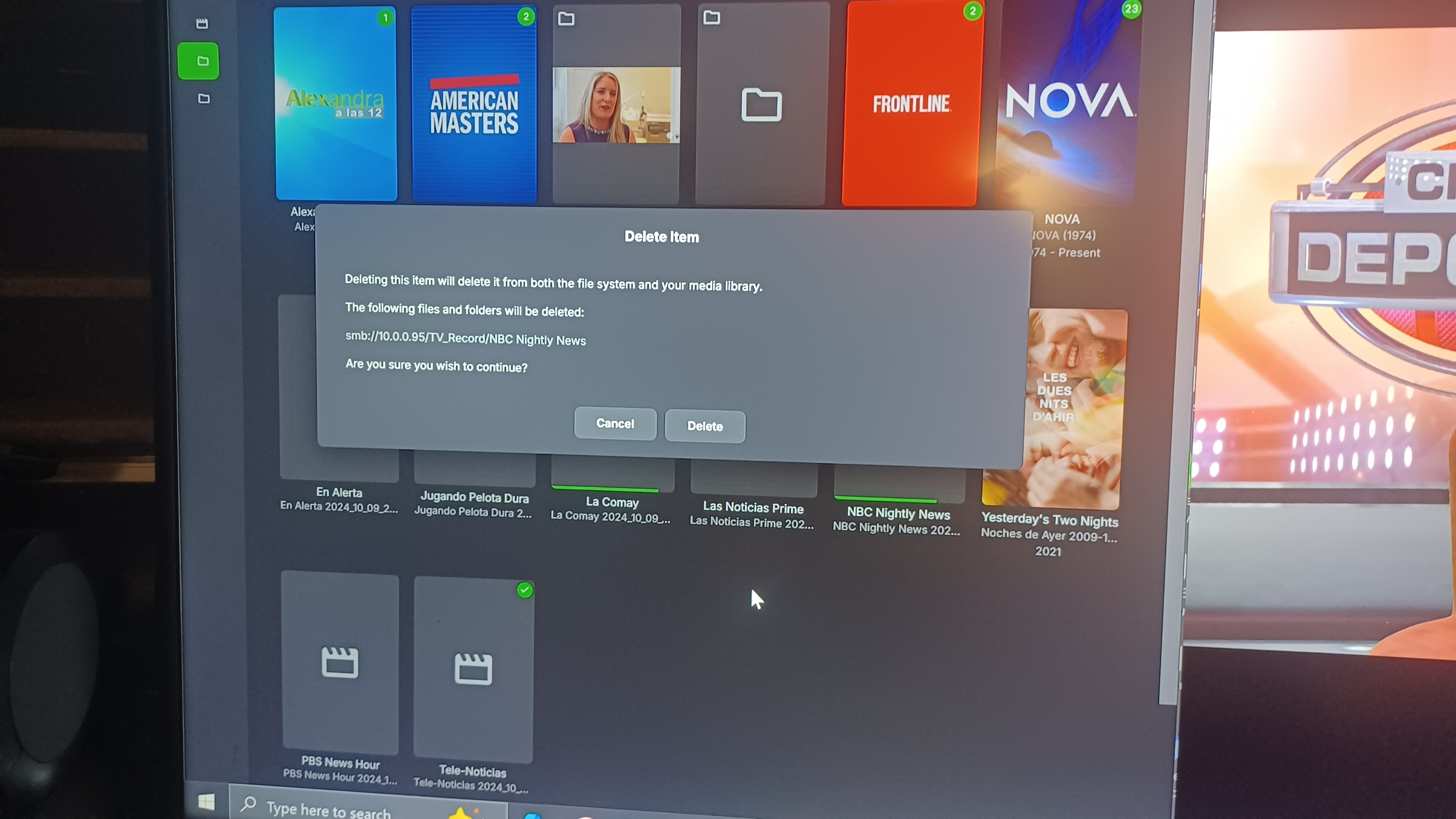

Rolando1948 1 Posted October 22, 2024 Author Posted October 22, 2024 EXCEPT, if I have previously accessed the folder with my File Explorer, and deleted the previous recording and folder, which Emby fails to accept to perform from if I use the Emby user's interface, where a pop up message will occur of "Directory is Not Empty". Thus, on a daily basis I have to access the NAS folder and deleted all the previous day's recording, in order to enable Emby to save the subsequent series recording. This is what I have been describing repeatedly from the very begining, basically everything else seems to be working correctly as far as live tv scheduling and recording. The issue that remains unsolved, is what I have previously describe, Emby will fail to save the new series recording if a previous series recording if present.

sa2000 410 Posted October 23, 2024 Posted October 23, 2024 (edited) On 22/10/2024 at 21:40, Rolando1948 said: EXCEPT, if I have previously accessed the folder with my File Explorer, and deleted the previous recording and folder, which Emby fails to accept to perform from if I use the Emby user's interface, where a pop up message will occur of "Directory is Not Empty". Deletions should be through the Emby App context menu. I am looking into another user's report of deleting seasons and shows not working giving the error you describe. I am thinking it is to do with smb paths which you are also using. I suggest we concentrate on this first and also perhaps move away from smb paths The other forum thread and my advice to the user for specific tests is here Edited October 28, 2024 by sa2000 1
