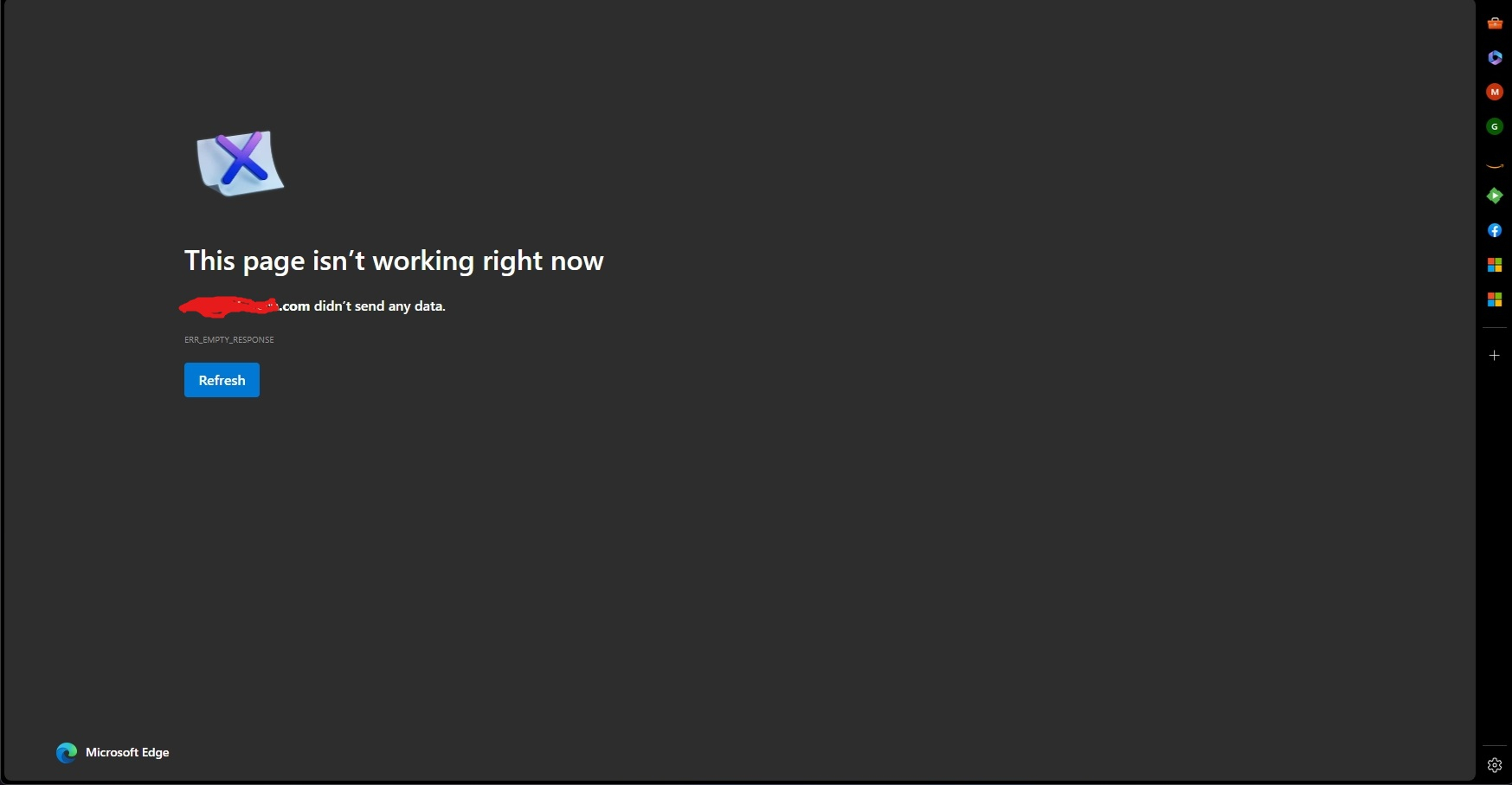

gihayes 47 Posted September 2, 2024 Author Posted September 2, 2024 (edited) I meant port 8096 not 9096, that was a typo. I ran the netstat command and it returned nothing. just went back to the prompt. There is a tool in windows named Resource Monitor that shows what programs are listing on what ports. It shows Emby listening on quite a few ports, but 8920 is not one of them. I am attaching a new log. I am running Bitdefender AV software and Emby has been allowed access to all ports. Emby is allowed access with Windows Defender Firewall also. I have tried connecting with both off, and for a very short period with my Bitdefender AV totally disabled. But I still get the same Web page when trying to connect via https. I was running Emby as a service but have just switched to running it as an app so as to make restarting easier. I have attached a new log embyserver.txt Edited September 2, 2024 by gihayes Turned on Debugging, Replaced log

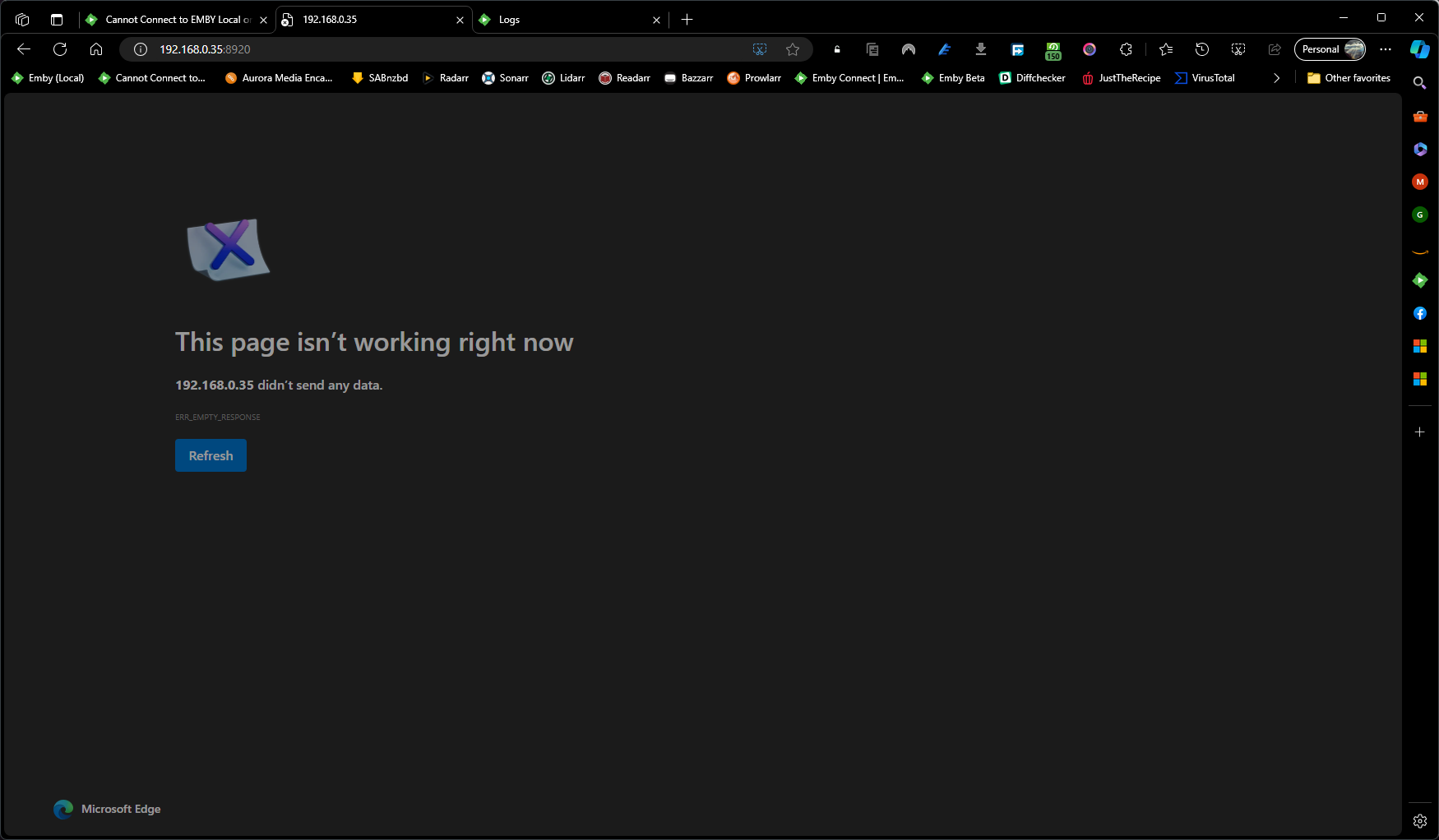

gihayes 47 Posted September 2, 2024 Author Posted September 2, 2024 (edited) I just checked the Windows Resource Monitor and Emby is listening on 8920 now, and the netstat command worked, but I still get the same webpage when trying to connect to https. If I try to connect using 192.168.0.35:8920 I get a different webpage error. Attaching screenshot. Edited September 2, 2024 by gihayes

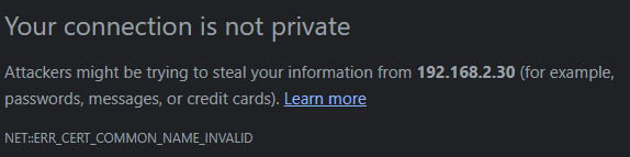

Lessaj 301 Posted September 2, 2024 Posted September 2, 2024 (edited) Can you provide the entire URL for that page? It's not in the screenshot. I just installed a server very quickly on a windows vm and used my same certificate, setting up nothing else, and I can see it listening, it just complains about the common name not matching (which I expected). Edited September 2, 2024 by Lessaj
gihayes 47 Posted September 2, 2024 Author Posted September 2, 2024 That's all it shows. I checked my Emby System folder and found a system.xml.dll but not just a system.xml. Will re-installing over my current install possibly straighten things out? if I do that, It will keep all my libraries and settings, right? Here is the result of the netstat command C:\Windows\System32>netstat -an | findstr 8920 TCP 0.0.0.0:8920 0.0.0.0:0 LISTENING TCP [::]:8920 [::]:0 LISTENING C:\Windows\System32>
Happy2Play 9458 Posted September 2, 2024 Posted September 2, 2024 (edited) 5 minutes ago, gihayes said: I checked my Emby System folder and found a system.xml.dll but not just a system.xml It will not be in Emby system folder it will be Emby programdata folder. C:\Users\{username}\AppData\Roaming\Emby-Server\programdata\config But per your image you are not going to https you are going to http which will not work. 2024-09-02 00:04:31.089 Info App: Adding HttpListener prefix http://+:8096/ 2024-09-02 00:04:31.089 Info App: Adding HttpListener prefix https://+:8920/ Edited September 2, 2024 by Happy2Play
