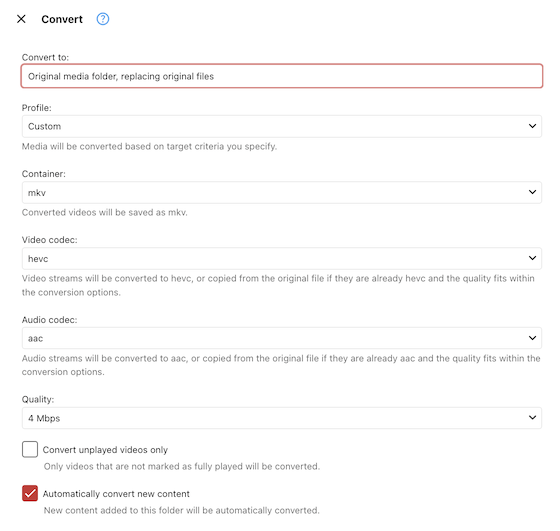

zaHrecsohbiw 13 Posted August 16, 2024 Posted August 16, 2024 When creating a rule for automatic conversion to apply to a folder, is there a way to use original bitrate if the bitrate is below a defined threshold? For instance, I'd like to convert all media that shows up in a specific folder to HEVC, and I would like to set an upper limit bitrate of 4mpbs. So, if the bitrate is lower than 4mpbs, it's converted at original bitrate, but if the bitrate of the original media was, say, 12 mbps, I'd like to to be reduced to 4mpbs during the conversion process.
Luke 40073 Posted August 24, 2024 Posted August 24, 2024 Hi @zaHrecsohbiwthat's what it should already do. Did you try setting a custom bitrate of 4 mbps when setting up the conversion job?

zaHrecsohbiw 13 Posted September 10, 2024 Author Posted September 10, 2024 29 minutes ago, Luke said: OK @zaHrecsohbiwplease let us know how this goes. Thanks. I’m sorry @Lukei haven’t really paid as much attention to this as I should have. I just wrapped up converting ~2500 files to mkv(hevc/aac) and basically had three categories of output: 1) (the vast majority) have been at or below the bit rate limit I entered, and the quality is generally acceptable. I don’t always understand the relationship between avc bitrate input and hevc bitrate output, but it’s nothing that I would complain about, as I am prioritizing storage efficiency over any other detail, 2) have been low bitrate in & out, but the output is larger than the input (just one of those things I guess), and 3) files that were high bitrate input and aggressively compressed & low bitrate on the output. This last category really confuses me. all of these files were done with a single convert task applied to an entire library, with custom settings of mkv, hevc, aac, 4 mbps. to be honest though, I don’t think your software has done anything wrong here. This could all be up to my hardware and driver preferences (Intel, using QSV. I disabled all VAAPI options.) in my case the hevc qsv encoder doesn’t have any tunable parameters so it’s likely that this is all just the nature of the beast. it could perhaps be the case that some low bitrate files did somehow manage to go from <1 mbps to >=1 mbps, but I just did not spend enough time collecting file info before I let the task complete to be able to provide a meaningful example. If there is a way for me to “close” this as an issue, I’ll be happy to do so.

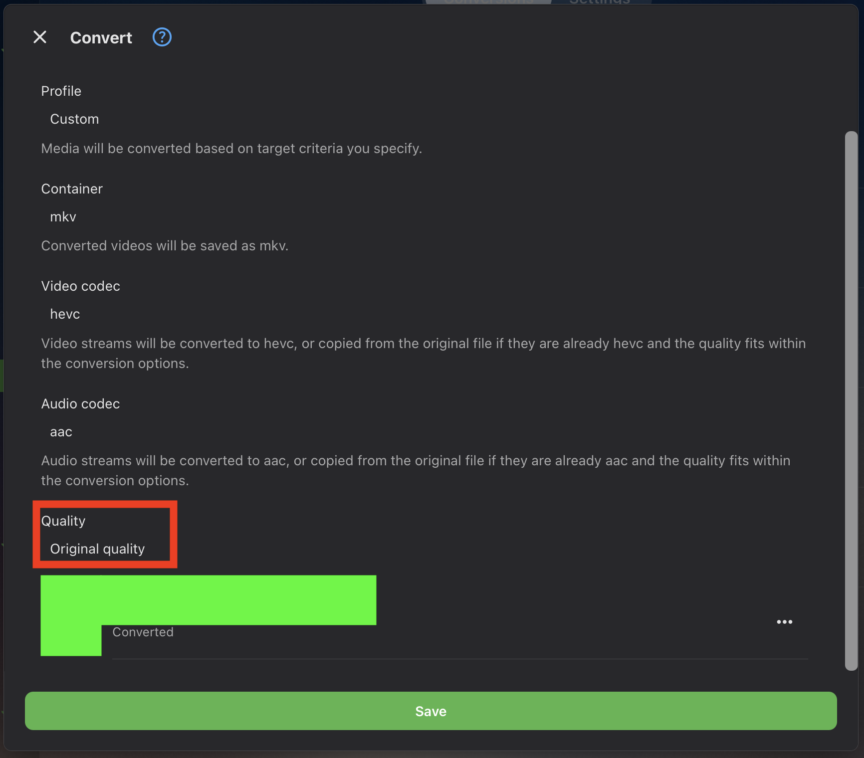

zaHrecsohbiw 13 Posted October 11, 2024 Author Posted October 11, 2024 35 minutes ago, Luke said: Hi, can we please look at a specific example? Thanks. please see attached; input file is 14mbps, output file is 1mbps, conversion settings are hevc/aac/original quality. unfortunately the same thing happened to the vast majority of my files. im not sure that I still have the embyserver log for this specific conversion instance. ffprobe-of-converted-file.txt ffmpeg-transcode-f35416ac-fd86-4c2f-8c27-594fe67c4fc7_1.txt
zaHrecsohbiw 13 Posted October 12, 2024 Author Posted October 12, 2024 (edited) @LukeSorry I forgot to mention yesterday that I also had the same results when setting a custom bitrate of 4mbps. I haven't inspected every graph file certainly, but the encoder side seems to always use the default bitrate of 1536kb/s. nm that's the audio bitrate; I wasn't being thorough enough before I posted this. but: 03:53:56.574 Stream #0:0: Video: hevc, qsv(tv, bt709, progressive), 1920x800 [SAR 1:1 DAR 12:5], q=2-31, 1000 kb/s, 23.98 fps, 1k tbn (default) Edited October 12, 2024 by zaHrecsohbiw im an idiot
