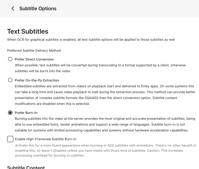

guunter 41 Posted July 22, 2024 Posted July 22, 2024 On 7/20/2024 at 12:56 PM, anonynot said: I tried this today, it did help on some files but on others it has the same effect as just turning of on-the-fly in in the normal settings where some files just don't load at all. I just wanna make sure but this setting right?
anonynot 1 Posted July 23, 2024 Author Posted July 23, 2024 On 7/22/2024 at 11:31 AM, guunter said: I just wanna make sure but this setting right? Yep, same result as the non-plugin. I still haven't really figured out what's going on here, but I did test out some other clients and android and emby theatre (built in player and external player) are working fine so I've been using those. Specifically having the issue with browser and LG smart tv app - I'm assuming that it has something with how those devices/clients are processing subtitles?
