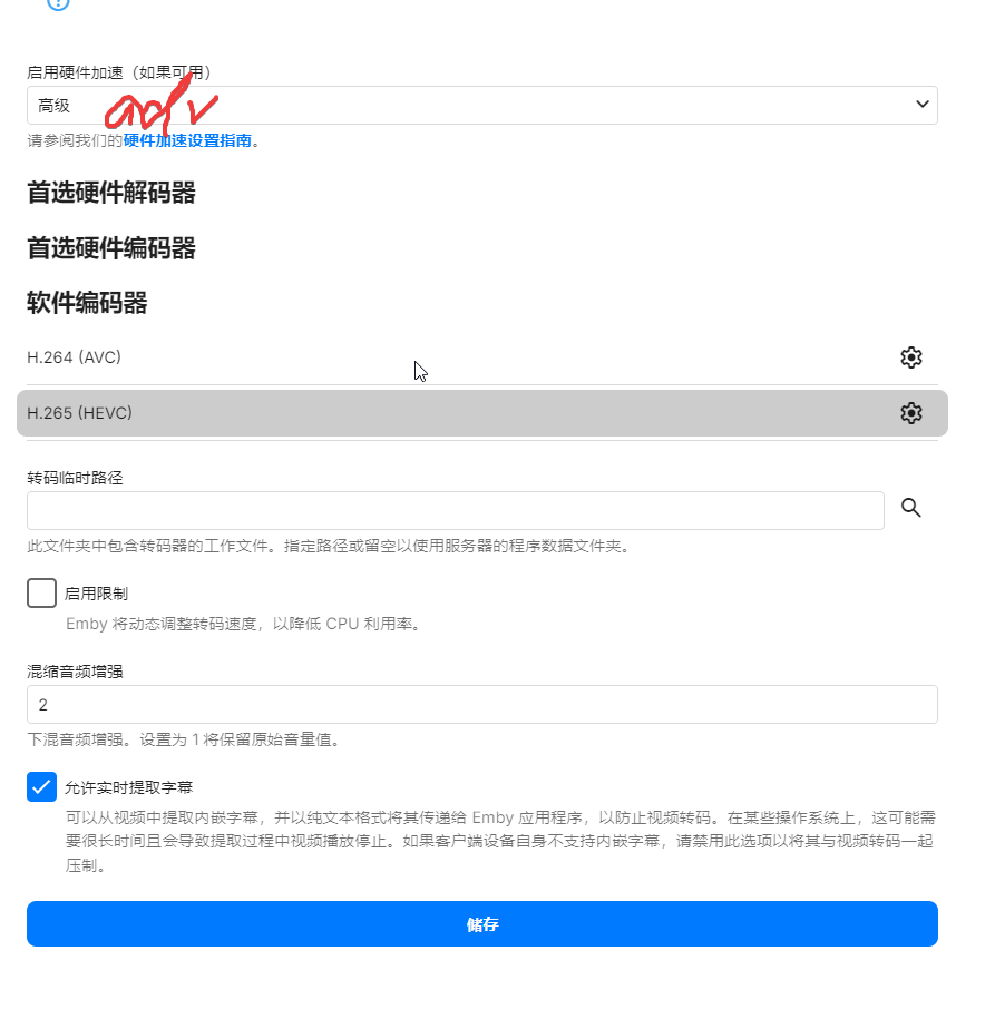

zzsx644 3 Posted July 9, 2024 Posted July 9, 2024 After upgrading from version 4.7.14 to 4.8, hardware decoding no longer works 在4.7.14下一切正常,升级到4.8之后无法硬解,转码界面可以看到独立显卡,但是硬解不工作。 黑群晖SA6400 7.2,独显为GTX1650 Everything worked fine on version 4.7.14, but after upgrading to 4.8, hardware decoding no longer works. The transcoding interface shows the dedicated graphics card, but hardware decoding is not functioning. Using a Hackintosh NAS with Synology SA6400 7.2, and the dedicated GPU is a GTX 1650. embyserver.txt hardware_detection-63856087224.txt ffmpeg-transcode-43159380-1841-4968-a27d-8823ec0beb59_1.txt

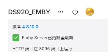

yanbin_c 0 Posted October 19, 2024 Posted October 19, 2024 same issue,doesn;t work recently on my ds920. thanks/
Carlo 4552 Posted October 19, 2024 Posted October 19, 2024 I have a ds920+ and haven't run into this issue at all. You want to install Emby directly and not in docker so it has access to QSV GPU.
Carlo 4552 Posted October 19, 2024 Posted October 19, 2024 This is a ds920+ with a PLUS in the name correct?

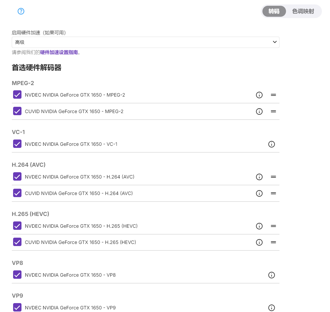

Luke 40066 Posted November 17, 2024 Posted November 17, 2024 On 10/25/2024 at 2:30 AM, zzsx644 said: 目前没有发现什么有用的信息 I haven't found any useful information so far. Since you have both cuvid and nvdec decoder options, did you try changing the priorities to test them both?
