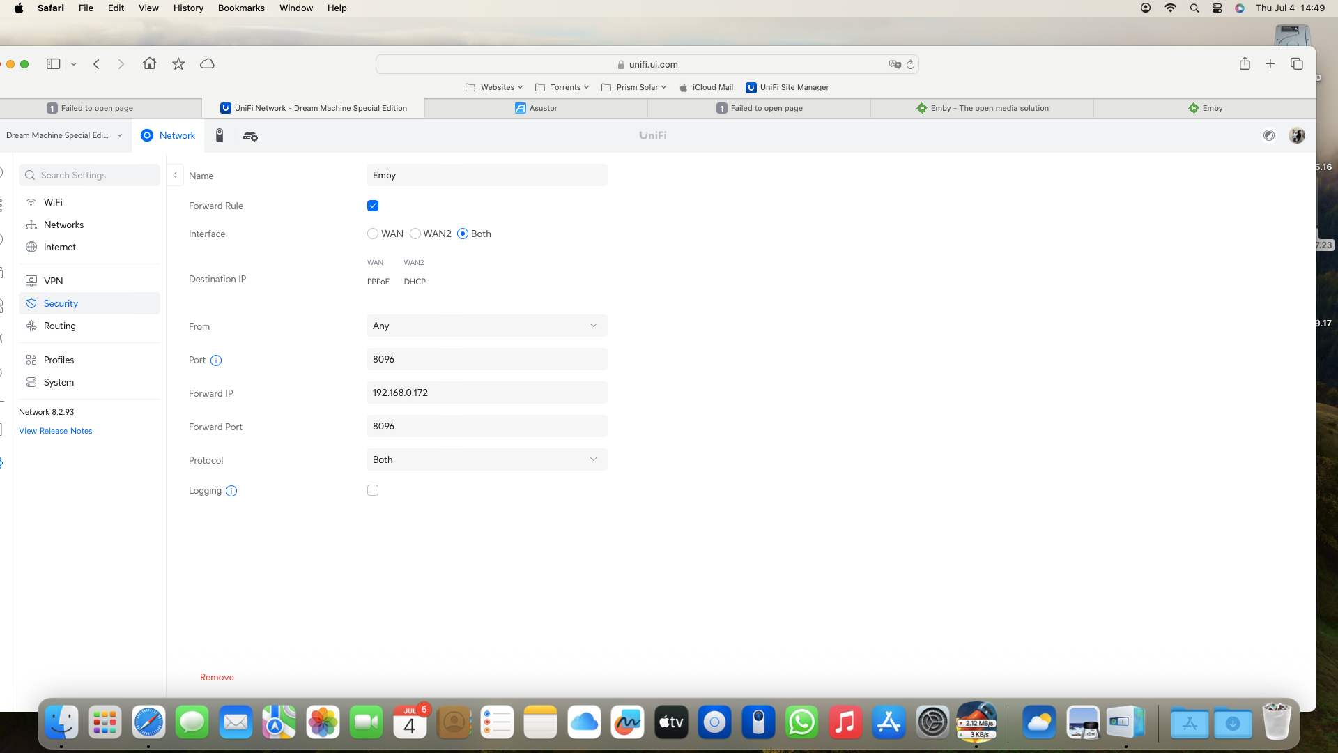

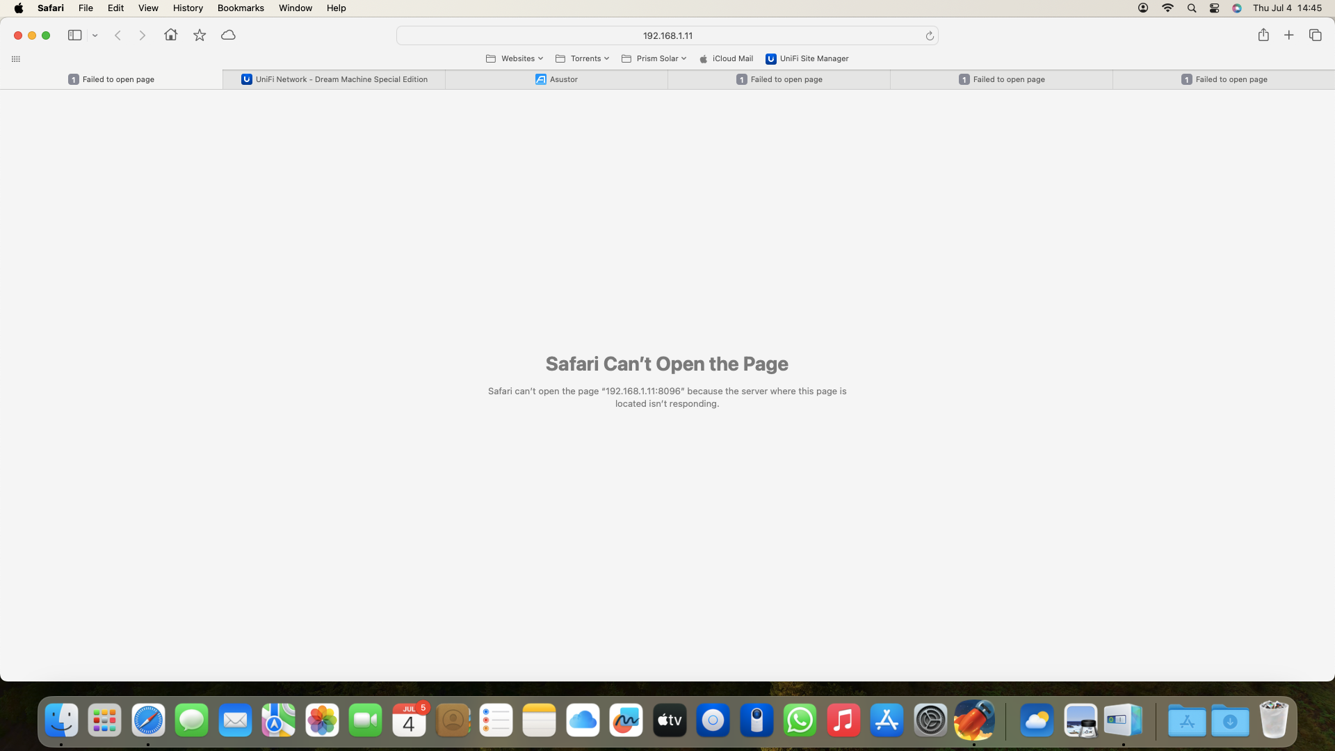

prismsolar 1 Posted July 4, 2024 Posted July 4, 2024 (edited) Hi Everyone I hope you can help and I apologize in advance if this has been asked before , I currently have running on my ASUSTOR NAS plex , but recently I'm not just happy with plex so I bought Emby premier and my plan was to move everything from plex to emby. however here seems to be the problem ive installed emby and when I go to setup I get the "failed to open page " please see attached screenshots am I doing something wrong here that I'm not understanding ? just to note with out without the port forwarding on my unifi internet it does not load up Regards Callum Edited July 4, 2024 by prismsolar spelling mistakes
Neminem 886 Posted July 4, 2024 Posted July 4, 2024 I you first screenshot you forward to 192.168.0.172 Then in you last screenshot you try to connect to 192.168.1.11 What is your Asustor ip address, finde that and use that. the try typing in http://Asustor.ip:8096

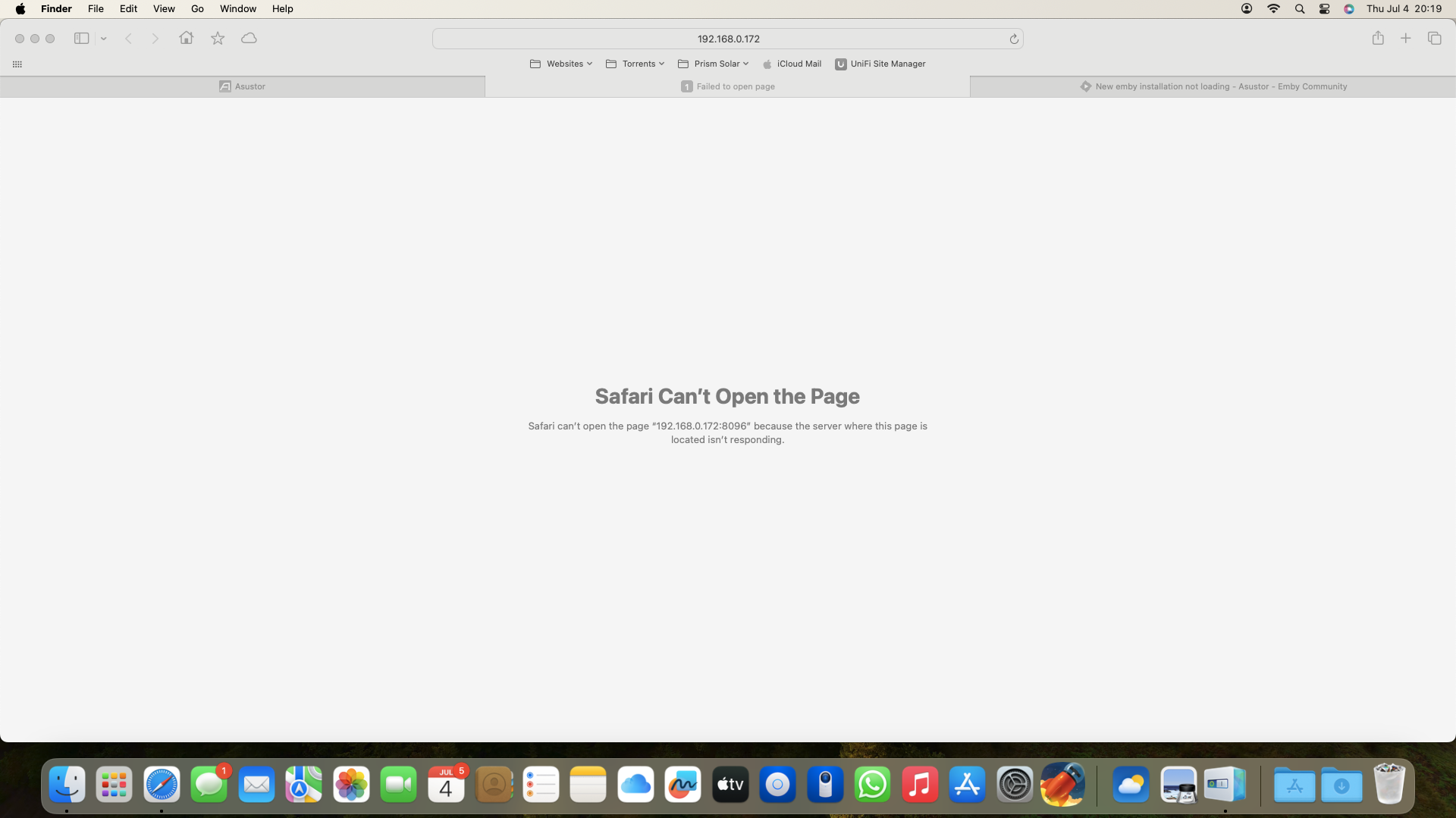

prismsolar 1 Posted July 4, 2024 Author Posted July 4, 2024 Hello , thanks for your reply its still the same using the ASUSTOR ip address as you can see in the attached photo
Luke 40068 Posted July 5, 2024 Posted July 5, 2024 What is the full address that is in the browser address bar? Did you enter a port number?

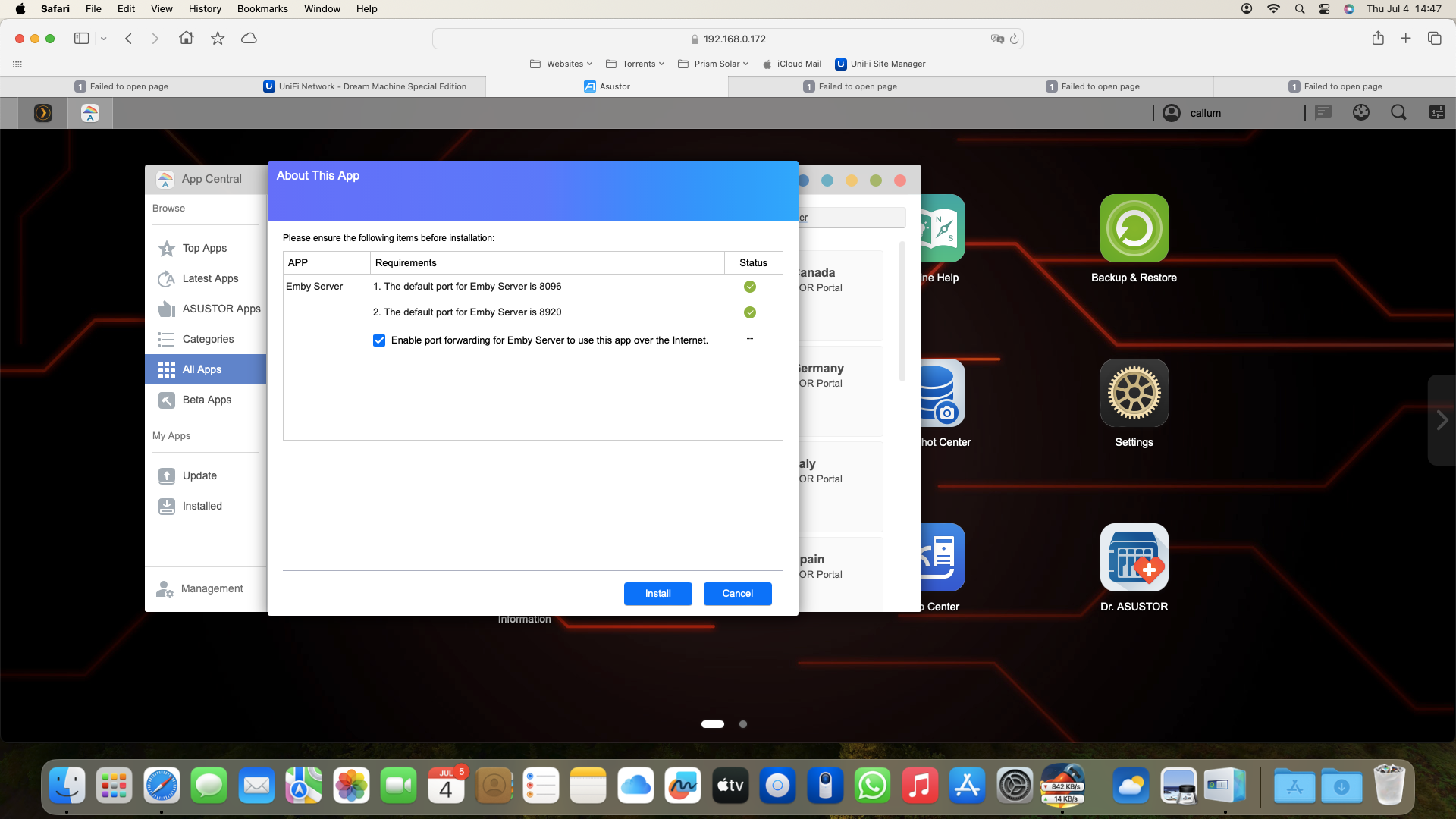

Jägs 85 Posted July 6, 2024 Posted July 6, 2024 Another quick thing to check: do you have Emby turned on in App Central on your ASUSTOR? 1
prismsolar 1 Posted July 6, 2024 Author Posted July 6, 2024 Good morning yes it is switched on regards Callum

prismsolar 1 Posted July 10, 2024 Author Posted July 10, 2024 Hello exactly the same as above page cannot be displayed
Jägs 85 Posted July 10, 2024 Posted July 10, 2024 And I'm assuming you've rebooted/reinstalled? If so, it might be time to do a manual removal, which I only recommend in cases like yours. Effectively, it seems like ADM does not always properly install/uninstall Emby and it can get "stuck," so the only recourse is to manually remove it. I have instructions here, which has seemed to work in similar cases—I run into this from time to time:
