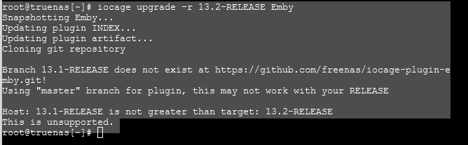

pve78 3 Posted July 8, 2024 Author Posted July 8, 2024 Hi, I ran this command: iocage upgrade -r 13.2-RELEASE Emby Got the attached screen shot. Emby Version 4.8.8.0 FreeBSD 13.1 for the Emby Jail/Cage

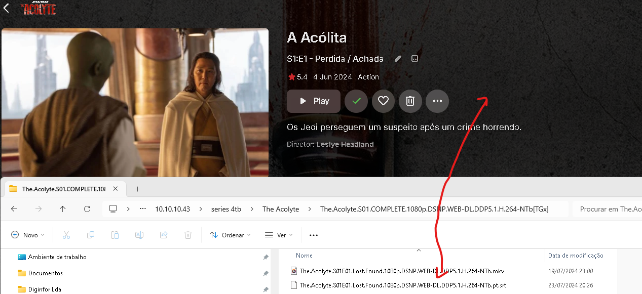

Ruben Alcaide 1 Posted July 23, 2024 Posted July 23, 2024 Hello everyone, I have the same problem that pve78 reported. Version TrueNAS CORE -13.3-BETA2 Emby Version : 4.8.8.0 The video on the Webapp does not work and the subtitles are downloaded but are not available after download. I tried to manually put the subtitles with the same name and update the library and it doesn't work either. Below is the error log after trying to view video on the webapp: Playback Error : No compatible streams are currently available. Please try again later or contact your system administrator for details. ld-elf.so.1: /usr/local/lib/libtasn1.so.6: Undefined symbol "strverscmp@FBSD_1.7" Subtitles : ffmpeg-transcode-4e6bc223-9284-4fa0-9df0-0fc15a924b3b_1.txt
Happy2Play 9446 Posted July 23, 2024 Posted July 23, 2024 2 hours ago, Ruben Alcaide said: Hello everyone, I have the same problem that pve78 reported. Version TrueNAS CORE -13.3-BETA2 Emby Version : 4.8.8.0 The video on the Webapp does not work and the subtitles are downloaded but are not available after download. I tried to manually put the subtitles with the same name and update the library and it doesn't work either. Below is the error log after trying to view video on the webapp: Playback Error : No compatible streams are currently available. Please try again later or contact your system administrator for details. : /usr/local/lib/libtasn1.so.6: Undefined symbol "strverscmp@FBSD_1.7" Subtitles : ffmpeg-transcode-4e6bc223-9284-4fa0-9df0-0fc15a924b3b_1.txt 2.76 kB · 0 downloads Will have to look but don't think 4.8 is compatible with 13.3 and requires beta 4.9 or should say beta topic say it works. Dev or package builder will have to comment.

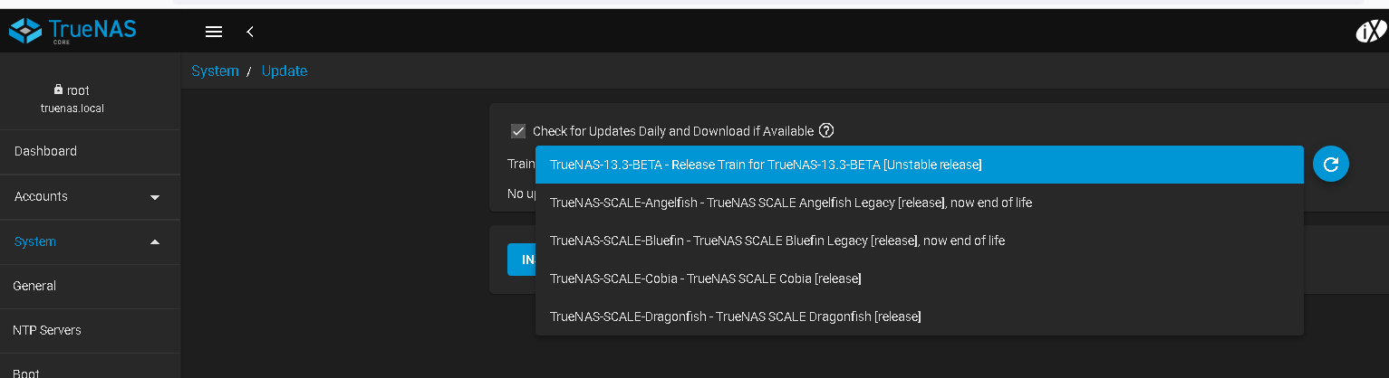

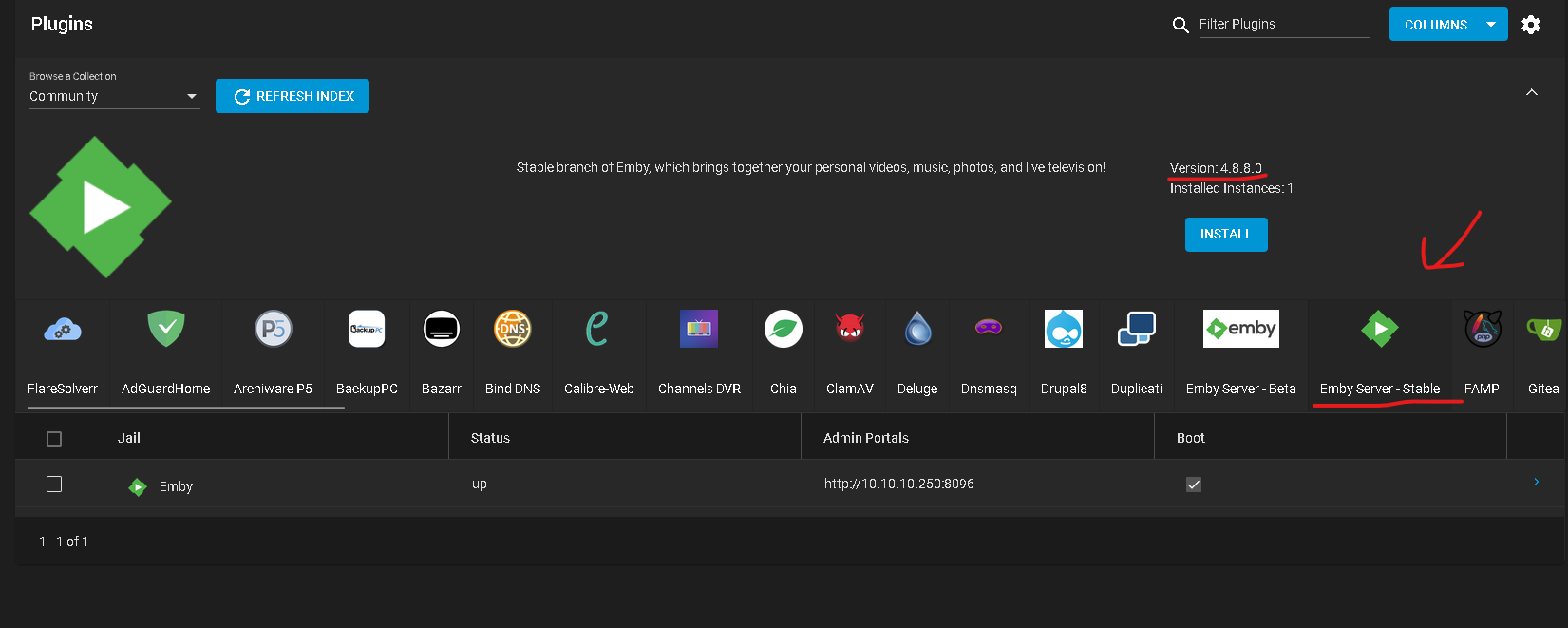

Ruben Alcaide 1 Posted July 24, 2024 Posted July 24, 2024 Hello @Luke Emby was installed by the official plugin on the Community present on TRUE NAS : It was working before the last official update 4.8.8.0 Also Thanks @Happy2Play for the input. But I have to understand why the official Community version doesn't worK correct with the CORE version of TRUENAS. Even @pve78indicated that it had to migrate to a SCALE version of TRUENAS and did not mention which one: Hello @pve78, what SCALE version did you install?
alucryd 240 Posted July 25, 2024 Posted July 25, 2024 @Ruben AlcaideJust pick the latest one, dragonfish.
Ruben Alcaide 1 Posted July 29, 2024 Posted July 29, 2024 Thanks @alucryd resolved with TRUENAS 13.3 BETA SCALE Dragonfish. 1
