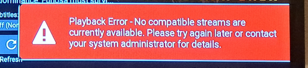

mattcaz 3 Posted June 26, 2024 Posted June 26, 2024 Emby Premier works great on my Denon 7.1 AVR, but in my office I have a Roku connected over HDMI to a standard stereo TV and It refuses to play anything that is encoded with EAC3 5.1. On the TV I've selected PCM and Passthru for the audio and it doesn't make a difference. Am I missing Something? Roku settings maybe? Is there any way to get EMBY to transcode this down to say AAC 2.0? Having to use MKV tools to convert everything is a Pain in the backside. Thanks, matt caswell
