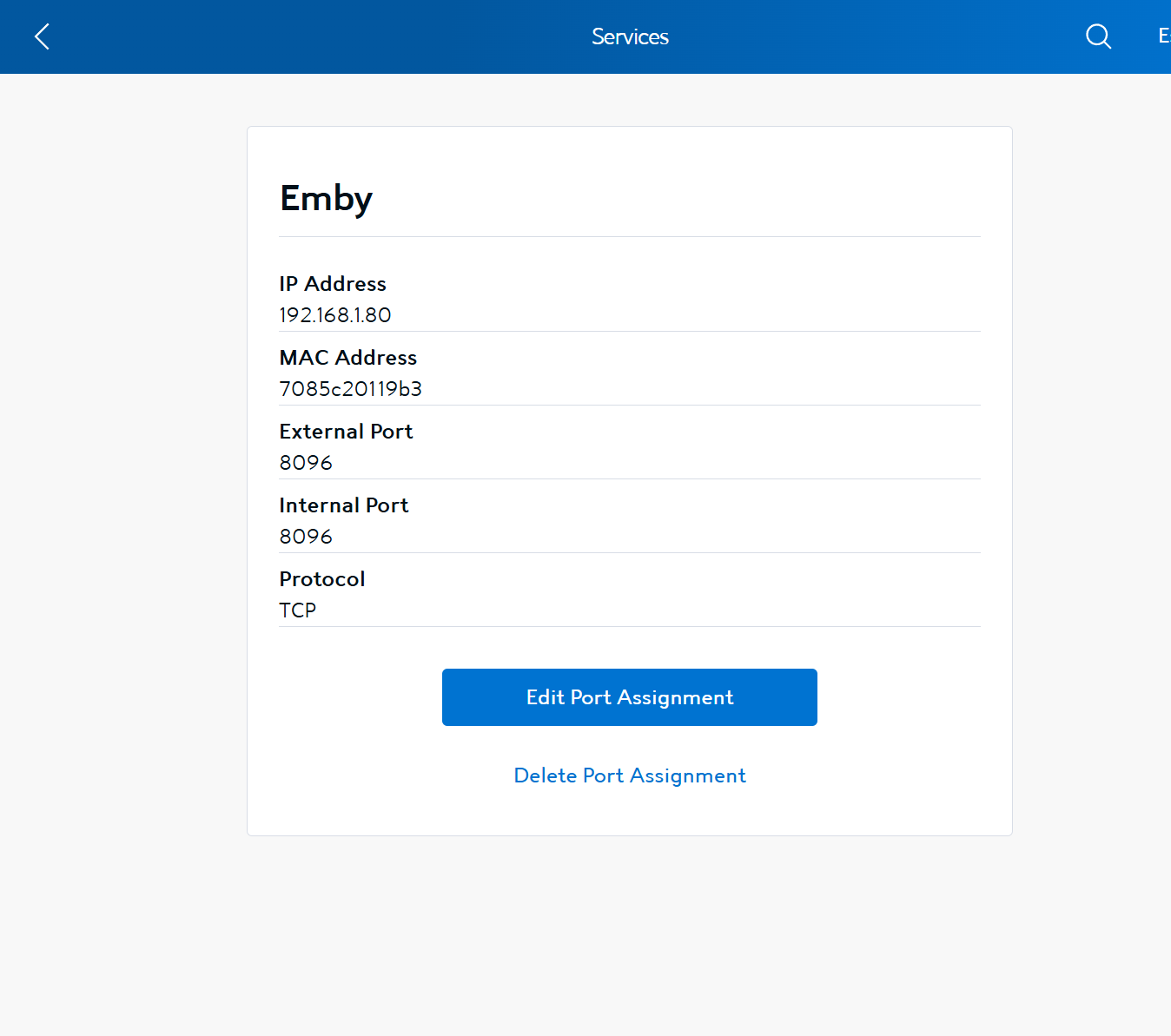

darkassassin07 619 Posted June 13, 2024 Posted June 13, 2024 (edited) As you changed from wifi to ethernet, your server has a different LAN IP . Your port forwarding rules (router settings) need to be updated to send traffic to the new LAN IP . You should also look at setting a fixed LAN IP for your server, to prevent it being assigned a different one after a power outage. Either via static dhcp lease settings (router), or through your network interface settings (server). Missing that step is likely why switching back to wifi didn't fix it. Edited June 13, 2024 by darkassassin07
iamjarbear 5 Posted June 13, 2024 Author Posted June 13, 2024 (edited) 2 hours ago, darkassassin07 said: As you changed from wifi to ethernet, your server has a different LAN IP . Your port forwarding rules (router settings) need to be updated to send traffic to the new LAN IP . You should also look at setting a fixed LAN IP for your server, to prevent it being assigned a different one after a power outage. Either via static dhcp lease settings (router), or through your network interface settings (server). Missing that step is likely why switching back to wifi didn't fix it. I went through the settings on my router in my spectrum app as well as followed the How-to for Port Forwarding (Emby.Docs/Remote-Setup.md at master · EmbySupport/Emby.Docs · GitHub) and it still does not appear to be working. See below screenshot from my Router settings. Does that look correct? I also added a couple other screenshots. Im not sure what I am doing wrong as I feel like I am doing what I am supposed to. Edited June 13, 2024 by GrimReaper WAN IP masked
darkassassin07 619 Posted June 13, 2024 Posted June 13, 2024 As a mac address is specified, make sure it is correct. Your server will have a different one for ethernet vs the one it had for wifi. You can usually find a list of connected mac addresses and their assigned IP addresses somewhere in the routers status pages. 1

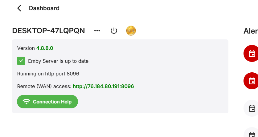

Happy2Play 9441 Posted June 13, 2024 Posted June 13, 2024 As mentioned above this has to be a port forwarding issue as you can connect locally it should eliminate firewall issues. @GrimReapercan you remove the WAN address above.

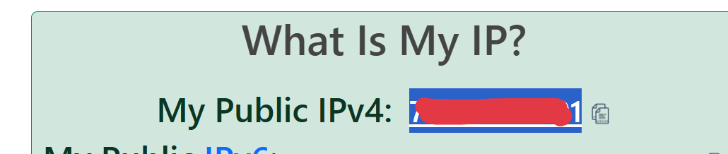

iamjarbear 5 Posted June 13, 2024 Author Posted June 13, 2024 (edited) 1 hour ago, darkassassin07 said: As a mac address is specified, make sure it is correct. Your server will have a different one for ethernet vs the one it had for wifi. You can usually find a list of connected mac addresses and their assigned IP addresses somewhere in the routers status pages. So it appears the Mac address does seem to match. Something else I noticed though, when i use Whatsmyip. Whatsmyip provides me with the IPV4 as the Remote WAN Ip (76.184...) whereas checking under my IPConfig through cmd prompt matches the In-Home Lan (192.168...) Edited June 13, 2024 by GrimReaper WAN IP masked

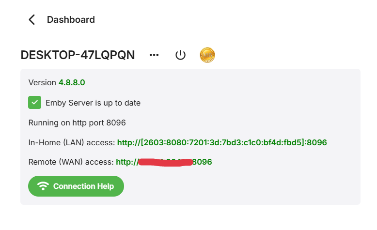

iamjarbear 5 Posted June 13, 2024 Author Posted June 13, 2024 (edited) 1 hour ago, Happy2Play said: As mentioned above this has to be a port forwarding issue as you can connect locally it should eliminate firewall issues. @GrimReapercan you remove the WAN address above. Something updated but idk why it changed the LAN access. Im even more confused now Edited June 13, 2024 by GrimReaper WAN IP masked
Happy2Play 9441 Posted June 13, 2024 Posted June 13, 2024 Your router appears to have assigned a IPv6 address. Personally I just disable it on my LAN. 1
darkassassin07 619 Posted June 13, 2024 Posted June 13, 2024 Odd, I don't usually see ipv6 on a lan... I agree with Happy, just disable ipv6 support on the lan. Restart the server machine and router after that change; then go back to the port forwarding setup.

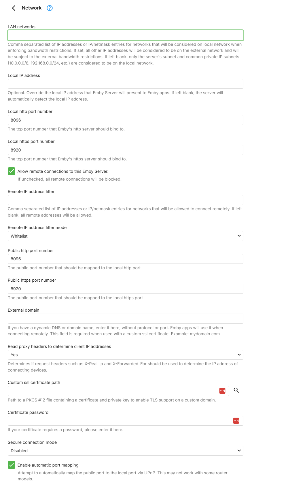

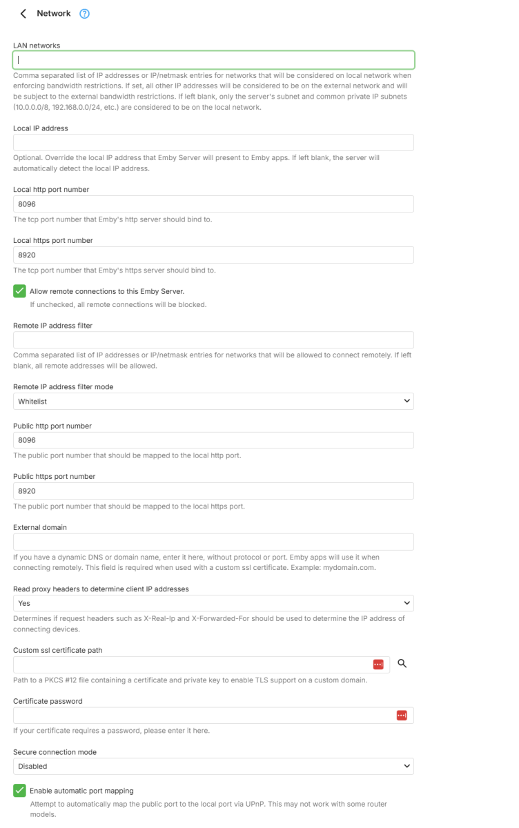

Solution rbjtech 4996 Posted June 13, 2024 Solution Posted June 13, 2024 (edited) If you did not do any manual port forwarding before (when it was on wifi) - then this implies you were using upnp to do the port forwarding. This is also shown in the 'Enable Port Mapping' in the emby network configuration. I would suggest removing any manually created port forwarding rules in the router (related to emby), then do a full power off and on again. Ensure upnp is enabled in the router itself - it 'may' have turned this off if you manually added a rule. Then power off/on your emby server - and check it has a v4 IP address - likely 192.168.1.80. But check on the server, or the router IPv4 DHCP tables. Check you can use emby locally. It should have both an 'In-Home' and 'remote' ip/url - if it does, then upnp has done it's thing and automatically port forwarded your WAN IP to the new wired LAN IP. Emby instructs it to do this. Edited June 13, 2024 by rbjtech

iamjarbear 5 Posted June 13, 2024 Author Posted June 13, 2024 7 hours ago, rbjtech said: If you did not do any manual port forwarding before (when it was on wifi) - then this implies you were using upnp to do the port forwarding. This is also shown in the 'Enable Port Mapping' in the emby network configuration. I would suggest removing any manually created port forwarding rules in the router (related to emby), then do a full power off and on again. Ensure upnp is enabled in the router itself - it 'may' have turned this off if you manually added a rule. Then power off/on your emby server - and check it has a v4 IP address - likely 192.168.1.80. But check on the server, or the router IPv4 DHCP tables. Check you can use emby locally. It should have both an 'In-Home' and 'remote' ip/url - if it does, then upnp has done it's thing and automatically port forwarded your WAN IP to the new wired LAN IP. Emby instructs it to do this. So, Im not sure why now as I power cycled everything multiple times originally but after turning off the port forwarding rule in the Spectrum settings and doing another system reset this morning, it appears to be solved. I was using the Port Mapper in the Network settings with Auto port turned on and it had worked without me needing to do anything. Probably just a combination of things. Thanks everyone for the assistance. I'm not sure who to assign as the Solution here to be honest but thank you all fo rthe help, I appreciate it. 1
rbjtech 4996 Posted June 13, 2024 Posted June 13, 2024 2 minutes ago, iamjarbear said: So, Im not sure why now as I power cycled everything multiple times originally but after turning off the port forwarding rule in the Spectrum settings and doing another system reset this morning, it appears to be solved. I was using the Port Mapper in the Network settings with Auto port turned on and it had worked without me needing to do anything. Probably just a combination of things. Thanks everyone for the assistance. I'm not sure who to assign as the Solution here to be honest but thank you all fo rthe help, I appreciate it. The manual port forward rule may not have been correct - and by enabling it - it may have disabled upnp. So by removing it and rebooting, I believe, as you say, it went back to how it was originally. Sometimes routers hold onto upnp 'rules' after a reboot to keep you moving after a power outage for example - so it could be a 'time' thing.

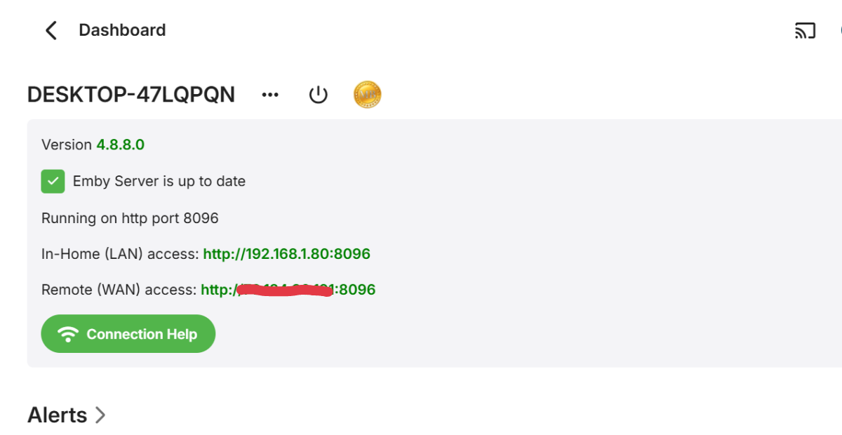

iamjarbear 5 Posted June 13, 2024 Author Posted June 13, 2024 18 minutes ago, rbjtech said: The manual port forward rule may not have been correct - and by enabling it - it may have disabled upnp. So by removing it and rebooting, I believe, as you say, it went back to how it was originally. Sometimes routers hold onto upnp 'rules' after a reboot to keep you moving after a power outage for example - so it could be a 'time' thing. So I may have spoke to soon. While I was able to connect using no WiFi and my admin login (I assume due to Emby Connect) trying to connect on a different network/Device to the remote stuff is still not functioning. Everything's back to how it exactly was before, both the wan/lan are now appearing to be correct. Any additional insights/thoughts as if we're starting over from the beginning. I got my IPs bank to normal but now we're still not getting remote connection.
Happy2Play 9441 Posted June 13, 2024 Posted June 13, 2024 8 minutes ago, iamjarbear said: So I may have spoke to soon. While I was able to connect using no WiFi and my admin login (I assume due to Emby Connect) trying to connect on a different network/Device to the remote stuff is still not functioning. Everything's back to how it exactly was before, both the wan/lan are now appearing to be correct. Any additional insights/thoughts as if we're starting over from the beginning. I got my IPs bank to normal but now we're still not getting remote connection. Sorry I don't follow as your posted WAN address is accessible from the internet. So I can only guess clients are not trying to access the correct address? 1

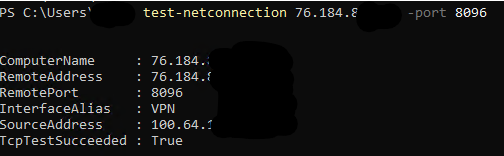

iamjarbear 5 Posted June 13, 2024 Author Posted June 13, 2024 Just now, Happy2Play said: Sorry I don't follow as your posted WAN address is accessible from the internet. So I can only guess clients are not trying to access the correct address? I can't even access it remotely. I turned off Wi-Fi and try to connect and it says unable to reach server. Along with my brother who keeps getting the same error or booted back to the login screen. When I throw the WAN IP into a browser it pulls up but trying to point to it in the app appears to be an issue. Is it possible that the logins are 'broke' because of all the stuff I did. I had him forget the original server and readd it but it fails. Is there a way inside EMBY (logs or somewhere) where I can like see what the reason is for the Faile Login?
rbjtech 4996 Posted June 13, 2024 Posted June 13, 2024 (edited) Looks fine to me .. Edited June 13, 2024 by rbjtech

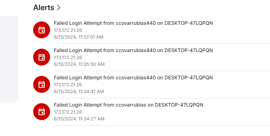

rbjtech 4996 Posted June 13, 2024 Posted June 13, 2024 4 minutes ago, iamjarbear said: Is there a way inside EMBY (logs or somewhere) where I can like see what the reason is for the Faile Login? The fact you have failed login attempts, says the 'connection' is good. But for some reason, the Authentication is failing - wrong password perhaps ? Maybe set a very basic password just to test - but don't forget to put it back when you are done testing.. 1
Happy2Play 9441 Posted June 13, 2024 Posted June 13, 2024 Login failure provide you server is WAN accessible. Now figuring out why username/password is broke is another story. As I get your login page just like rbjtech posted. I know there is a loopback issue on these garbage spectrum router as you cannot connect to WAN address inside your network. Have not looked through the settings though.
iamjarbear 5 Posted June 13, 2024 Author Posted June 13, 2024 (edited) 6 minutes ago, rbjtech said: The fact you have failed login attempts, says the 'connection' is good. But for some reason, the Authentication is failing - wrong password perhaps ? Maybe set a very basic password just to test - but don't forget to put it back when you are done testing.. 5 minutes ago, Happy2Play said: Login failure provide you server is WAN accessible. Now figuring out why username/password is broke is another story. As I get your login page just like rbjtech posted. I know there is a loopback issue on these garbage spectrum router as you cannot connect to WAN address inside your network. Have not looked through the settings though. I think I got it figured out. Its not Invalid passwords or antyhing. Looking into the User Settings all the EMAILS for each user under Emby Connect were cleared out and now theres nothing. So its like their logins are there but not there. Im going to attempt readding those emails so they can try signing into the app again. It does work by plugging directly into it like you guys are seeing on the web. *Edit - not all user accounts were reset only 3 of the 8 users. The 3 users that have been attempting. Weird, but after relinking the email it allows for the connection again it appears. Edited June 13, 2024 by iamjarbear 1
