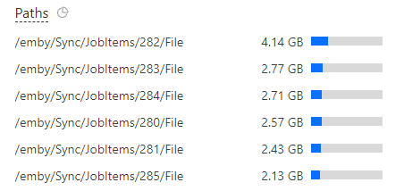

HorsePDF 11 Posted July 14, 2024 Author Posted July 14, 2024 (edited) Coming back to this post I had a realization, I was away recently and downloaded converted media to my phone over the internet. I had not considered this, so there is another rule you would need to get downloads going through this mechanism, probably something under /emby/Sync/JobItems/# From my CloudFlare Dashboard: Edited July 14, 2024 by HorsePDF

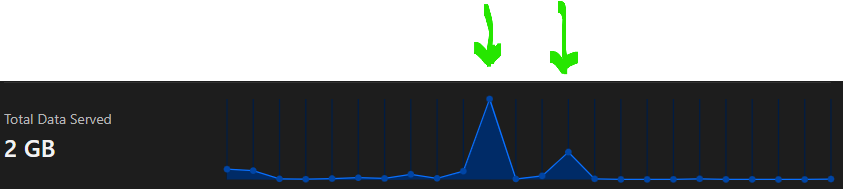

vaise 331 Posted July 26, 2024 Posted July 26, 2024 On 14/07/2024 at 23:22, HorsePDF said: Coming back to this post I had a realization, I was away recently and downloaded converted media to my phone over the internet. I had not considered this, so there is another rule you would need to get downloads going through this mechanism, probably something under /emby/Sync/JobItems/# From my CloudFlare Dashboard: Hi @HorsePDF- I was wondering what these random 'jumps' were on the CF usage I was seeing. I suspected it was my sone doing downloads to his iphone as he lives away now. Can I ask how you got that list in the CF dashboard ? I thought the free plan did not give me such insight.
vaise 331 Posted July 26, 2024 Posted July 26, 2024 (edited) On 14/07/2024 at 23:22, HorsePDF said: Coming back to this post I had a realization, I was away recently and downloaded converted media to my phone over the internet. I had not considered this, so there is another rule you would need to get downloads going through this mechanism, probably something under /emby/Sync/JobItems/# From my CloudFlare Dashboard: Hi @HorsePDF, in addition to my question on where you found this list on cloudflare dash, I implemented anyway with a CF redirect on /emby/Sync/JobItems/ and the corresponding nginx listen on /emby/sync/jobitems/ - but the downloads never start - they are stuck at ready to transfer (I have unticked for only wifi). Further to this, I tried just /emby/Sync and that was even worse - as it breaks the download button on the iphone - it does nothing. I will keep working on this, but I look forward to your response. May have something to do with this in the log that happens after clicking download : 2024-07-26 14:52:42.430 Warn Server: AUTH-ERROR: 120.22.125.234 - Access token is invalid or expired. 2024-07-26 14:52:42.430 Error Server: Access token is invalid or expired. Edited July 26, 2024 by vaise
HorsePDF 11 Posted July 26, 2024 Author Posted July 26, 2024 @vaisethe dashboard I showed is part of the paid plan I think. I bought it for this dashboard plus a few other things like better WAF features. I'll try have a look at it soon. It may be more complicated, the streaming seems to be pretty stateless so it's easy to redirect. If the download jobs are using a sync framework, it may be much harder. One thing to note, Cloudflare may care less about you downloading vs streaming, I don't know. There may not be a difference fundamentally for them, but they may target streaming users because that's not what they want to be hosting. Not sure on that
vaise 331 Posted July 28, 2024 Posted July 28, 2024 @HorsePDF- only free plan for me. unfortunate. I would love to know what these bumps are : I have disabled downloads for all users, so thats not it. So strange - a few megas an hour, then 977MB at 7PM last night, then 334MB at 10PM. Trawled emby logs but nothing I can see. I am thinking there is something other that /emby/video going on here and still going through CF.
