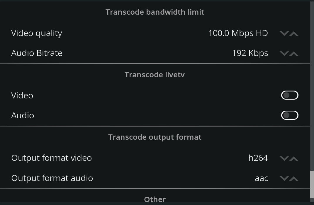

quickmic 1610 Posted May 18, 2024 Posted May 18, 2024 10 hours ago, jaybird2203 said: Issue still present on 4.8.7 - web can playback from the new backend but client cannot Did you try enable transcoding for live tv in the plugin config options? I see in your logs, the webclient requests hls streams (master.m3u8) while the plugin queries the native stream (static=true)
jaybird2203 20 Posted May 19, 2024 Author Posted May 19, 2024 Just opened to check the plugin settings and noticed the plugin updated to 10.0.23 so can't say what the exact settings were prior - playback I usually leave as default though. See below as they're set currently. I'll see about getting new logs though - hopefully in the next few hours.
jaybird2203 20 Posted May 22, 2024 Author Posted May 22, 2024 (edited) @quickmicTranscoding solely video allows Kodi to playback. Is there any idea why the stream needs to be transcoded in the first place? New backend direct to kodi plays without issue, so same initial stream that Emby would request. Only when going through Emby does it immediately crash unless the plug-in enables transcoding so seems a bit off. Edited May 22, 2024 by jaybird2203
