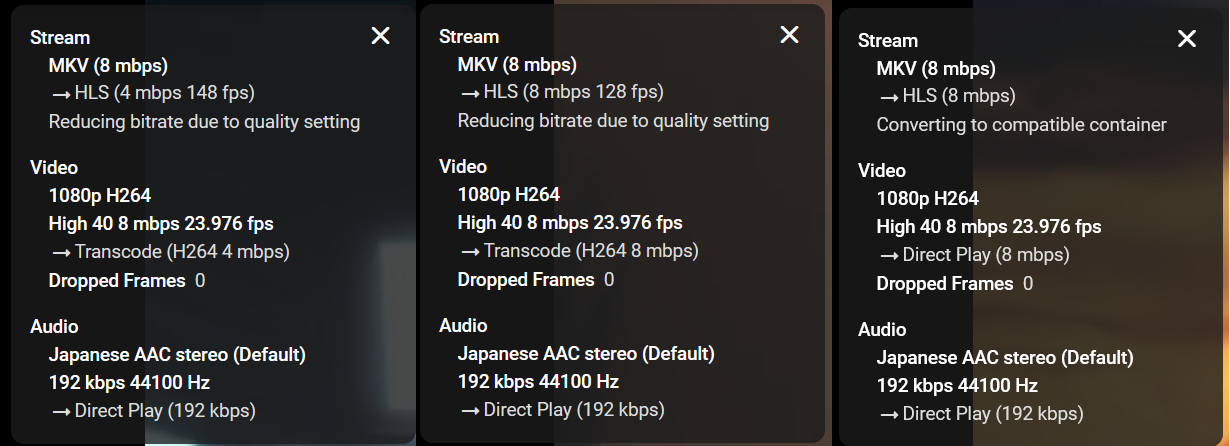

My current problem is videos buffer a lot, even in lower qualities. I have a ~150 Mbps connection (WiFi. LAN is 800 Mbps but the problem was the same). I connected to my emby server through the phone app and it's playing the videofiles in crisp quality, no stuttering, no loading, while my Windows PC takes a while to play even in 720p 4 mpbs (tried mozilla, edge, chrome and emby theater). When I choose Auto quality it usually goes down to 720p 4 mbps and it plays *mostly* with no buffering, but sometimes it gets so bad I can't watch an episode.
Stats for Nerds when choosing 1080p 4 - 8 - 10 Mbps. All three of them buffered and wouldn't play continuously:
